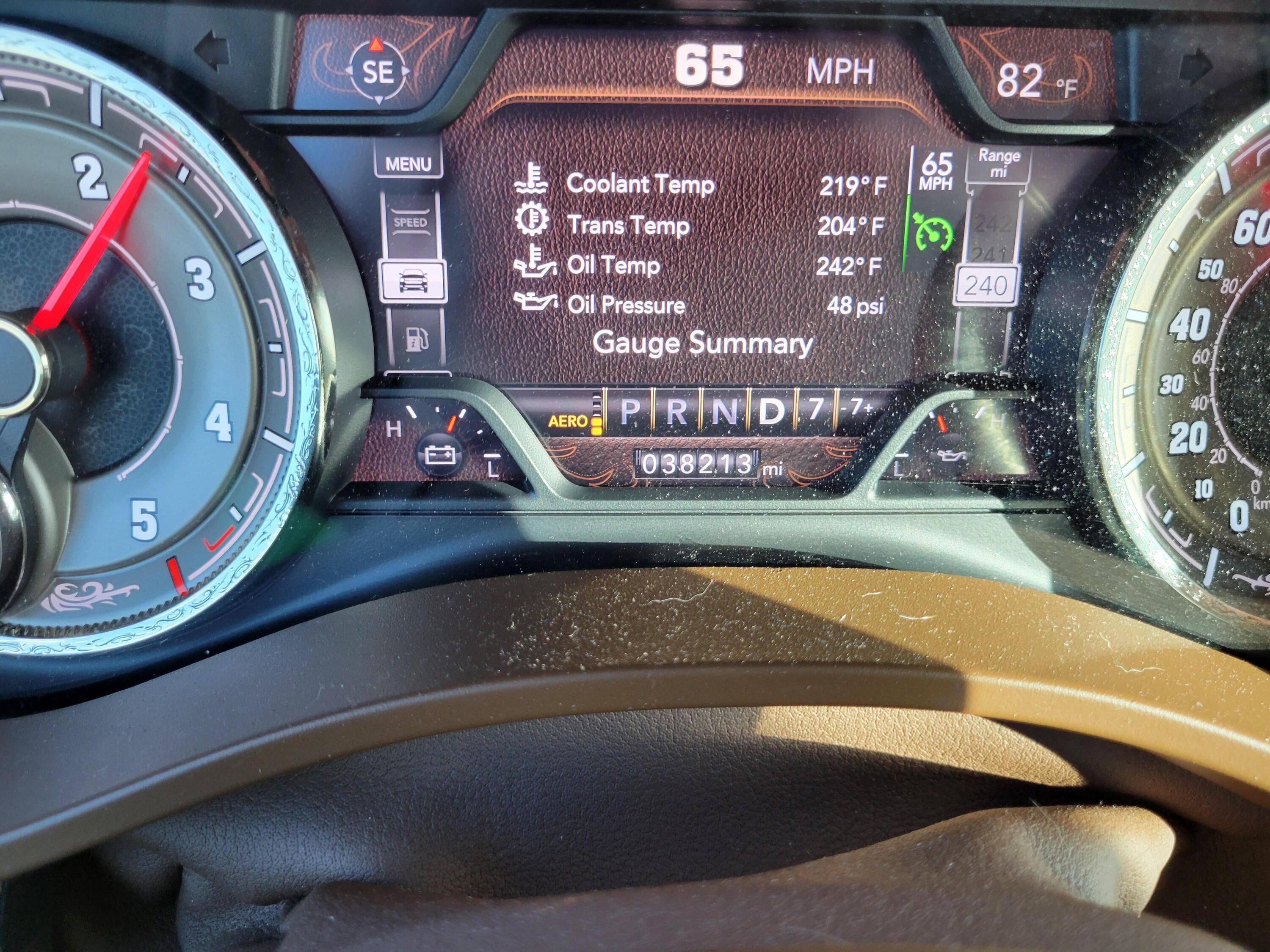

The oil temps in the Gladiator EcoDiesel run pretty hot. When I was driving through the mountains, I saw 248*F in the Gladiator without towing. For reference, I towed over 500 miles last week in my 2020 Ram EcoDiesel. In mountainous terrain, the hottest oil temp I saw was 242*F pulling an estimated 7,600 lbs. in cruise control.
The truck was actually towing in 4th and 5th on the steep grade, but the highest oil temp was at the very top of the mountain where it shifted back into 7th, which is when I took the photo.

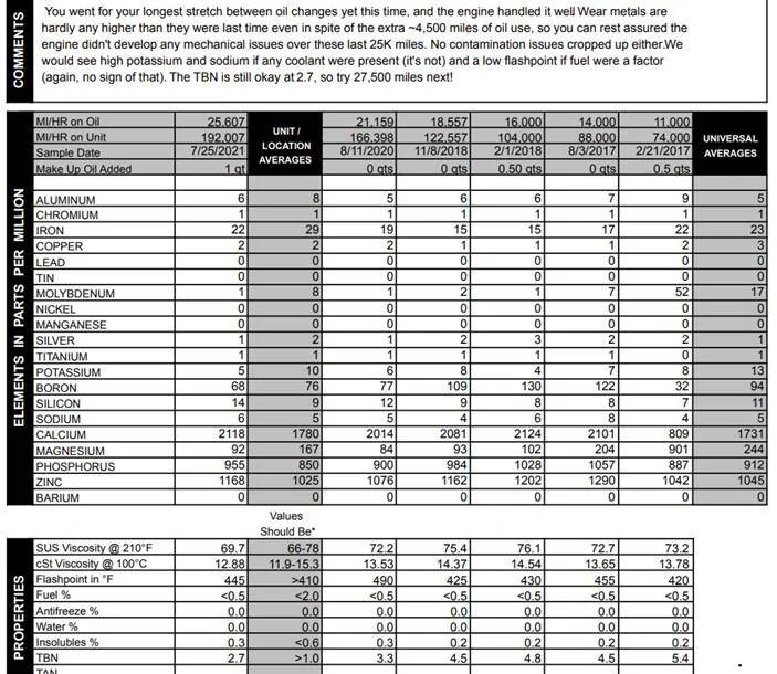

Well, I better start backing some of my posts with 'facts' or I might get called out for being a liar again, lol.
Here's the latest update I received this morning.
That's just awesome! So much hate and misinformation left over from the 1st gen failures?

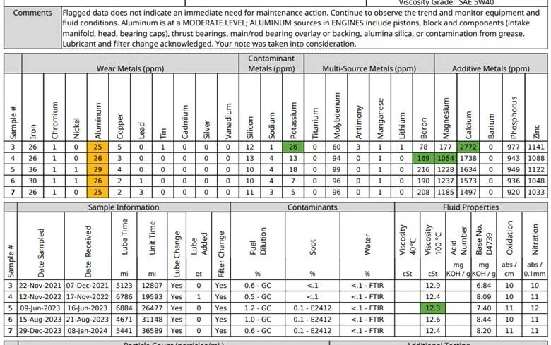

I run Pennzoil Platinum so that's good to hear! I change it at about 7,500km / 5,000 miles.
5,000-mile intervals are probably a good idea. Here are my UOA reports with Pennzoil Platinum. The spec for 5W-40 is between 12.5 - 16.3 cSt. As you can see in my reports, the oil has sheared down to the 5W-30 range.
Super helpful information, thanks!

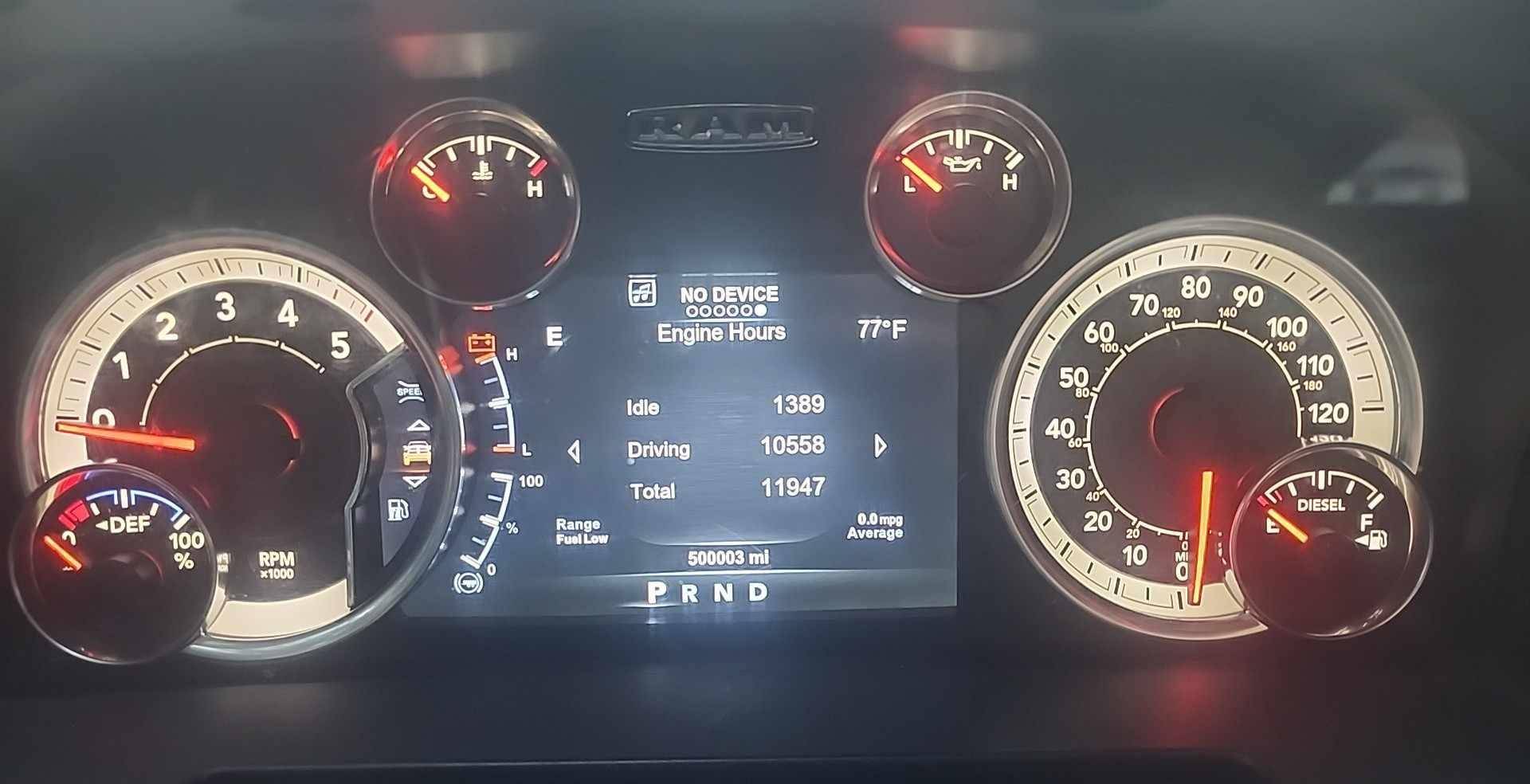

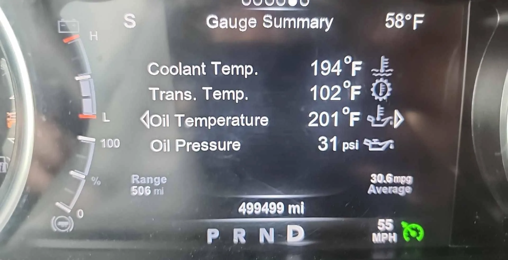

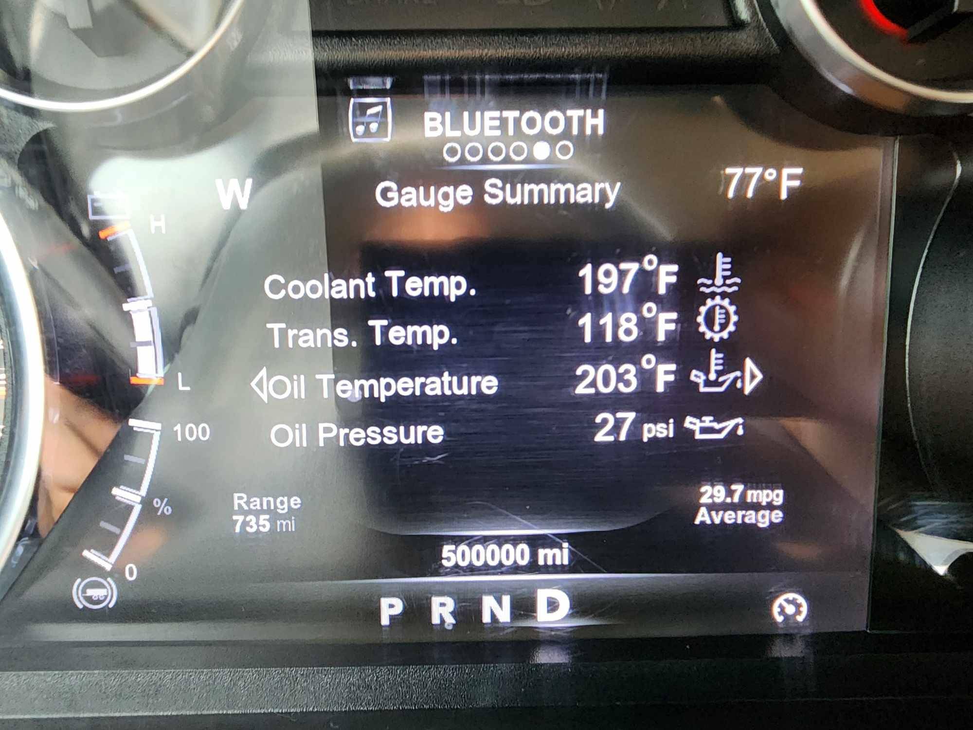

As a matter of fact, one of our Amsoil guys will be turning 500,000 miles this week on his 2nd gen EcoDiesel.
Here's a follow-up. He turned 500,000 miles today.
