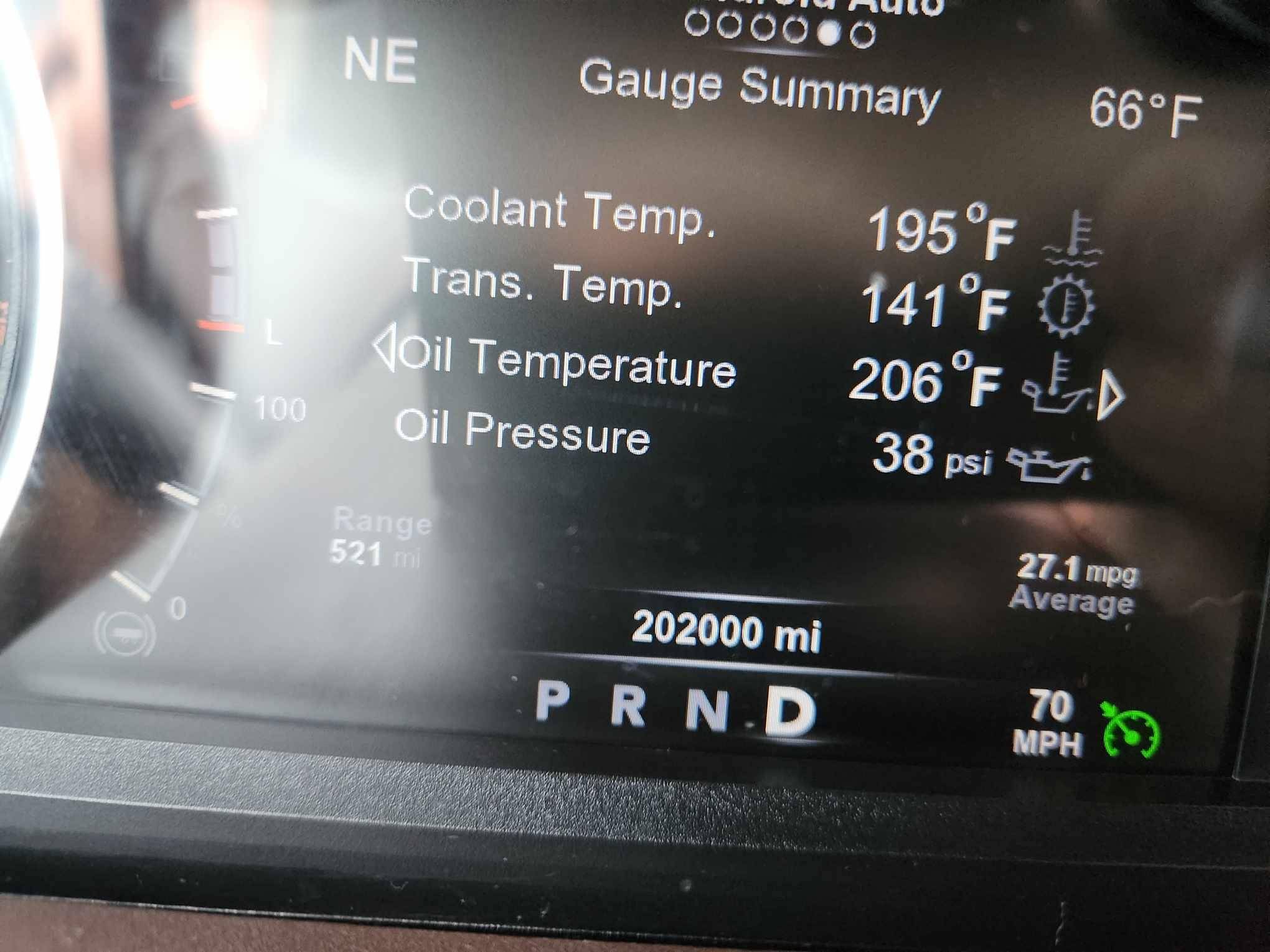

It's not a hotshot truck per se, but he works for a company that hauls paint supplies throughout a multi-state region. He has three EcoDiesel trucks. His first truck got totaled right around 405,000 miles. His second truck now has 500,000 miles. His third truck just turned 202,000 today.
