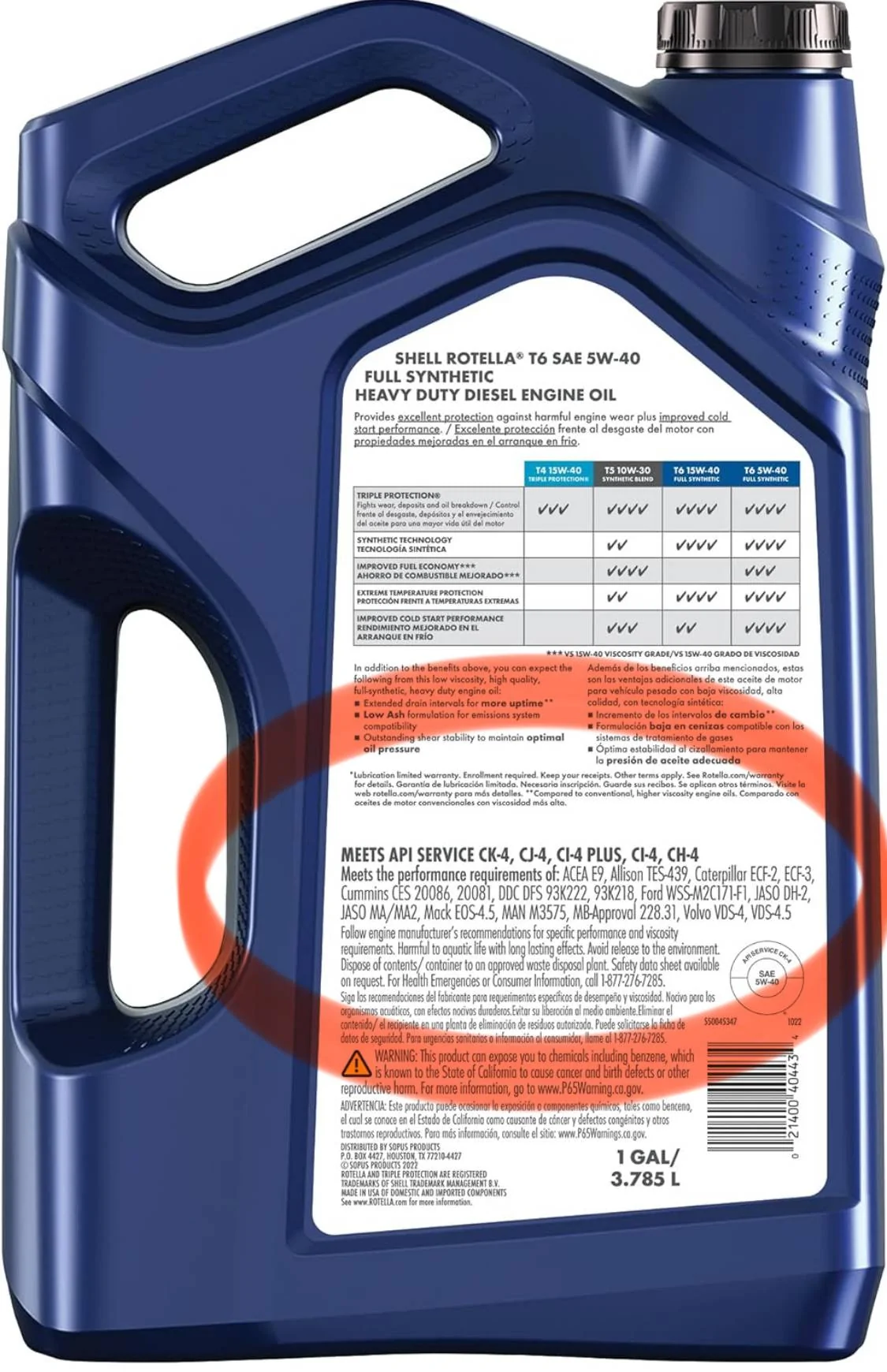

diesel i imagine can run a bit longer. and i would too seeing the cost of Rotella T6. that shit is liquid gold. i always buy it when i see it for my buddy with his 7.3 bronco.
Rotella T6 does not meet the oil spec.
Cheapest spec oil I have found is Quaker state euro, usually around $5 a quart which is way better than the pennzoil euro around $8 a quart.
though, someone posted the autozone deal for $5.60? A quart end of last year….. have 3-4 changes sitting on the shelf.
Diesel spec is MS-12991 ??
T6 label-
