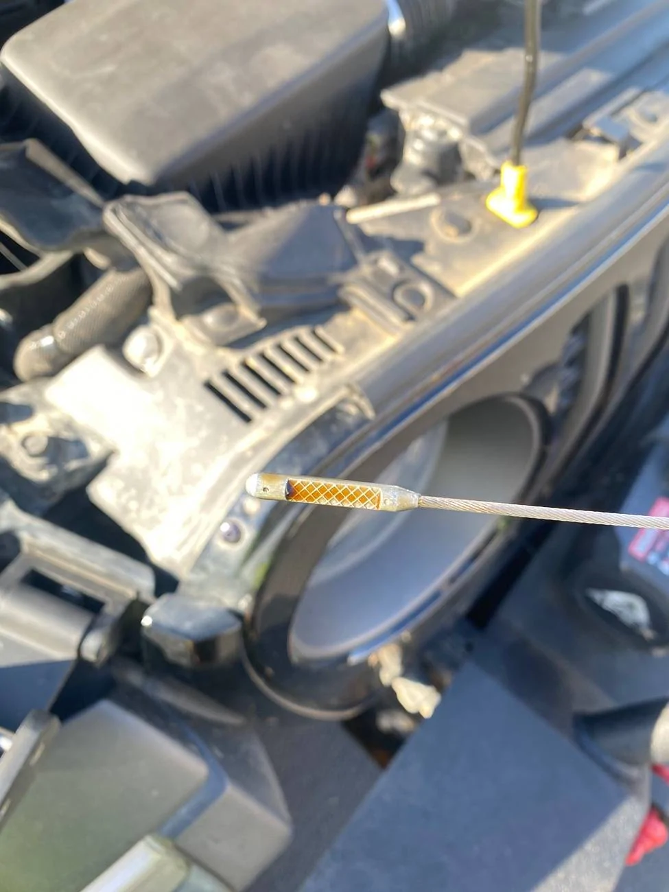

We and the OP really have no idea how much oil was in there. 7 quarts? I strongly doubt they'd put 7 quarts of new oil in if it's a warranty thing. They'd lose money, and they can't claim 7 quarts on the "paperwork". They get paid for 5. If the dispenser is off that darned much - says 5 quarts but puts out 7, think of the money lost on every 55 gallon drum.
I've yet to see anyone brag about the accuracy of their 3.6 dipstick. I've not seen every single one and not every member posts their dipstick accuracy, but so far, what I've witnessed says they are more of a go/no-go gauge. Most read above that casting on the end when full.
Ideally, you let these sit a lot longer than 30 minutes if you want REAL accuracy, but 30 minutes will get you close enough to know if it's low enough to add or not.
Why longer?
Because 5 quarts is assumed with the oil filter dry, and the oil filter housing empty.
When you remove the cap and release the pressure on the filter, the remaining oil in the filter housing drains down to the sump (not fast, but it'll get there)
So the only real way to know exactly how your dipstick reads with the correct oil put in is to drain it all, change the filter - and for me, I check the oil level engine cold, in the morning before it's even started. Since I won't be driving mine today, I'll probably wait until this afternoon since I drove it yesterday afternoon.
Mine absolutely does read above that casting, onto the "wire", when the correct amount is put in.
No oil on the stick isn't necessarily low enough to cause a light to come on. Depending on your driving at the time, speed, curves/corners, braking and so on, there's likely still enough oil for the pump to create the volume needed for the oil pressure to be acceptable. Nothing on the stick doesn't mean empty - but is a red flag.
Assuming a perfectly accurate dipstick where those hashmarks indicate full/1 quart low, in a perfect world, full/5 quarts is the very top edge of the hash marks, 1 quart low is the bottom of the hash marks, that means that the dipstick has a range of around 1.5 to 2 quarts, tops. That means there's still 3 to 3.5 quarts in it. And if it was checked shortly after the drive, some of the oil is still up in the galleries, tops of the heads, oil filter housing and so on. So, no, not on the stick is very unlikely to trigger a low oil light.
As far as "over-filled", because these aren't a straight-up container where every inch rise in fluid level is exactly 1 quart, you can't know there was 7 quarts - that's a guess. The sump and crankcase itself is an odd shape for sure. If you measured how much you drained out, then you can get a close estimate, but you can't tell from the stick. Only by draining and measuring can you know what was in it - ideally pulling the filter to let the filter and filter housing drain, waiting a few minutes, then pulling the oil drain plug, and measuring.
You drained down to below full for sure - how low was it as far as quantity when you drained then used the dipstick, no way to know for sure because those dipsticks aren't calibrated.

Never been an issue with either of my Gladiators. The stick always shows full when I check it.
The only time I added oil, it probably didn't need any. It was after a drive from Las Vegas to Albuquerque where I pushed it hard the whole way. The back end was sitting high in the hotel parking lot and the stick showed about a third or a quarter down. I was in a hurry, so instead of doing it right, I just added a quart and headed out.

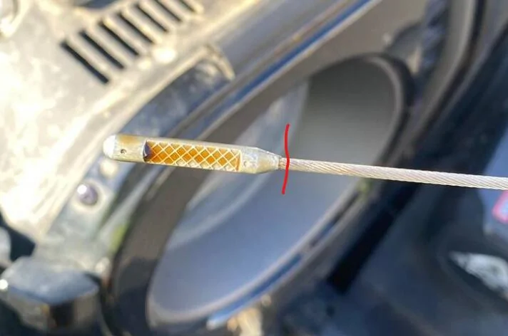

The correct amount of oil, 5 quarts, may well read above the casting on the wire and up onto the wire just a little bit. Mine, with exactly 5 quarts, reads onto the cable/wire part of the stick. It did with my 2020 as well as the 2022.
If you drained it down to 3/4 way up on the hash marks, you already had it down a half quart - even more!
A bit over, even 6 quarts, won't harm these engines. Not that I recommend it, but it's not an emergency with 6.
Mine will read about like this with the proper 5 quarts - at times it reads a bit higher than that, and has never had more than 5 quarts in it.

Referencing the picture above - I checked mine today - it's about 48 degrees, the truck has been sitting since 3:00pm yesterday (it's about 3:30 pm today) and the oil has over 3,000 miles on it - still up to roughly where the red line is in the picture above. It's not dropped down onto the other part of the "stick" yet.
