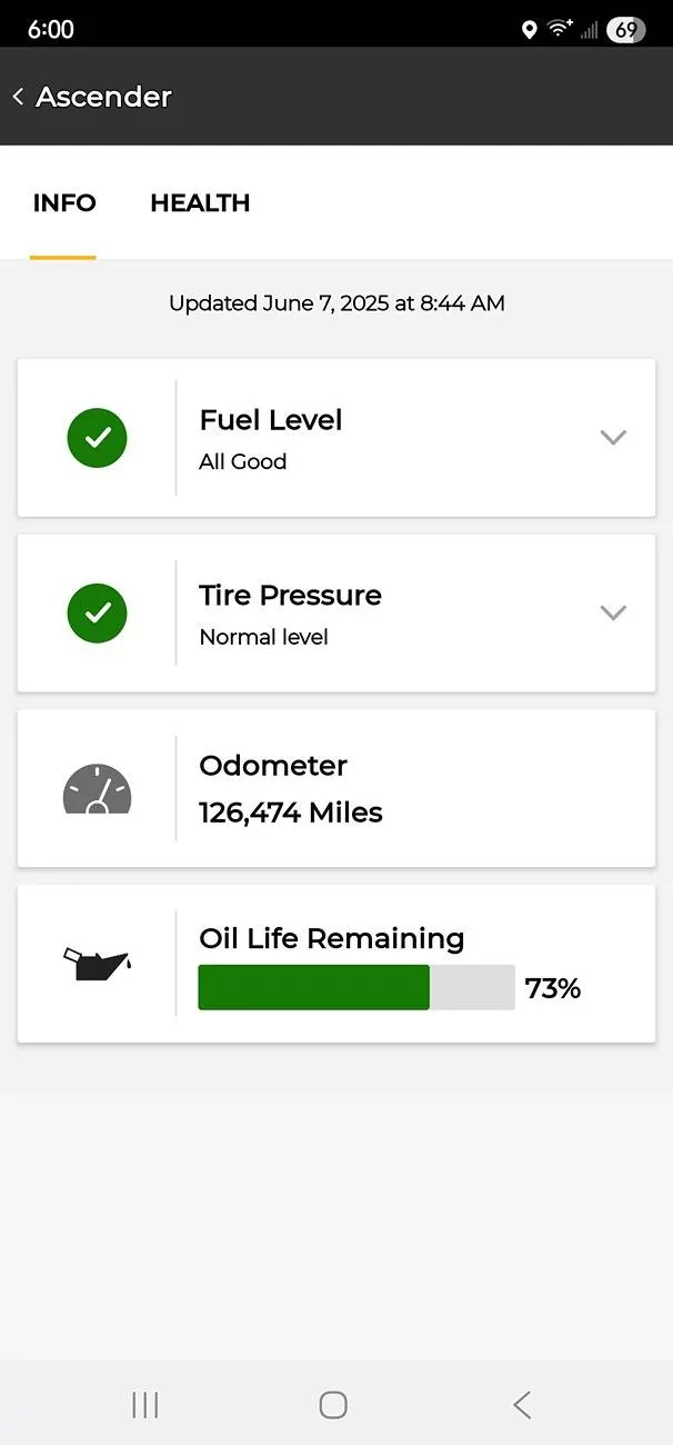

One reason I like Mobil 1 is that Mobil 1 uses Group IV PAO base oils like AMSOIL Signature.
Except the oil that was in it from the Dealership when I bought it . Every single oil change on my JT has been Amsoil signature series 0W-20 . 126,400+
