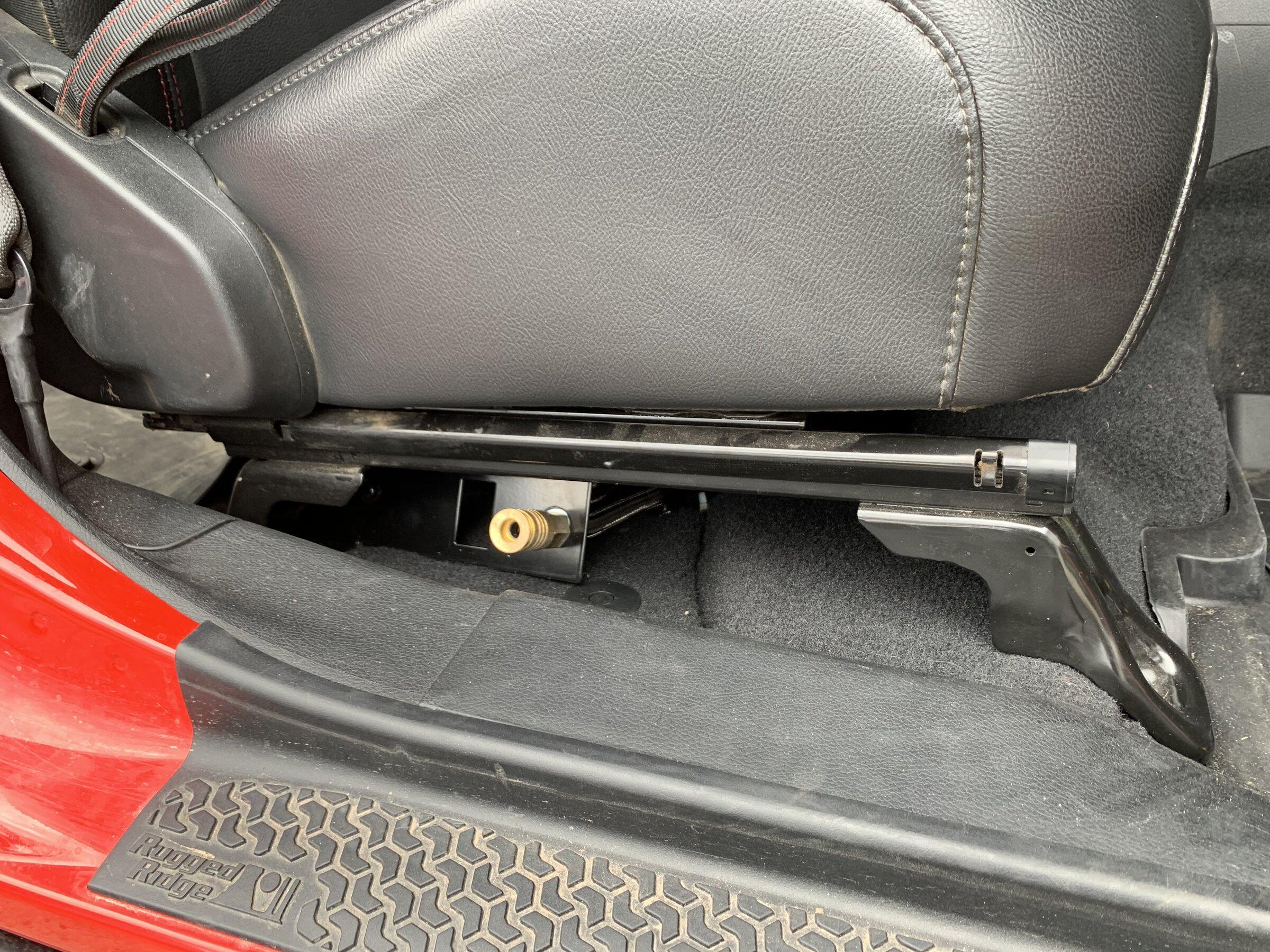

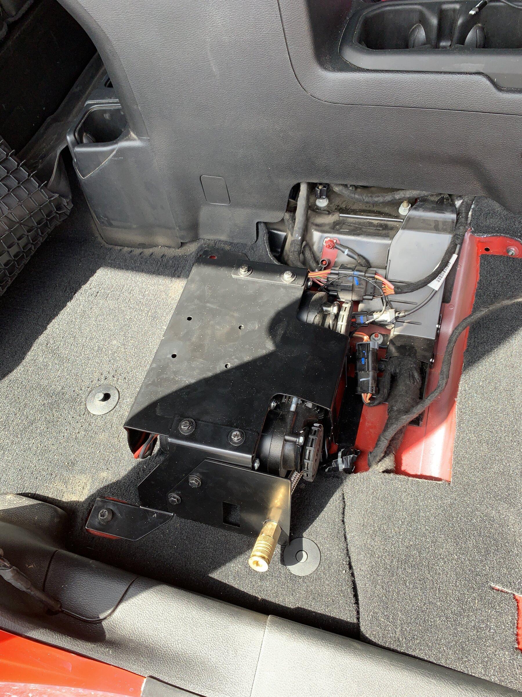

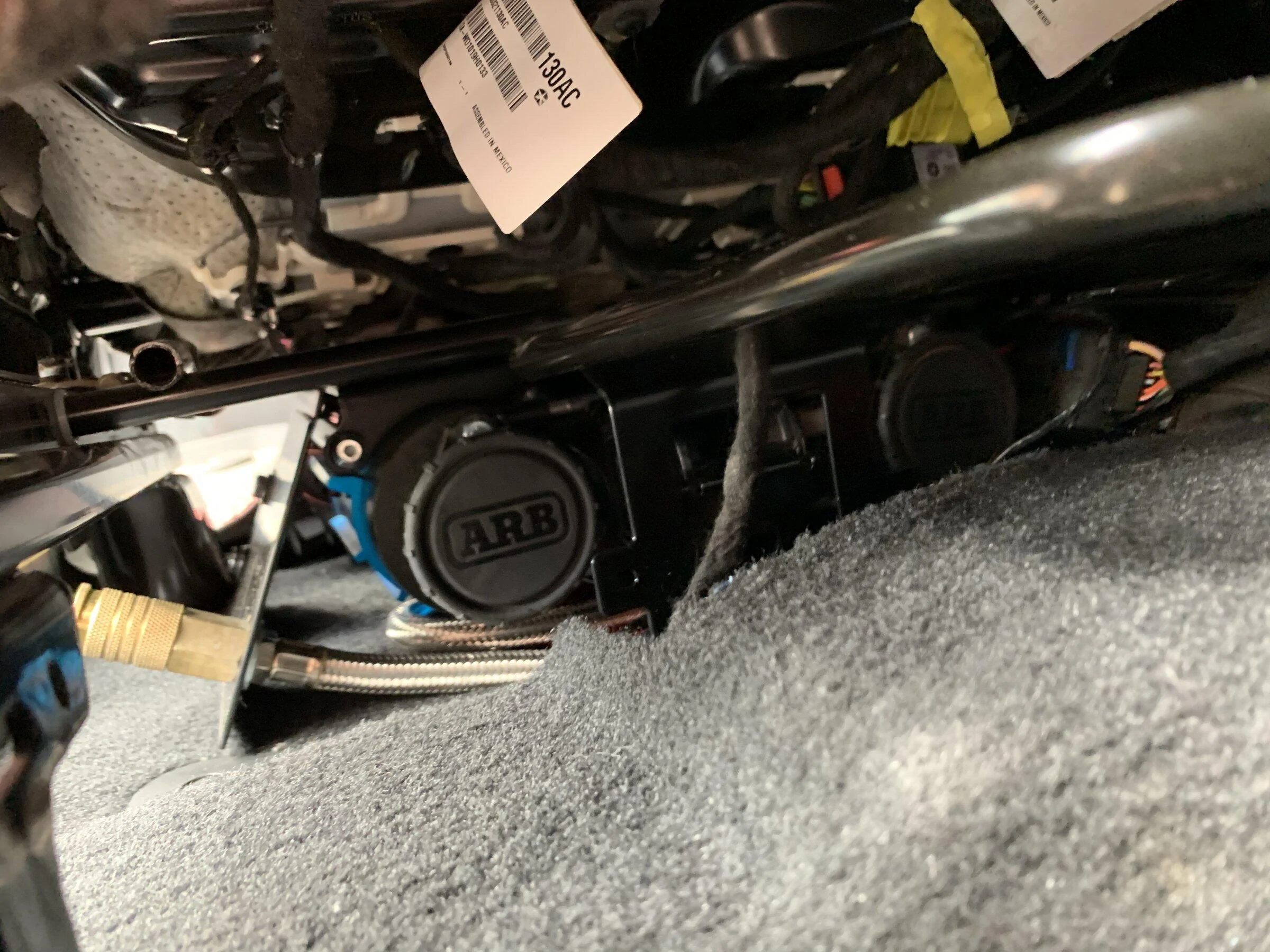

I have the arb twin under my passenger seat with an arb bracket. Works great.
As for airing down, just got the apex rpv valves… 32-12 psi in 30 seconds per wheel…. Yeah boy!

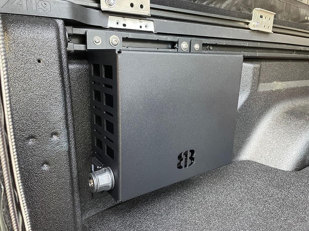

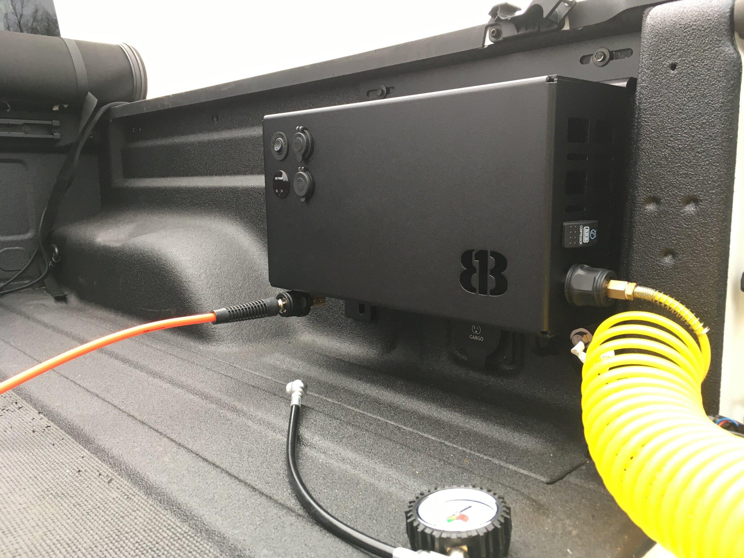

For our mounts, we have two ARB Enclosures. If you want to do all 4 tires at once from a wheel well setup, you will want the ARB twin. For filling tires, you really don't need a tank. In fact, there is a YouTube video that I watched from Australia where some guys did a test to see if having the tank helped fill the tires faster and they said there was no difference. He said he was going to remove the tank and use the space for other stuff.
Our larger enclosure mounts with or without bed rails and also has space for electronics if needed.
https://www.813fabrication.com/prod...-enclosure-for-arb-single-or-twin-compressors
Our Medium size enclosure is rail mount only (though it is possible to mount it on any flat surface using Rivnuts)
https://www.813fabrication.com/product-page/arb-twin-compressor-mount-for-jeep-gladiator
