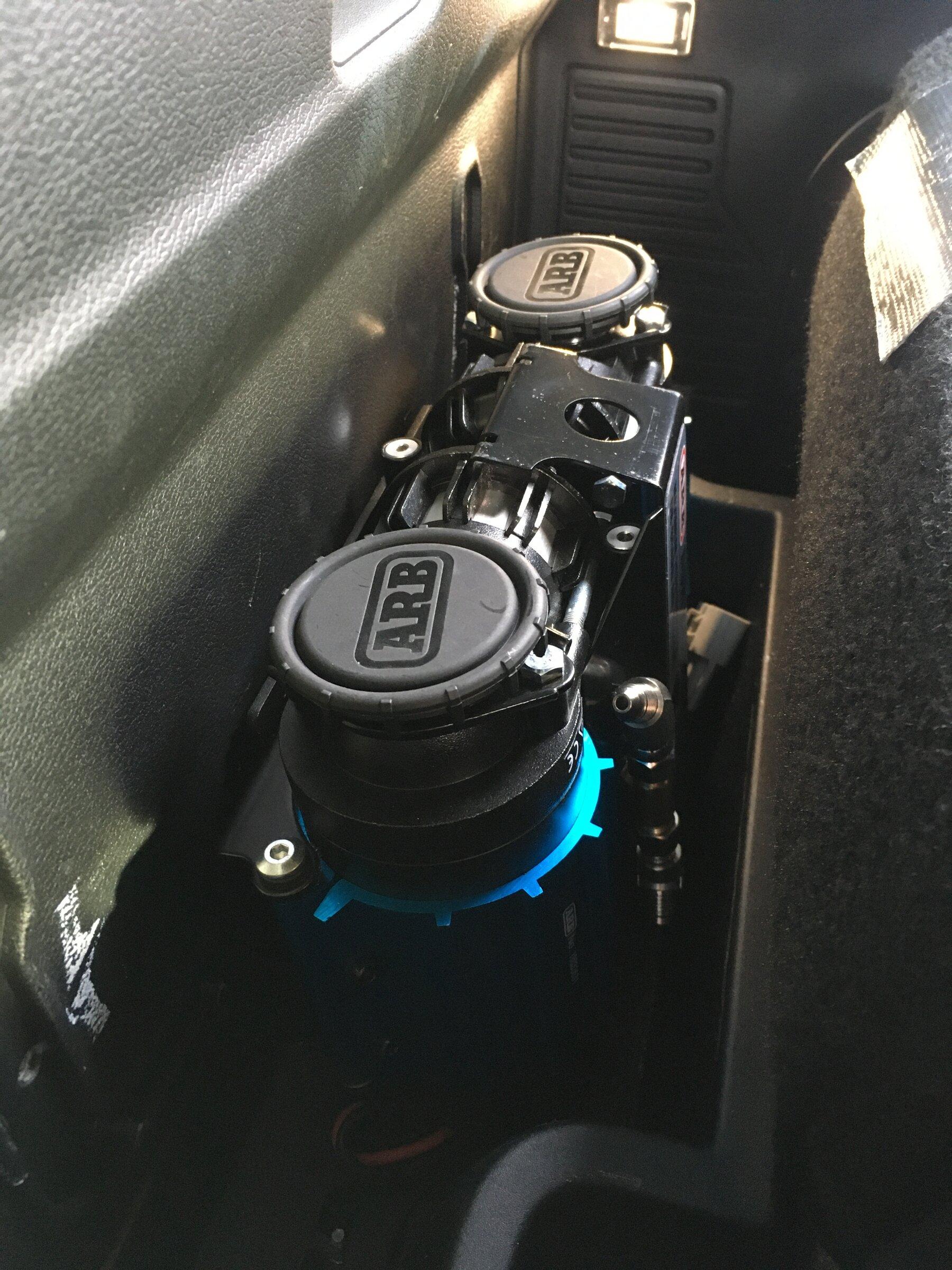

I have the up down air setup under the hood, compressor inside the cab, may move the up down air setup in the cab as well it runs chucks to all four wheels and you centrally set tire pressure up or down

Any problems from heat with it running for a length of time?
when I use it, I put the a/c on and turn it allthe way cold With only the heat ducts in
 blows cold air on it.
Never had an issue with heat while underneath the seat. The bracket covers the top so it doesn’t heat soak the seat.
I used to have my twin under the hood by the cats
 it got heat soaked badly but never turned off.

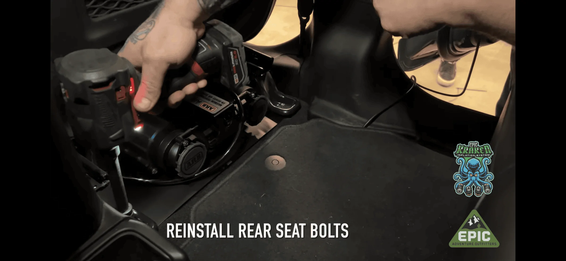

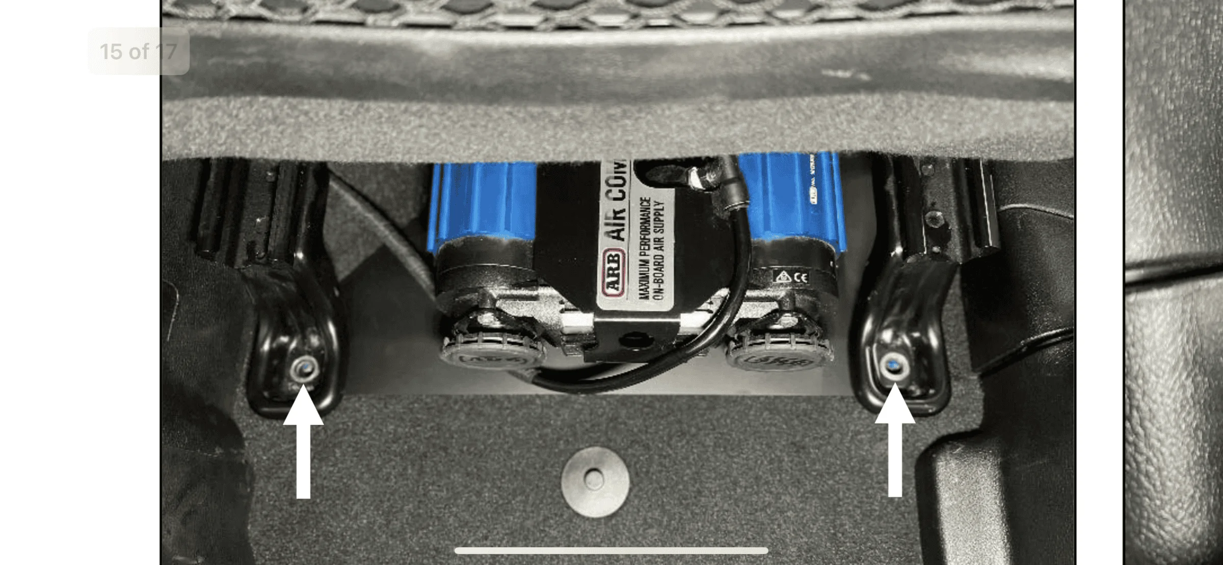

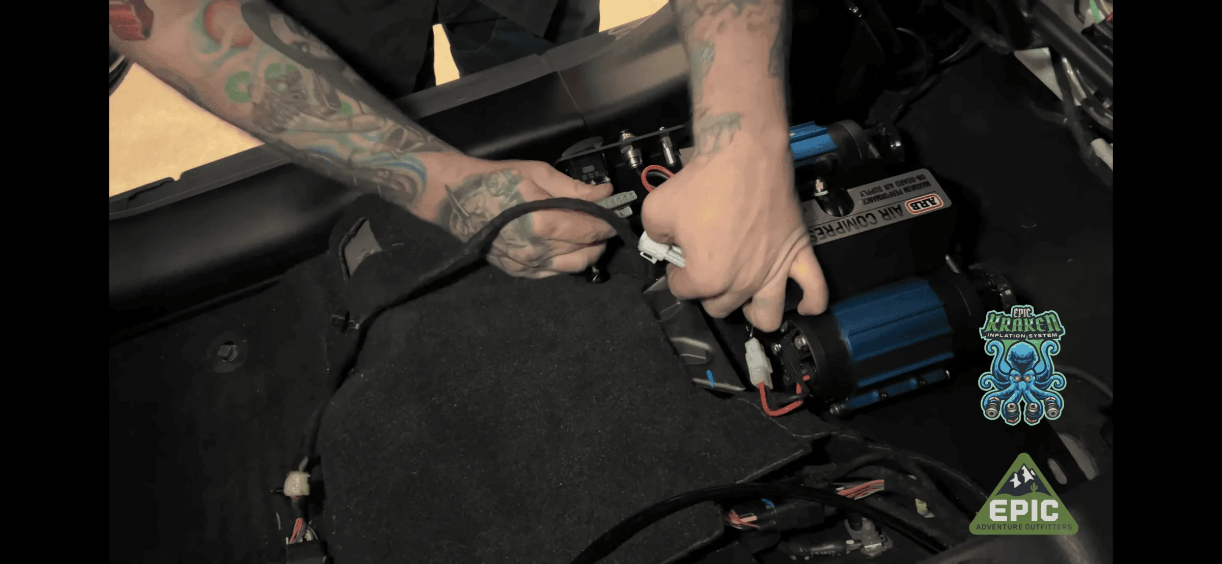

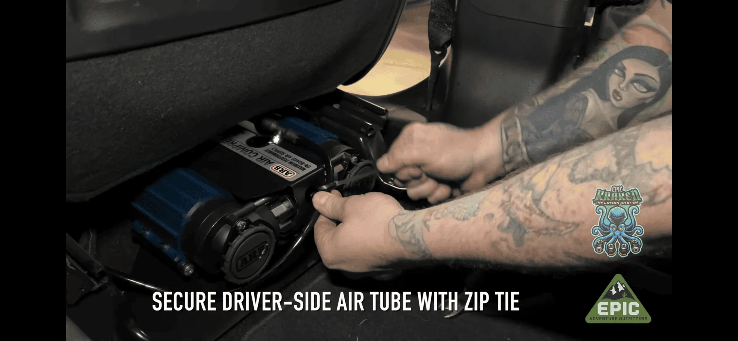

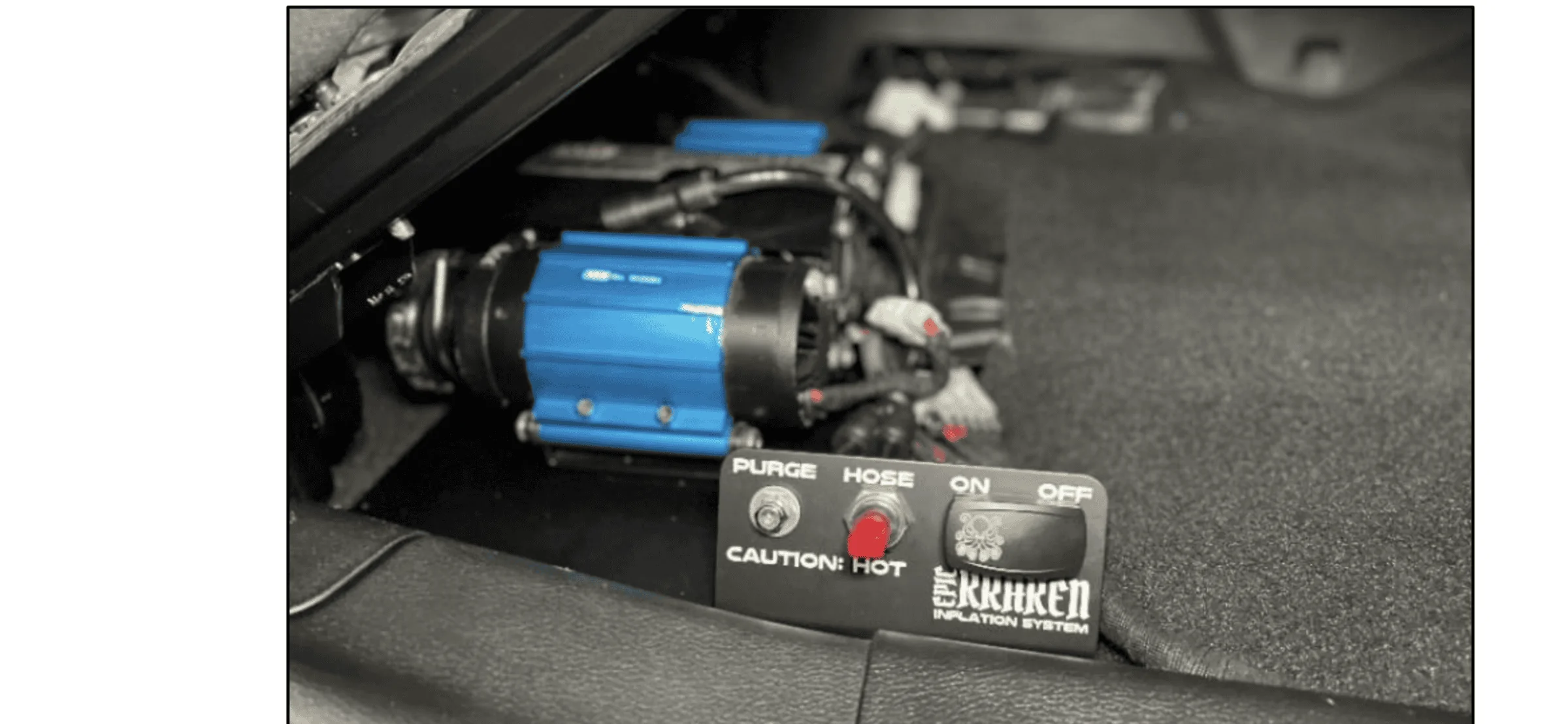

I received an email from EPIC indicating they were taking orders for their Kraken system. It won’t be shipping until the week of 5-14 to 5-20
so I got one and it’s been confirmed.
To be honest, I’m not crazy of how their plate mounts the twin ARB (not included) under the seat. Not that I plan on having anyone sit back there but it looks like the air filters hang into the foot space in the back seat. I’m also not thrilled with the minimal shielding it provides on the top. I understand that it requires a T fitting for access ports on both front seats, but I don’t want to melt anything either. My worries may be unfounded, but I’d sure like to figure out a way to mount the compressor behind the rear seat.
One of the photos below does confirm the floor vent does dump right in front of the compressor.

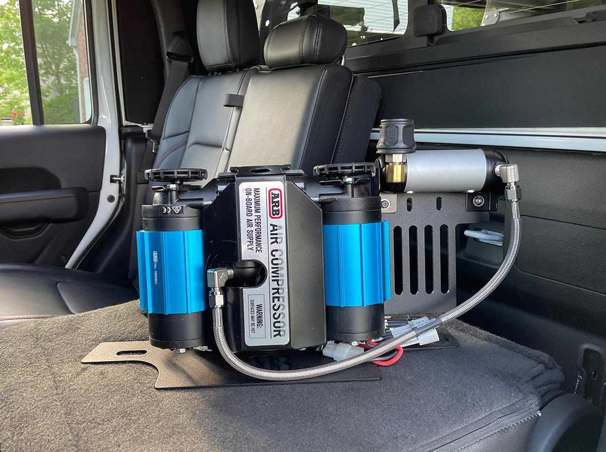

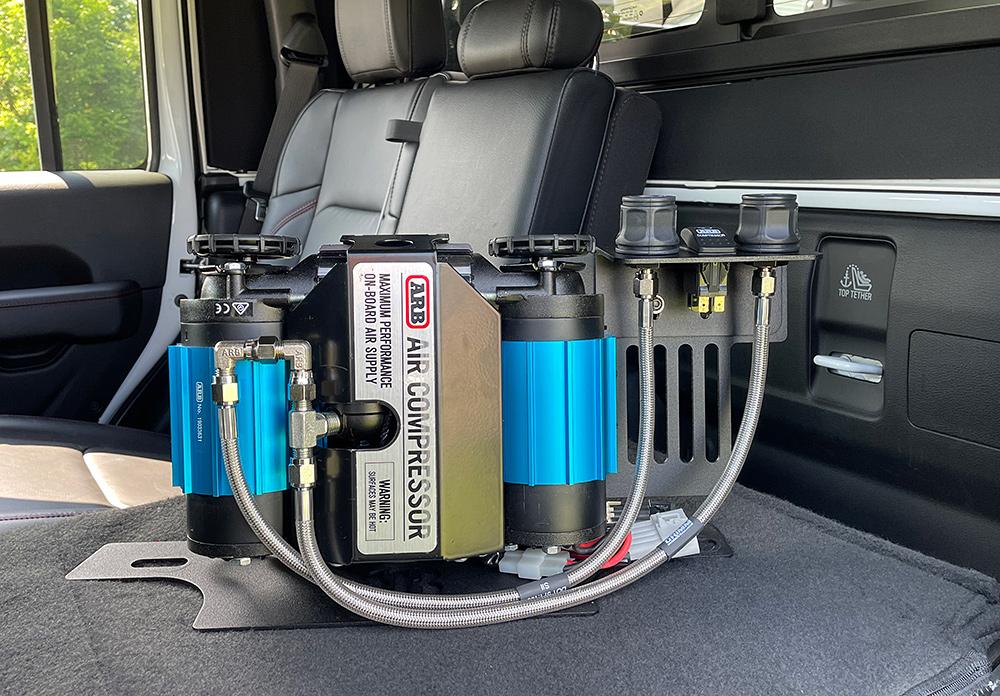

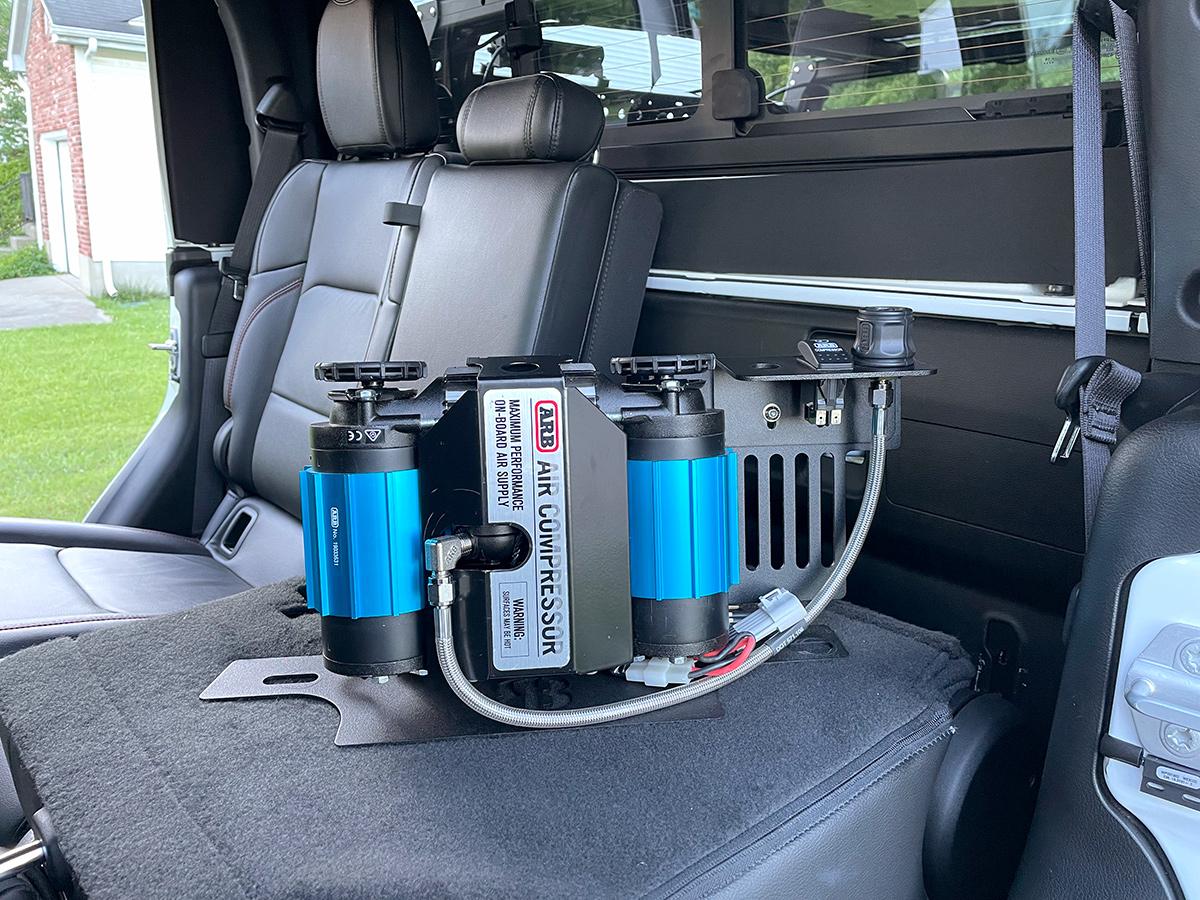

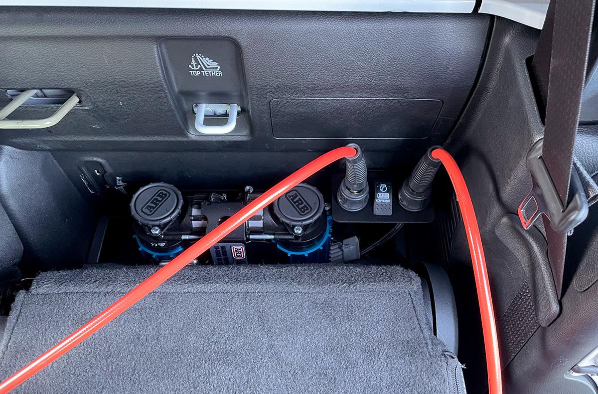

Hey Doug, I have a Behind the Rear Seat mount with options for single or dual air couplers as well as the ARB manifold. Let me know if you have any questions about them.
https://www.813fabrication.com/product-page/arb-twin-single-behind-the-rear-seat-compressor-mount

@813 fabrication design
Have you seen any issues with the double Arb melting the back of the rear seat?
Lol
I couldn’t type fast enough
813 Fabrication & Design
Rock Sponsor (Level 1)
Jeremy
Dec 21, 2019
51
918
1,323
Louisville, KY
No, I have not heard of any. We recommend if you are going to run the compressor long enough to fill tires that you should drop the rear seat so that the heat disperses. I have had several customer also add adhesive heat shield to the back of the seat for extra precaution.
Dougstdig
Doug
Sep 5, 2017
1,603
1,560
FL
‘21 JTRD - '08 Dodge Ram 2500 4x4
Great. I may give you a call. I like the idea of that location plus being able to air all 4 at the same time. A buddy of mine is a custom cabinet builder I think I can talk into building a custom platform and/or sliders at some point so the rear seat may not last long anyway.
