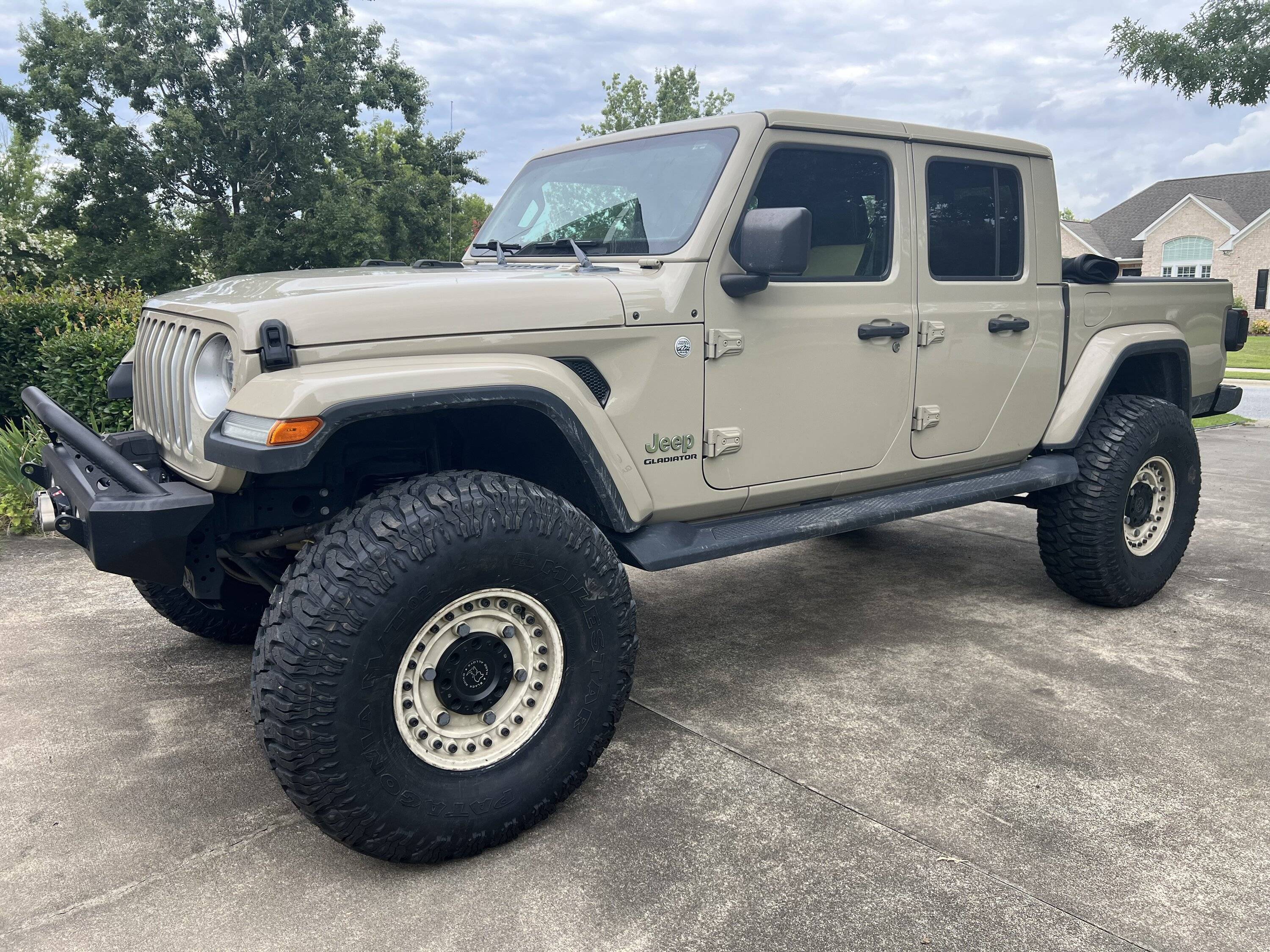

I took the doors off for the first time today and took my son to Home Depot and just cruised a bit.. i don't think I could part ways with the truck at this point lol.
Can I see your truck and maybe some more information on the lift and lockers you went with? Looks like I'm buckling in for the long haul on this.
Jeep Gladiator Overland Package Conundrum IMG_5846
I went with a Metalcloak 4.5" Gamechanger lift and Rubicon take-off axles regeared to 5.13 with factory lockers. The axles are trussed and gusseted, and with my driving style, I don't anticipate major issues.
I have Poison Spyder Rocker Knockers to replace the factory steps, but I haven't put them on yet. I need to replace the fenders to maximize flex, but they're sufficient for now. I'll probably end up selling the Rocker Knockers and adding Metalcloak Overland fenders and rockers.

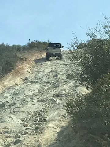

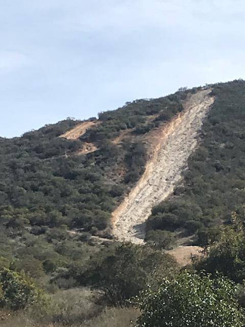

I ran an Overland for 3 years and it went most places. Dont need lockers except in the nastiest of conditions. I did have a 2" Mopar lift and put 4.56 gears in it as it was a dog with the 3.73's.
Jeep Gladiator Overland Package Conundrum Otay Rock garden 1
Jeep Gladiator Overland Package Conundrum Otay Rock garden 3
