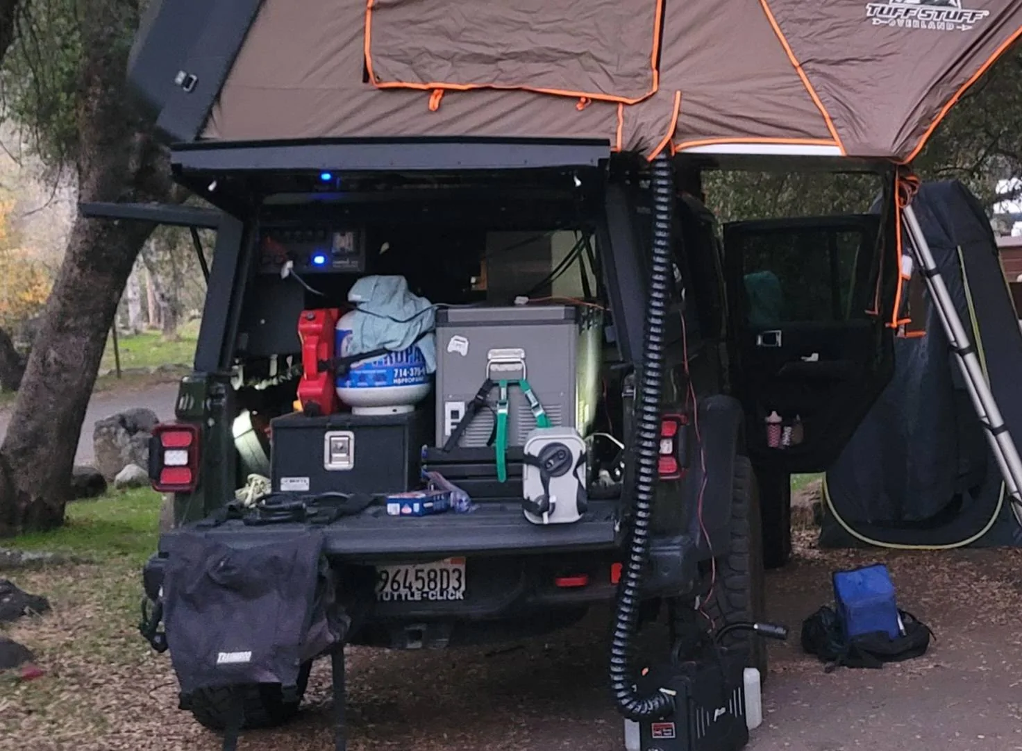

Update of progress:
New twin cyl air pump
I settled on a single-burner Blackstone
Fabed a Diesel heater temporary mount and ran a hose to the tent.
Reconfigured the recovery gear kit.
Redid the toolbox to make it lighter.
Coming down to the final loadout configuration
Pics and story here:

Amazing setup!!! How are you mounting your diesel heater? I thought about mounting mine when I'm stationary using it but haven't come up with a clean setup.

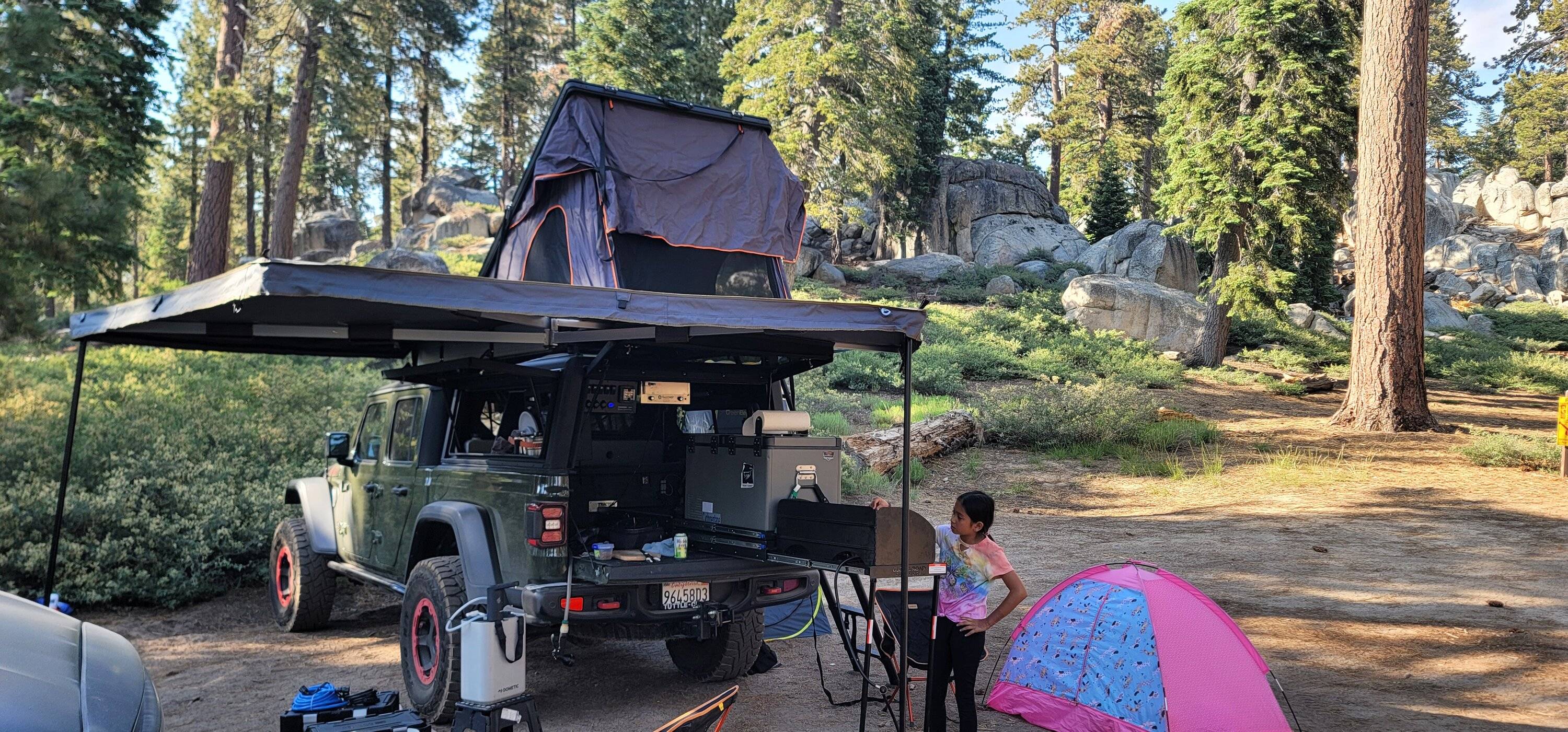

Soun ds like a great trip! I love that area and can't wait to go back. I did lots of that in stock Rubi, and it was slow going for sure... we did it, but thinking of an upgrade!
I am looking at the Clayton and Falcon combo... which set did you do? Overland 3.5? You also said you put on 37s, and am curious if you re-geared? I live here in Colorado, so am torn between 35/37s as doing the regear for 37s is another chunk of change.
Flyin6
Flyin6
Jan 2, 2023
1,332
1,815
Kintuckee
22AEV JT370, 24 Ram 3500, 22 Caddy XT6
Aviator, rotary and fixed wing, Writer
37's and 5.13's. I would say that combo is about perfect. Clayton for the win, no doubt. I use the Clayton 3.5" overland kit with heavier springs. I also run airbags in the rear. I use the Falcon 3.3's and am very close to the Softest setting. I passed a dozen stock rubies if I passed one. Same story each time, they were going Sooooo slow. I found I could double their speed easily. Later I figured out it was the suspension along with the taller sidewall. 17" wheels and a 37" tire @ 18 lbs. is such a nice ride. You might note I am also using the Icon bead lock wheels which takes all the worry out of airing down a bunch more, but frankly, I found nothing that I couldn't just drive over in the San Juan mountains. Now having said that I only did several days wheeling there so there are many trails I have not yet seen that no doubt might challenge the Jeep a bunch more.
