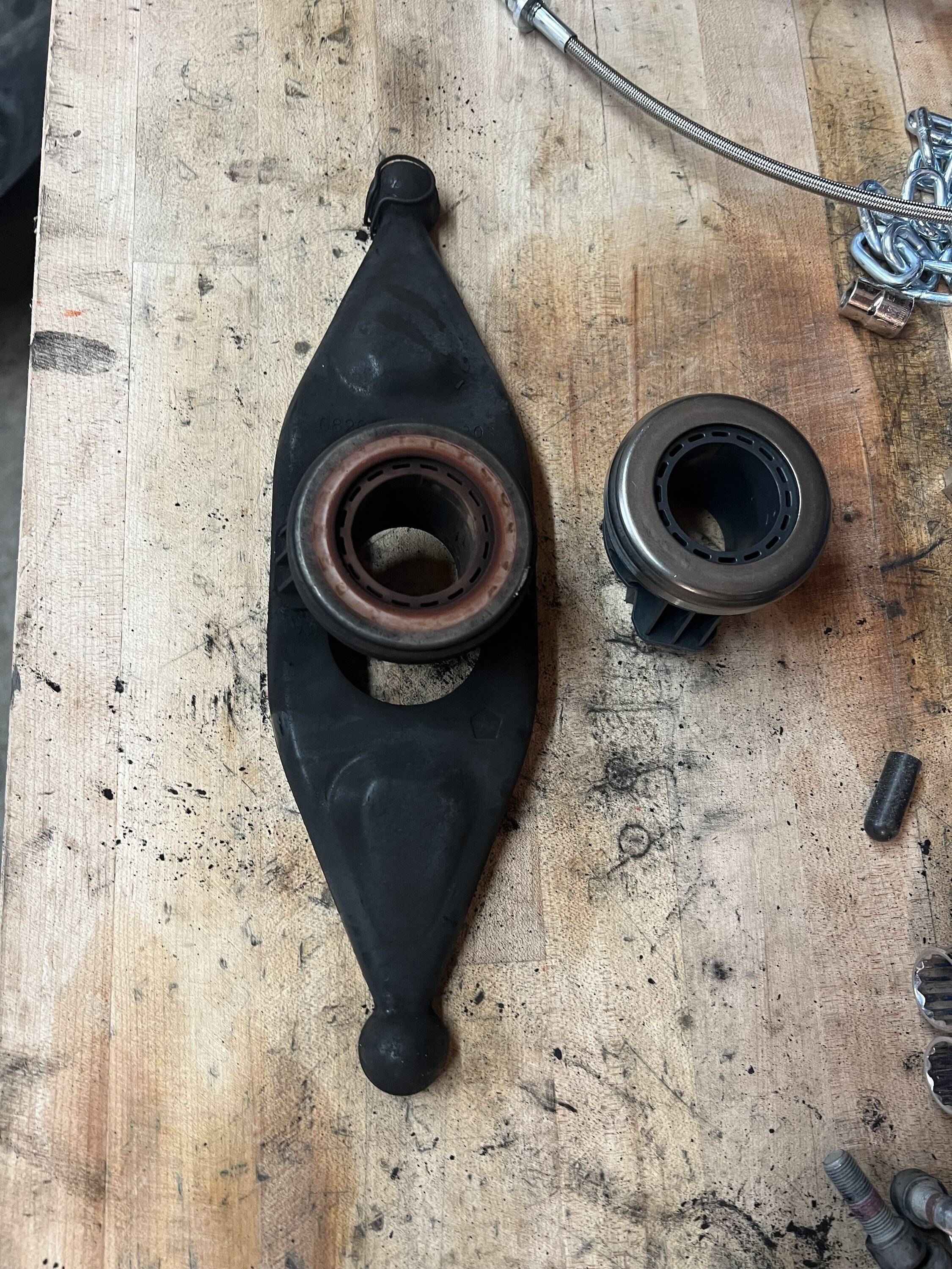

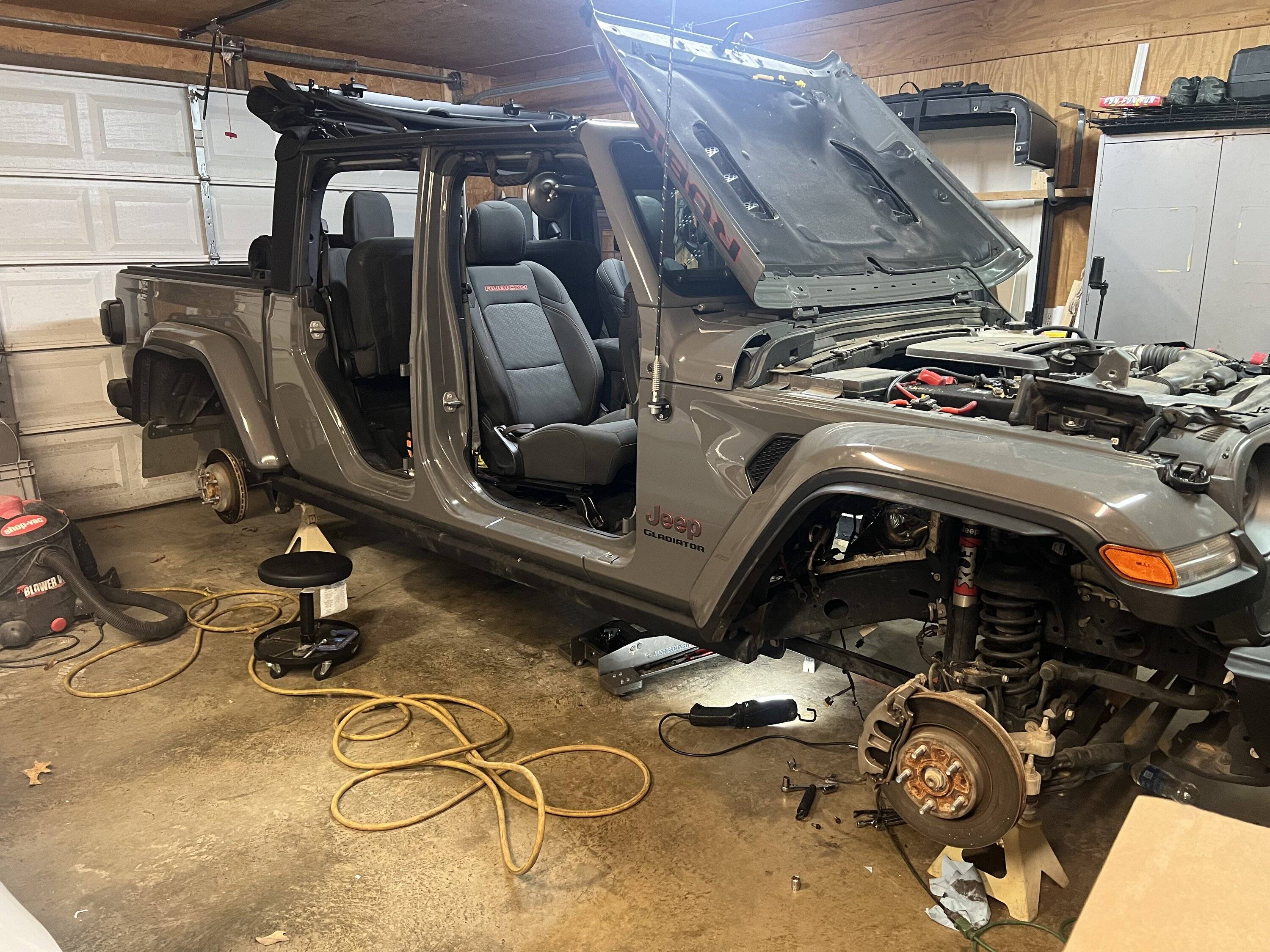

For those curious of doing this themselves. I am doing the work myself in my garage. I have it on the axles on jack stands. Only reason the wheels are off is that after I’m done with the clutch I’m putting 5.13’s in. I’m not in a hurry. I have a beater that I drive to work. So I’m taking my time and learning along the way.
Jeep Gladiator Pics & examination of 70,000 mile factory clutch IMG_2609

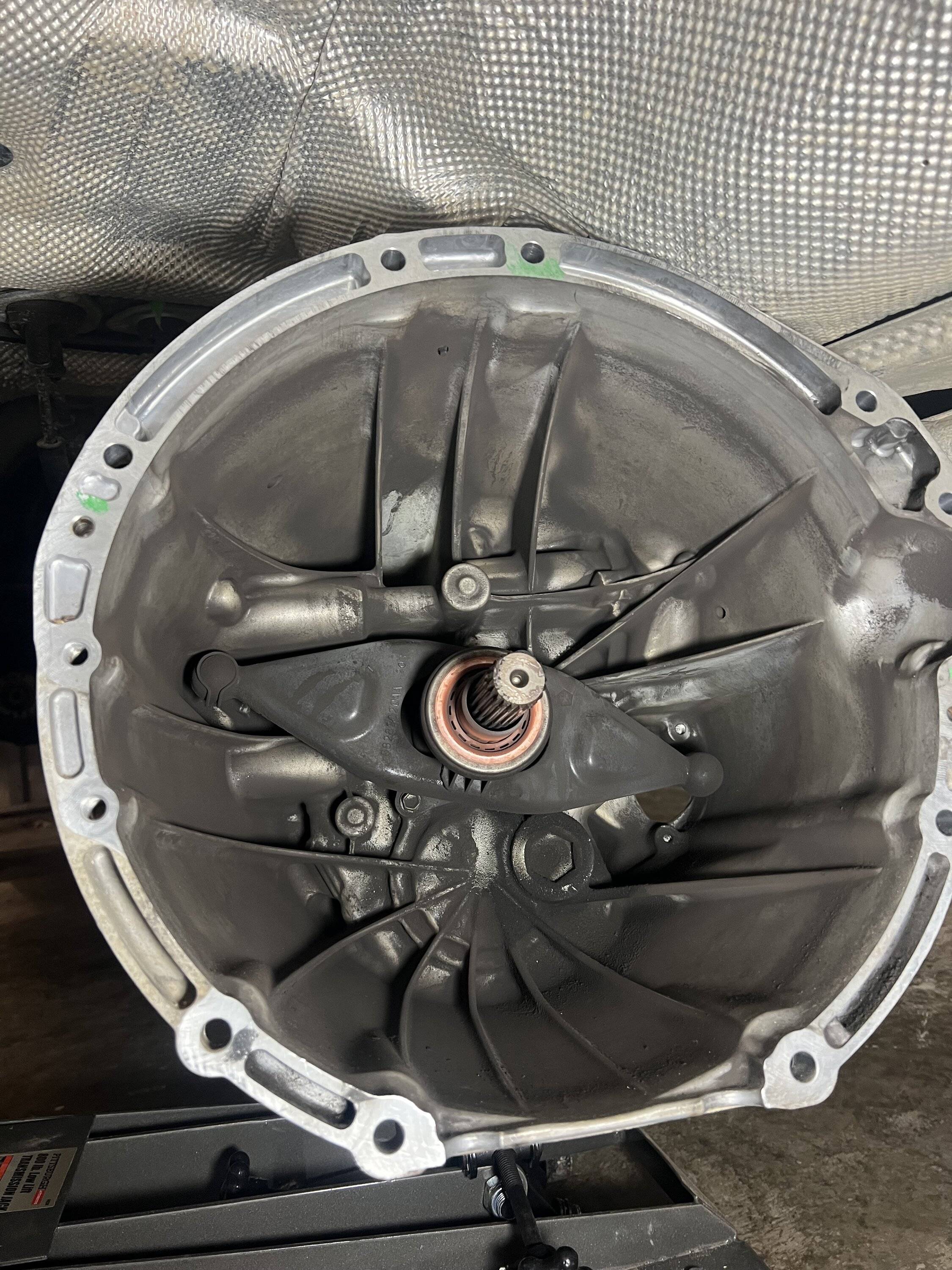

here’s the inside of the bell housing. Throw out bearing is a bit rusty but the kit came with a new one. I’m gonna take them to work tomorrow and clean the parts up before sticking them back in there
