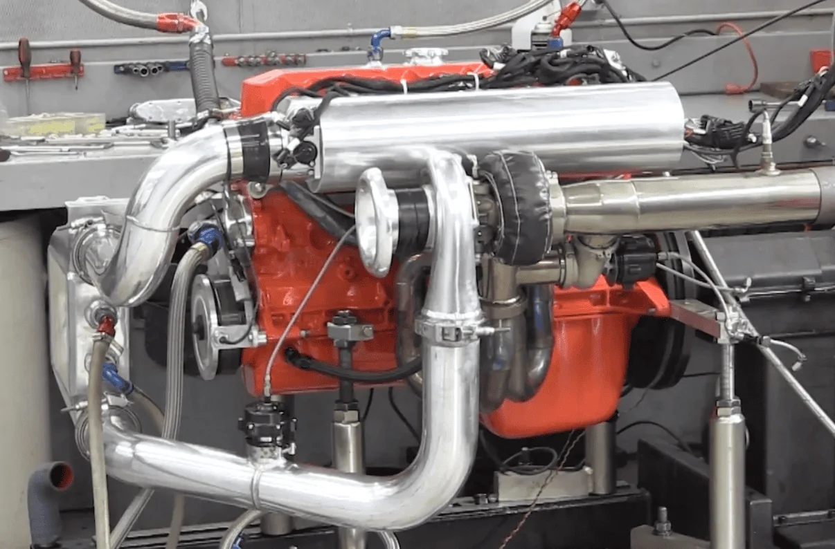

How about a stroked 4.0 that can rev to 6200 rpm, make 395 horsepower, and 367 lb-ft of torque?
They are out there — without using a turbocharger or supercharger.
Or this one that does 861/881.
If it can be done with a 4.0 (massively modified) then getting power out of an engine built from the ground up for power and torque from low displacement isn't that big a deal...........
Jeep Gladiator Pics of the new Hurricane twin-turbo I-6 engine live at Stellpower 1664896783863
If I recall, Honda has reached at least 120% pumping efficiency with a NA engine.
Creative minds will keep ICE around for a bit longer. It won't be cheap to do, but nothing worth doing is ever easy or cheap.

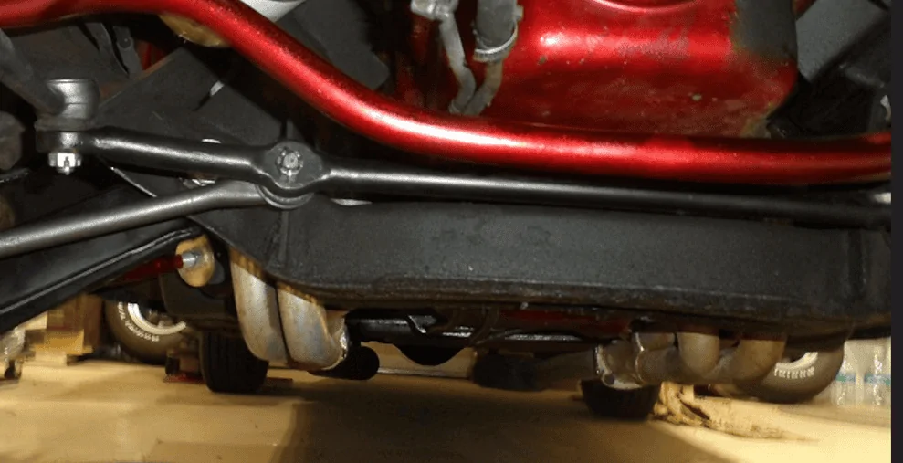

I can't think of a U.S. production car that had tuned headers from the factory. Even Ford, starting somewhere in the 80s, used tubular exhaust manifolds on HO engines, but those were not tuned and not really headers per se.
Tuned headers take a lot of real estate, and need length. There simply isn't space. Not with the converters and so on needed. They are a pain in the butt to deal with (I know - I rigged my own setup with pipes underneath that can be unclamped and unbolted should I need to drop the transmission out) and they let loose a lot of heat very early. That's why many of us wrap the header tubes with with a heat shield material like asbestos.
They must be equal length tubes and the collector has to be designed in a way that minimizes the individual pulses interfering with each other once they reach the collector. Tuned headers also need to be tuned to the peak HP RPM so are really only most helpful at that RPM area.
Then there's the bit of O2 sensors - those are per bank, not per cylinder, so you'd have to have them well down the exhaust stream, past the collector.
Tuned headers are only going to help when everything else is there to back them up, including the rest of the exhaust system, the intake system, the cam(s) and so on.
They are pretty much worthless on a typical engine.
The 4.0 used tubular exhaust manifold, but not really headers although we call it that.
Integral exhaust manifolds have a couple of advantages - no issues matching ports, no issues with leaks where the exhaust manifold bolts to the head (a real problem with bolting to aluminum heads with different expansion rates) and they won't warp or crack.
Exhaust manifold designs do matter - a lot. AMC gained quite a bit with their dog-leg exhaust ports and free-flow exhaust manifold design in 1970.
Tuned headers take space, take money, and turn speed bumps and dead bugs on the road into obstacles to be avoided.

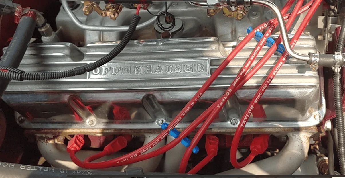

Luckily, unlike some Mustangs I've worked on (Cobra jet 429 hit my memory) and headers, I have no trouble reaching spark plugs............
But these make no difference unless I wind the thing up pretty tight.
