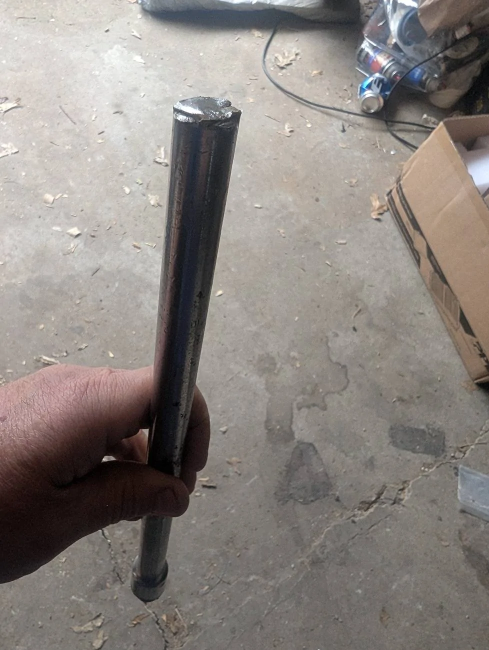

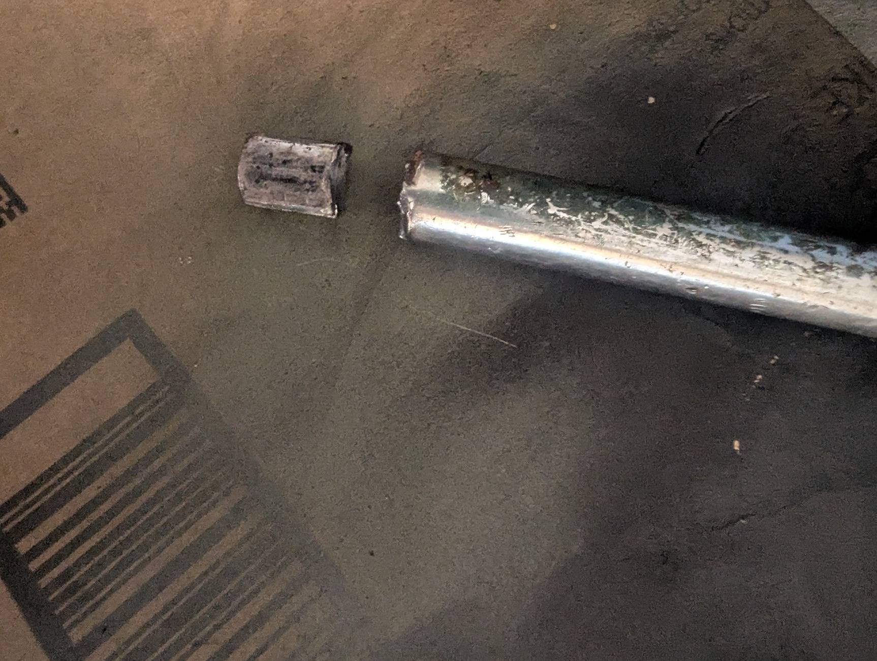

Y
Yup, here are pictures of the victim!
You are loosing a lot of energy using such a long extension. Something that long will twist like a spring. Just use the breaker bar and socket directly and put a pipe on the breaker bar to get more leverage.
