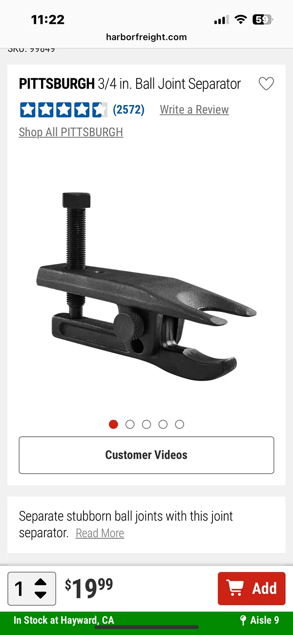

I've been using the one below from Harbor Freight to separated my draglink, tie rod and ball joints on multiple vehicles with it. Tight it down some then LIGHTLY hit the bolt head with a 2lb hammer a few times, then tight it down a little more then hit it again. Do that cycles a few times and it should pop loose.
I use this too but my process is just to let the impact do all the work. No hammer needed. Doesn't usually damage the boot like a pickle fork will.
Yup. Not damaging the boots is awesome. I like the hammer technique to avoid damaging the thread. But whatever works 👍
