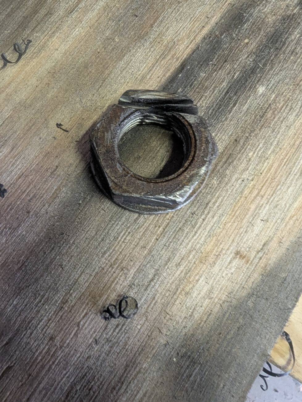

Late to the party, but slicing nearly all the way through and then tapping the gap with a chisel would've been the least risky and least costly move here. A new nut is way less $$$ than all the tools that have been bought and destroyed here. :(
I agree. Depending on the cutting tools the op has. Edit. A hack saw works. Just time and muscle.

I am still perplexed why this has turned into a thesis on over solving the problem. Cutting nuts, cutting pitman arms, buying induction heaters, buying 1700ftlb impact guns, ect..
The issue at hand is the nut is being stubborn because of red loctite that has hardened, and won't release without heat.
Using a big socket, a breaker bar, a pipe and a blow torch is all that is needed. You will need to hit the nut with heat a few times cause it will cool as you unscrew and the loctite will reset but it's not that hard.
It took me longer to source a big socket in town then to get the damn nut loose.

Ok here's an update, skimmed the threads on but barely. Thanks for all the tips and jokes!
Jeep Gladiator Pitman arm nut seized! 1000001150

You can clean up those threads with the right die, or just use a small file (harbor freight sells sets for cheap) and carefully de-burr the threads if you have trouble getting the new nut on.
I'm happy for anyone who manages to get their nut off.
I beat it enough, be a damn shame
If I didn't get it off!!
