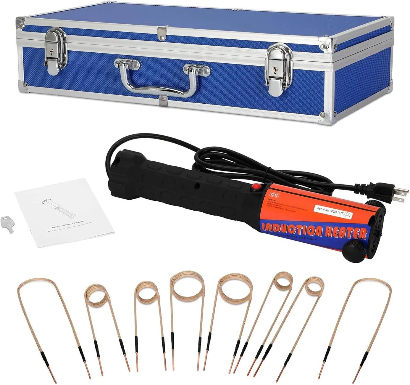

If you want to buy me one, I'll send you my shipping address. I have better things to spend 300 bucks on that I will use more. We don't have rust in AZ.
Rust doesn't matter.
Works great for FRAME bolts (melts Loctite) and helps loosen taper joints and so on. The one Russ shows is only about 150. It is a great tool for tapered joints, locknuts, Loctite. I'd say I've yet to use mine on anything with rust.
I've used mine to pop the pulley off the gear box for my JT lawn tractor - tapered fit, couldn't get a press to it. I've used it to heat steel rod and bars to bend them and more. You can even use surface coils to help pop dents and such.

That's why an induction heater is great - concentrated heat only on the nut, fast enough it doesn't easily travel to other areas.
FCA recommends it for loosening body to frame bolts on Jeeps.

Alright, just ordered the heat induction kit and Now going to HF to get a !,200# impact gun, if either one of these 2 do not work, It's Blasting cap time!!! 🤬
