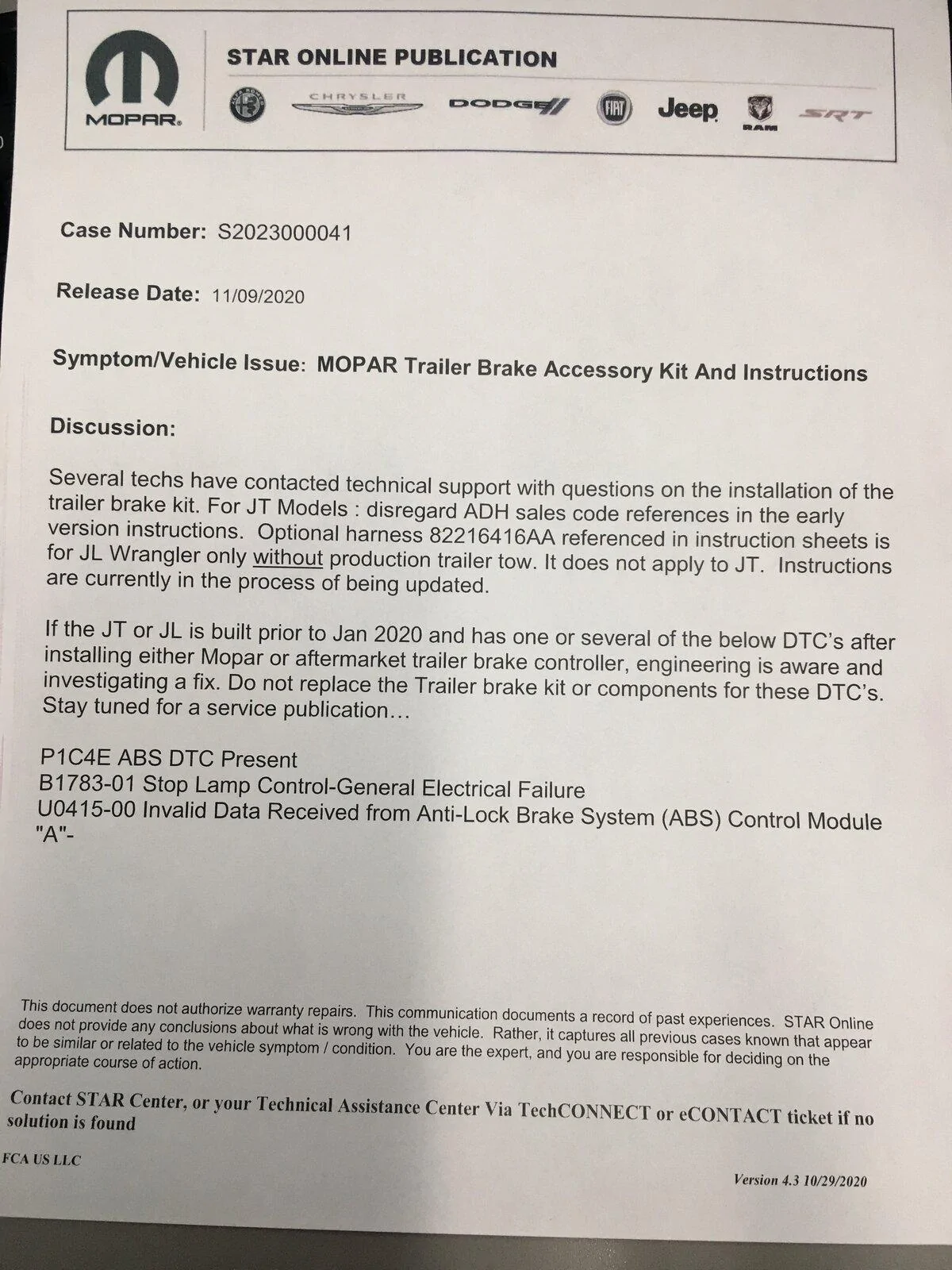

The below definitely matches the communication from Jeep to dealerships about this.

Take a copy of this document!!!
The dealer CAN NOT FIX THIS ISSUE...... most are not even AWARE and if they call they will get BAD INFO.
There is quite literally no use unless you want to get on record for warranty - this document tells you all you need.

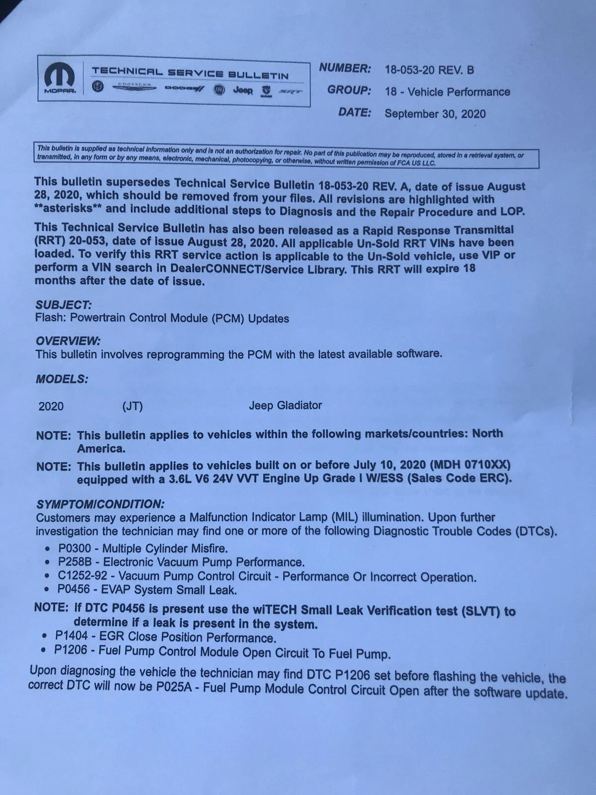

I sent the Jeep dealer a copy of this and they Just called me back saying there is a new TSB out after this document on November 9th and they want me to bring my truck in to perform a flash that is supposed to fix the issue with the 2019 build gladiators.

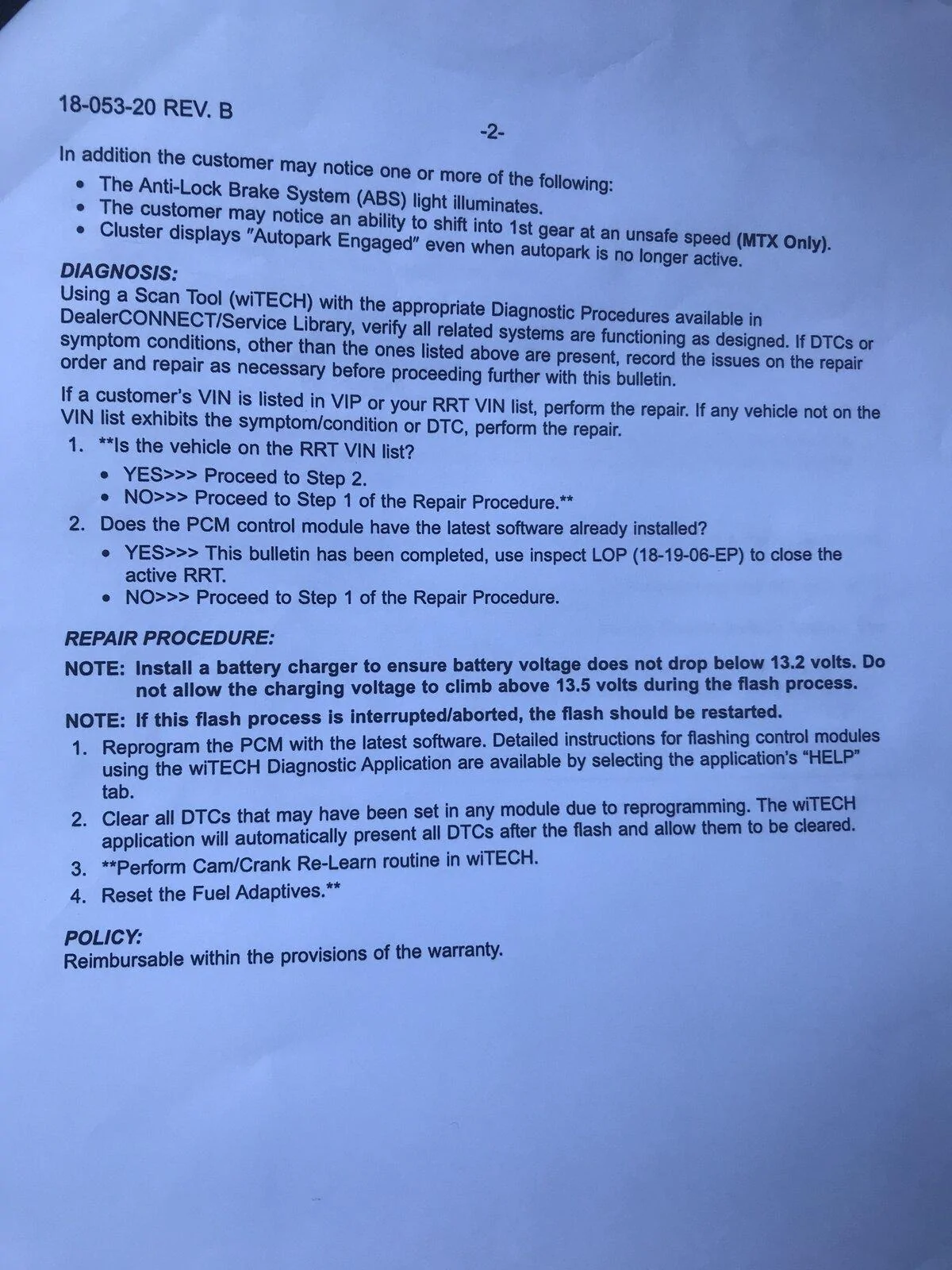

At the Jeep dealer waiting, the service advisor said there are 2 updates, one to add the controller to the VIN and another to fix the issue. He did say he would give me a copy of the TSB when they finish. Hope this isn’t BS, more to come

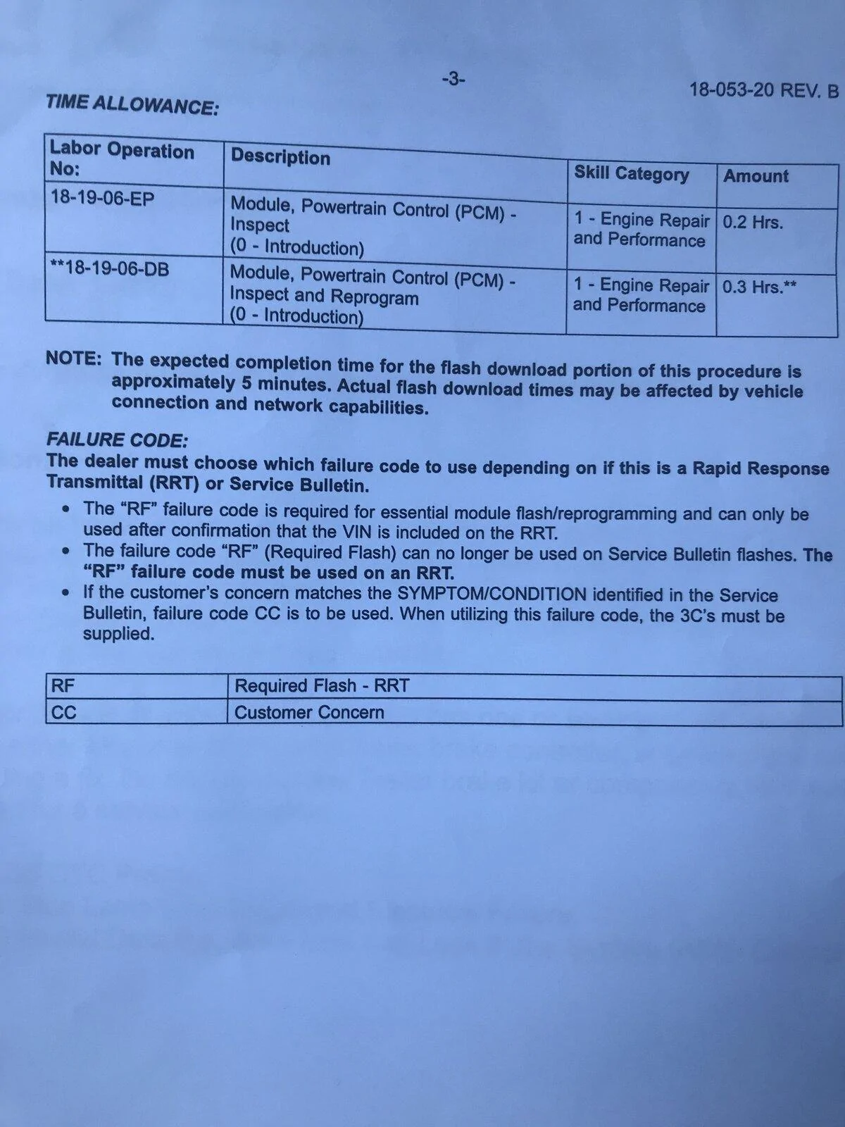

So since my sport had the TOW package it didn’t need it added to the VIN and the “FIX” didn’t work?
Back to the drawing board, I’ll have to put this ? over the manual break button until they have a “fix”.
attached TSB, don’t look like it was directly related but the update had some good I guess.
Jeep Cares, I did my part, now it’s your turn.

Yup - you were due for the same PCM flash I got - very unrelated to the brake controller. False alert.
You would have gotten that PCM flash anyway, would be my guess.
I drove in for my wave oil change and tire rotation, they looked and found my VIN was due for a PCM flash.
I can't imagine the PCM being involved with the brake controller, all of the brake stuff goes through the BCM.
