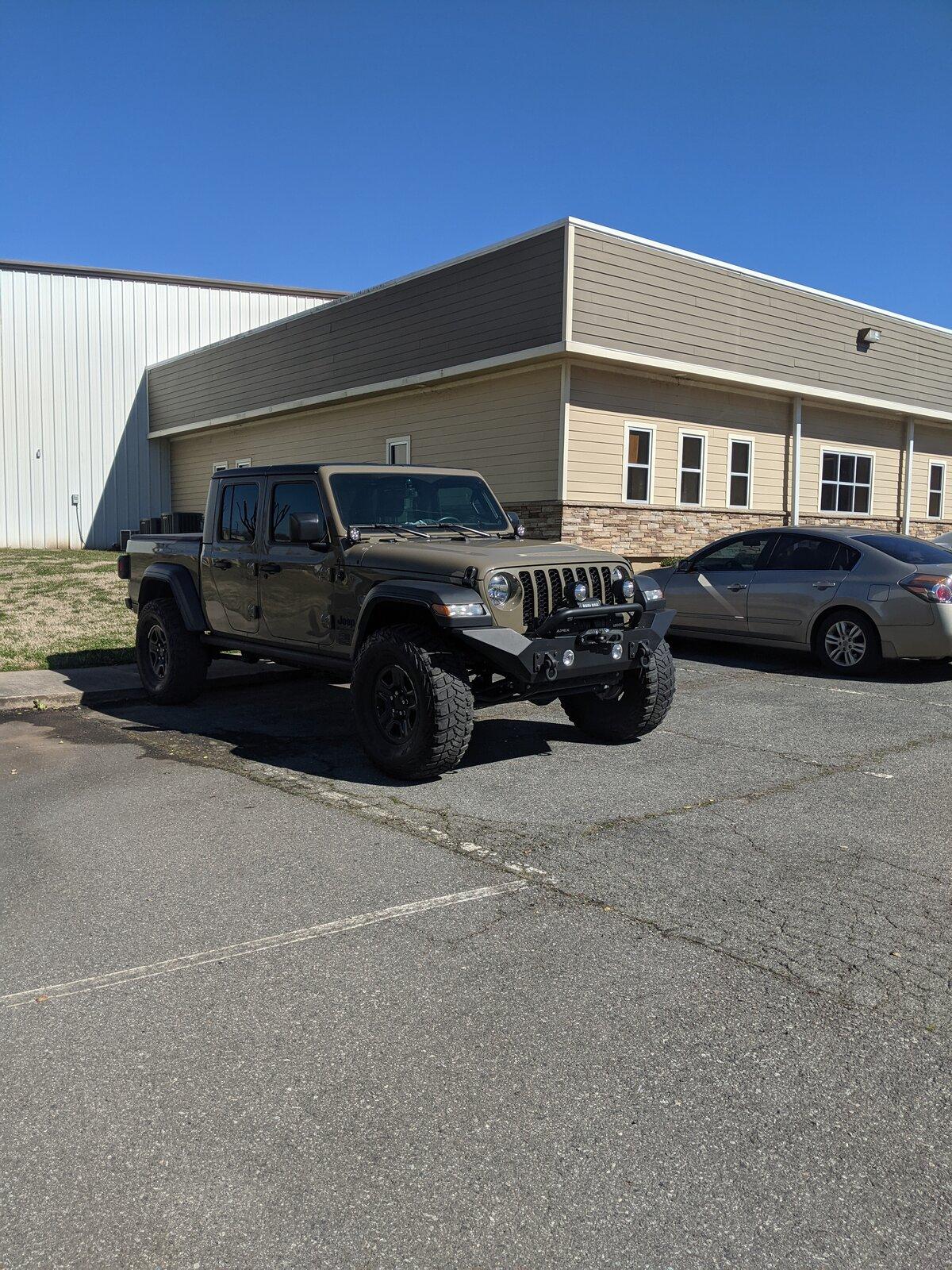

I would be willing to do just about anything to improve this though. This was a flat road with the cruise set to 75.
As long as I stay below 80 in mine I was able to maintain around 18.3 mpgs on 35's and I'm at 17.3 mpgs on 37's. I am around 50/50 hwy city driving. CAI isn't going to yield you any more Mpgs unless you do some tuning to your vehicle. Putting thought into the aerodynamics and how it came stock is going to get you the best possible solution for mpg gains. One of the reasons the Max Tow get the better gas mileage is because of the 4.10 gearing and how it's setup in the front bumper wise for aerodynamics. When I switching out mine to a different bumper I made a decision on a full width and high clearance bumper because it was as wide as the stock one and filled in the fender gap between the bumper and fender. The more air that gets up inside there the less Mpgs your going to see because of wind drag. Also tires and wheels, weight etc all come I to play. One of the reasons I kept my stock wheels and went with a light 35 and now 37 tire. When these tires wear out I'm looking at a even lighter 37 tire. Just some things to think about. Mine sits like this and I can easily get 17.3 in mine and probably more than that if I go on a long trip, that's just local driving.
