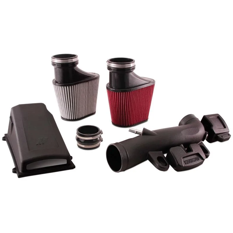

I just installed a Mishimoto CAI
https://www.mishimoto.com/jeep-wrangler-36l-performance-intake-2018.html#prettyPhoto
Similar to the MOPAR CAI but is CARB Compliant. It's the only aftermarket CAI I could get shipped to California. Ordered on Amazon Friday morning, arrived Saturday afternoon.
The stock intake actually has more hp and torque below 3300 rpms than the Mishimoto according to the dyno chart on their site. Do you notice that during normal driving?
Not really, then again any type of gains or losses are pretty mental when it comes to these things. I do gain a little more throttle response? Then again, it's all mental. More curious about MPG.

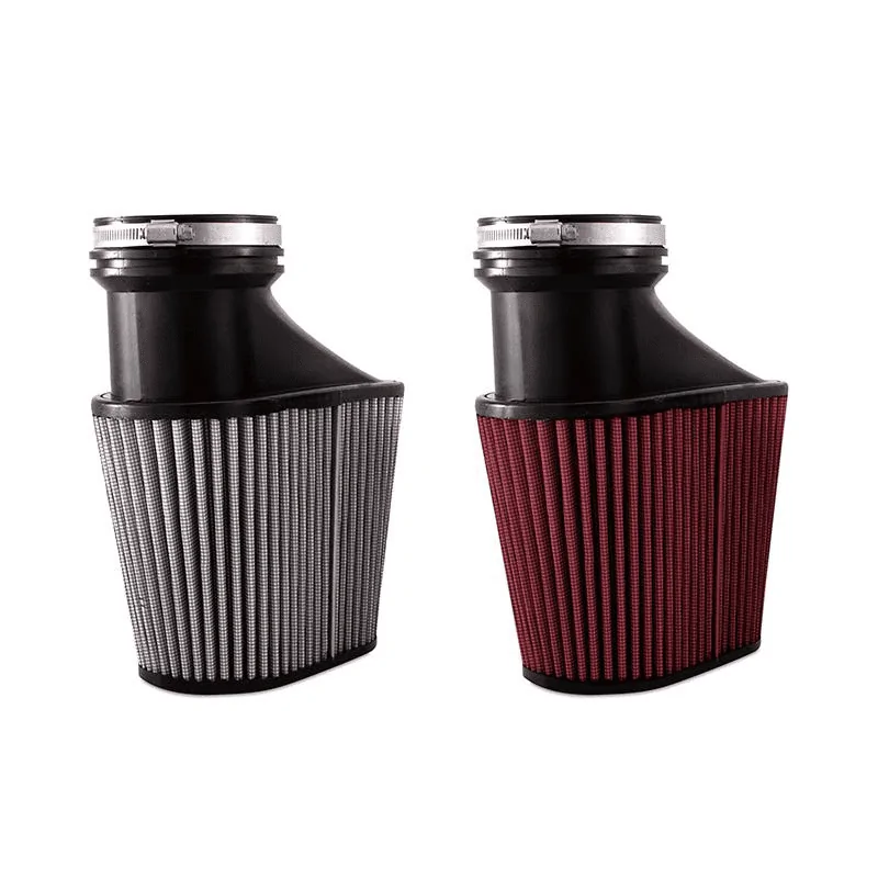

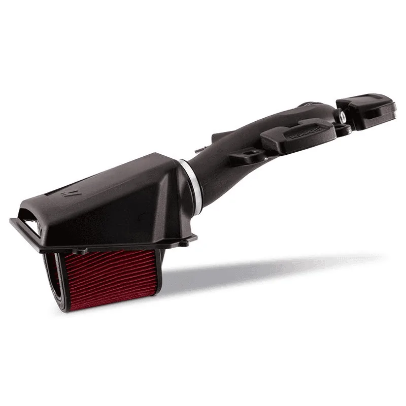

Similar to the MOPAR CAI but is CARB Compliant. It's one of a few aftermarket CAI I could get shipped to California. Ordered on Amazon Friday morning, arrived Saturday afternoon.
Curious about this option as well as the Mopar for towing. I have AEV snorkel so it needs to plumb into the lower box. Did it come with a silicone plug for the top hot air inlet?

Curious
No it does not.

Curious
The Mopar CAI leaves the lower box intact. It replaces the upper cover and the air tube. It comes with a washable filter. I used the OEM paper filter instead of the washable.

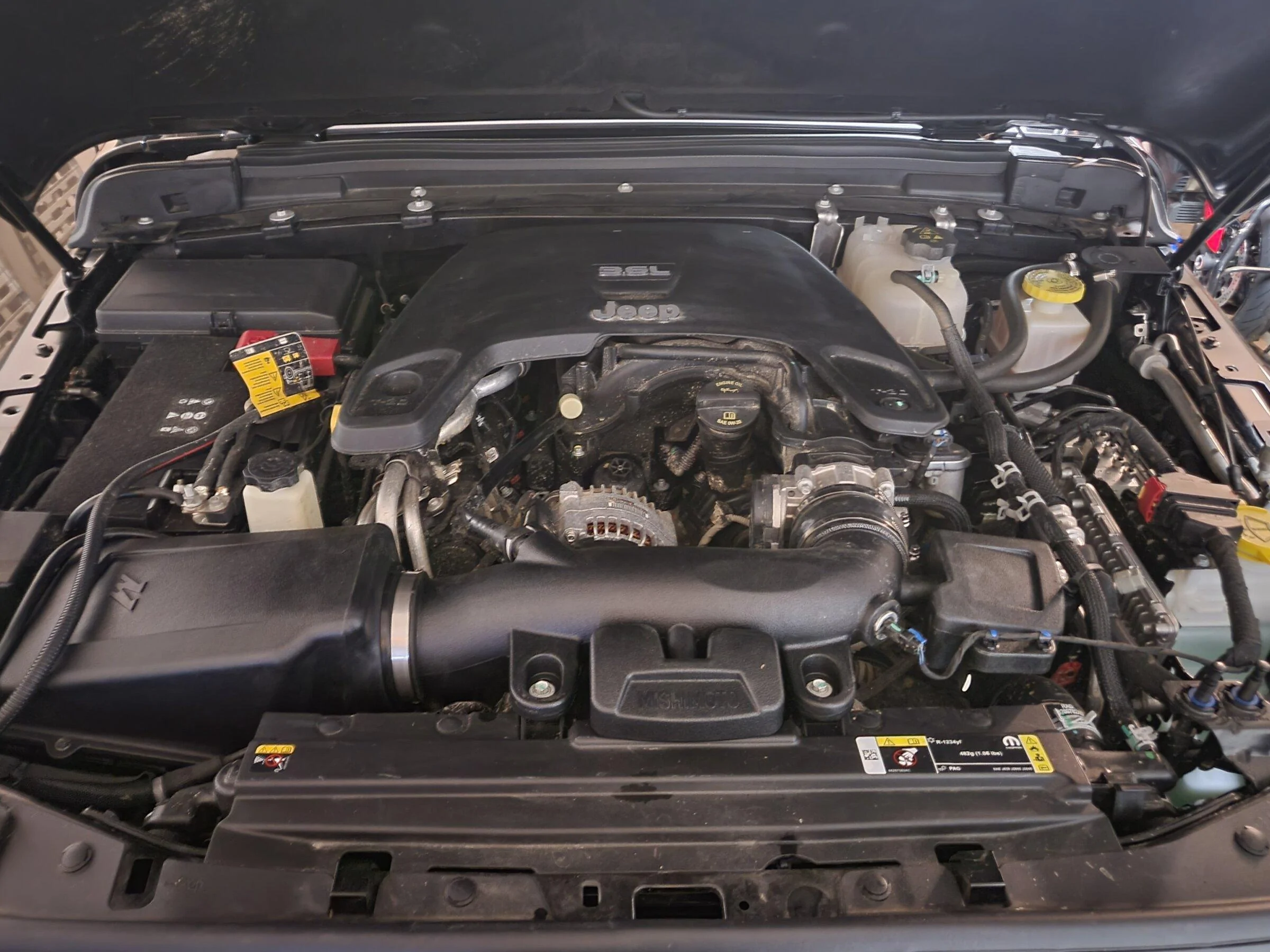

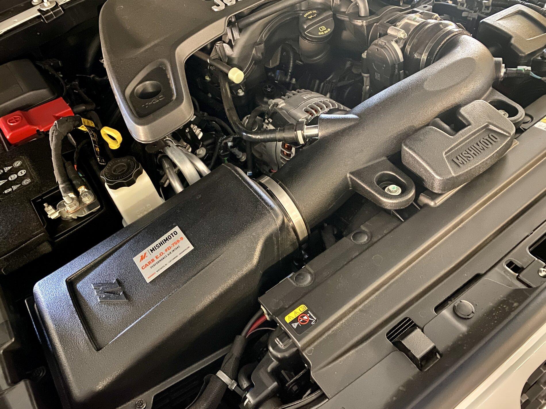

I'm enjoying the Mishimoto intake. It fits very well and seems to perform well via my butt dyno. My tune was built with it installed as well.
Check out their engineering pdf on their website. Pretty neat.
