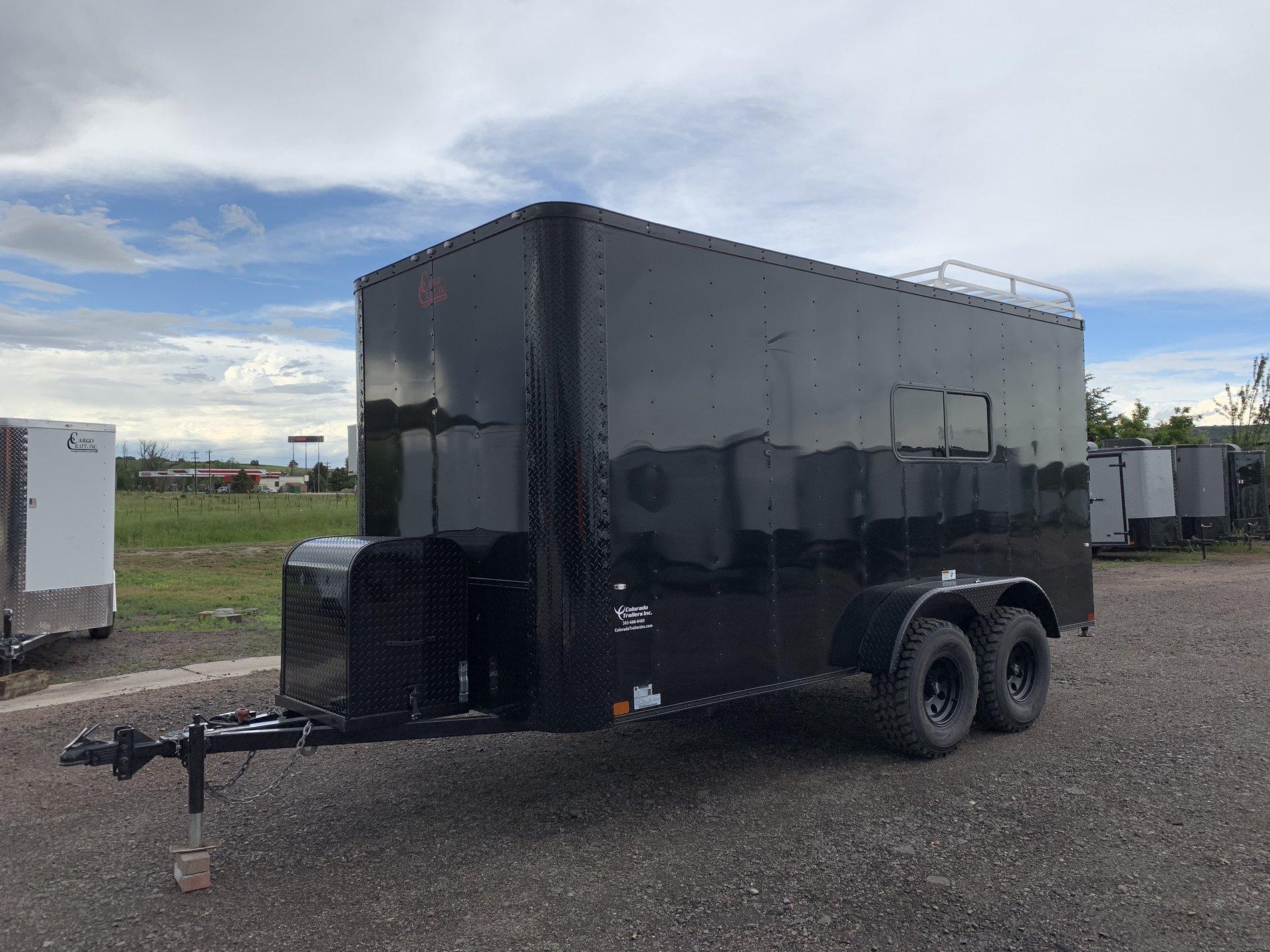

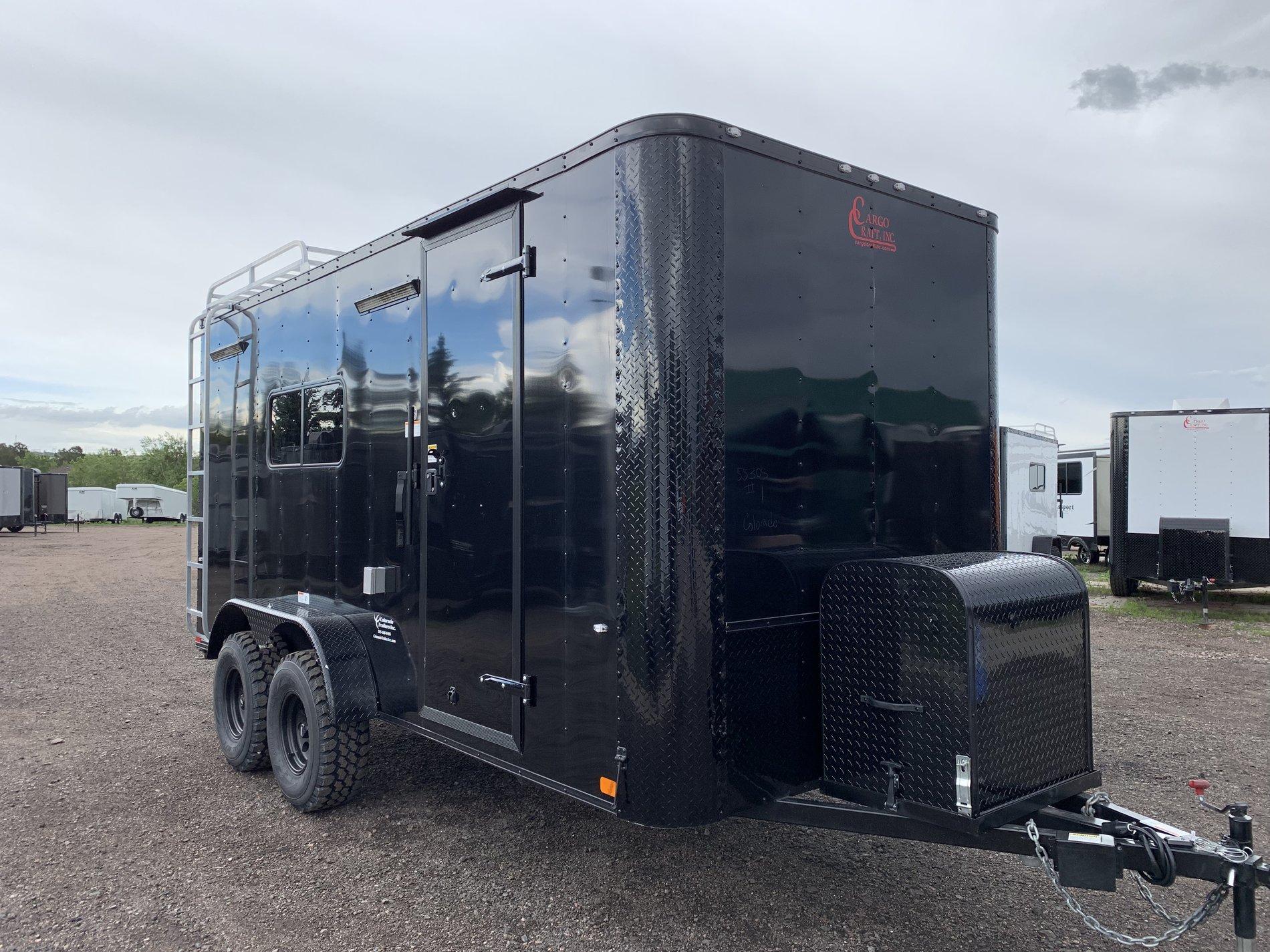

I just ordered a rubi diesel and this is mine I will be pulling..... toy hauler and camper all in one nice off road pkg. weighs nothing....
Yeah that's exactly what I use, except mine doesn't have offroad tires on it (yet). Dry weight is 2,200 lbs. I haul my UTV in it, and when we get to the campground I unload the UTV and set up the matresses inside to sleep on.
It's not high profile camping like some prefer, but it gets the job done very nicely and maintains a primitive camping feel while giving solid protection from weather and animals.

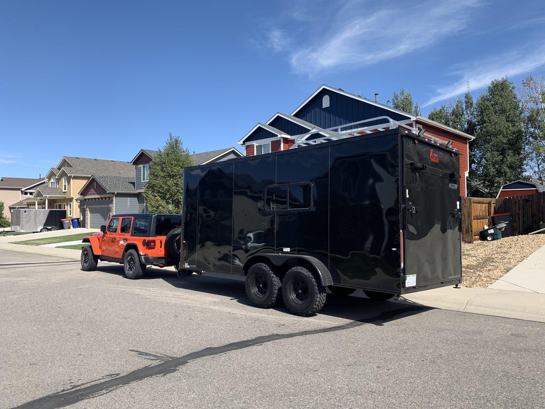

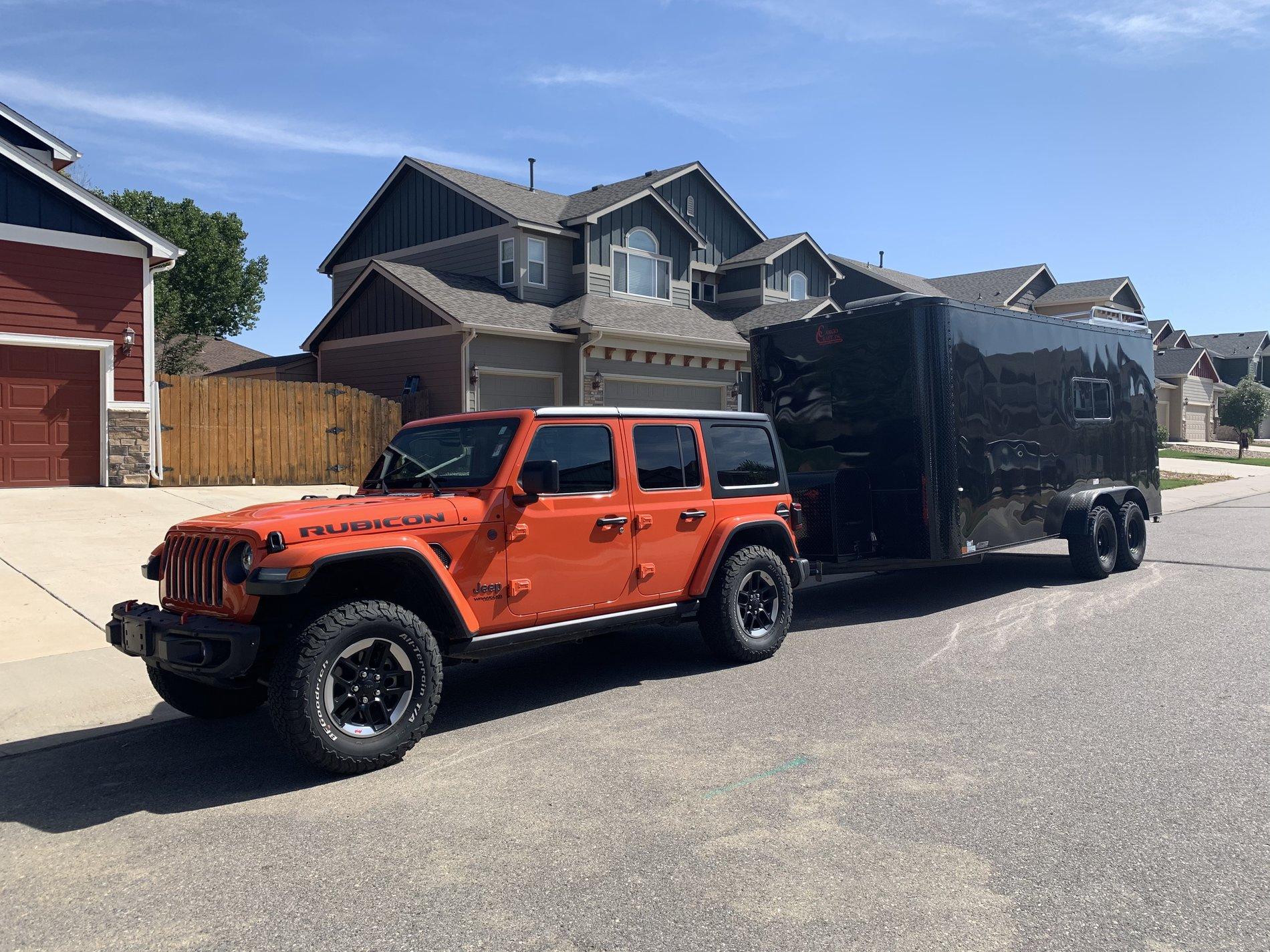

Nice, this one came like this and I believe it weighs about 3500#....

What size is your trailer 7'x14'x7.5'?
it is 7x18x7..... it came in at 5750 lbs loaded with my rzr 900 trail and my can am 2 up atv….. and all our gear.
