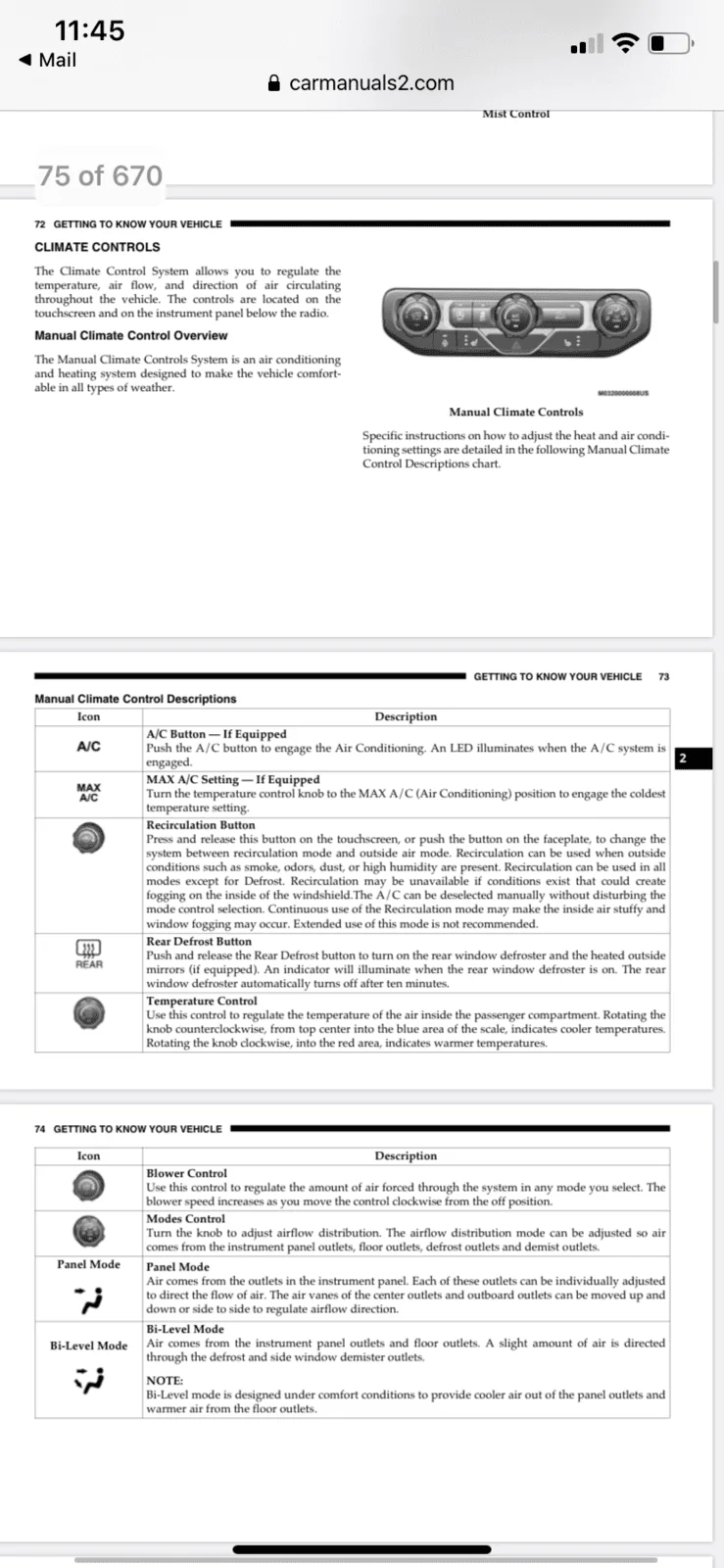

On the JT, just like every vehicle I've owned with auto A/C, there is no manual mode. "Auto" means everything is automatic. Hit the fan speed and the direction and temp stay in auto despite zero notification otherwise. Same if you hit the airflow direction, fan speed and temperature will still be automatic. Hit both and only temperature will be automatic. The only way to get temperature to do specifically what you want is to dial it to LO or HI, with nothing in between. Not saying I agree with it, just how it is.
Please read your manual before you spread incorrect info as you did in your above post.
Please refer to page 72 of your manual and it will describe the manual mode in which you INCORRECTLY claim doesn’t exit.
It’s simple, set your temp to desired temp, and it should be that temp. Set your desired blower and it should blow at that speed.
Our vehicles aren't working as described in the manual. This is the point of this thread.

Those specific pages are covering the manual, single zone a/c system in the base Sport model not the automatic, dual zone a/c system on every other model.
Granted, I've only had my JT for three weeks and it's spent almost all of it's time in auto. I tried this experiment in my Honda on the way home from work today (and had previously done it on my old Canyon) and will try it on my truck tomorrow. Put it in auto, adjusted the fan speed to knock "Auto" off, then crank the temperature up or down and see what changes. In the GMC and my Honda it would keep the fan locked but adjust the temperature and direction automatically. Then flipped it back to auto and adjusted the air direction to kick it back out of "Auto" then crank the temperature up or down and see what changes. In the GMC and Honda, the fan speed changed and the air temperature coming out of the vents will change but the direction won't. If I can find my thermometer I'll dick around with that as well to see if and how much the vent temperature changes.
Also, like I said here or in the other thread: I'm not agreeing it's the best way, just seems to be the common way and if it's still blowing warm/hot air at 72 degrees but it's clearly above that in the cabin, something isn't right.
The manual mode is still the same I described on the 7 and 8” models. The manual mode is still (per the manual) supposed to do as I described. The only difference is When your in auto mode, you push the auto button, to turn off the light off which then goes into manual mode.
Just to clarify- when you push your auto button or change the blower speed, this “kick it out of auto” you described is putting it in manual mode.
Can you clarify your comment “the fan speed changed and the air temperature coming out of the vents will change but the direction won't”?
how I’m reading it your saying somehow in manual mode the fan speed is changing the temperature. That should be the case. In manual mode the blower controls the blower speed and the temp controls the temp, this being in manual mode. In auto mode you choose the desired temp you want to the cabin to be. If the cabin temp is close to the desired auto set temp, the blower and temperature coming out won’t be as extreme. Compared to setting it at 82 when it’s 30 out, the air should be blowing pretty hot and the fan speed should be high to move the air to accommodate the large variance.

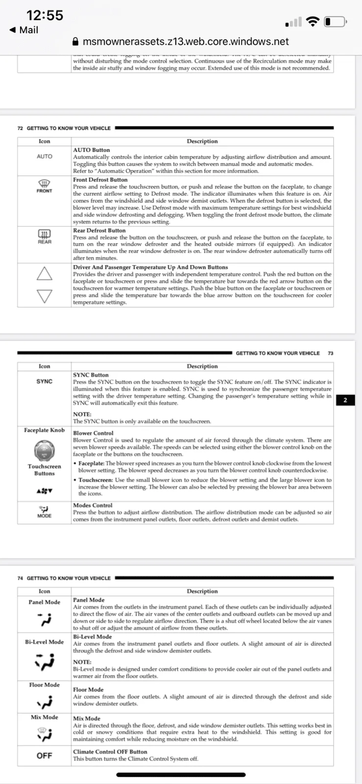

Its on page 72 of both manuals. I have attached the other manual for your educational pleasure.
When I'm saying "kick it out of auto' it's kicking it out of full auto where it's controlling temperature, fan, and direction. My previous vehicles have had just varying degrees of auto with no fully manual mode and I'm assuming this is the same (but am planning on testing it tomorrow). What they have done is that if you adjust the fan speed, the auto light turns off but the temperature and direction are still in auto despite there being no notification of such. Same thing if you changed the direction, the fan speed and temperature were still automatic and if you changed both, the temperature was still auto with LO or HI being the only way to force it to something, which seems to be what the complaint is here.
