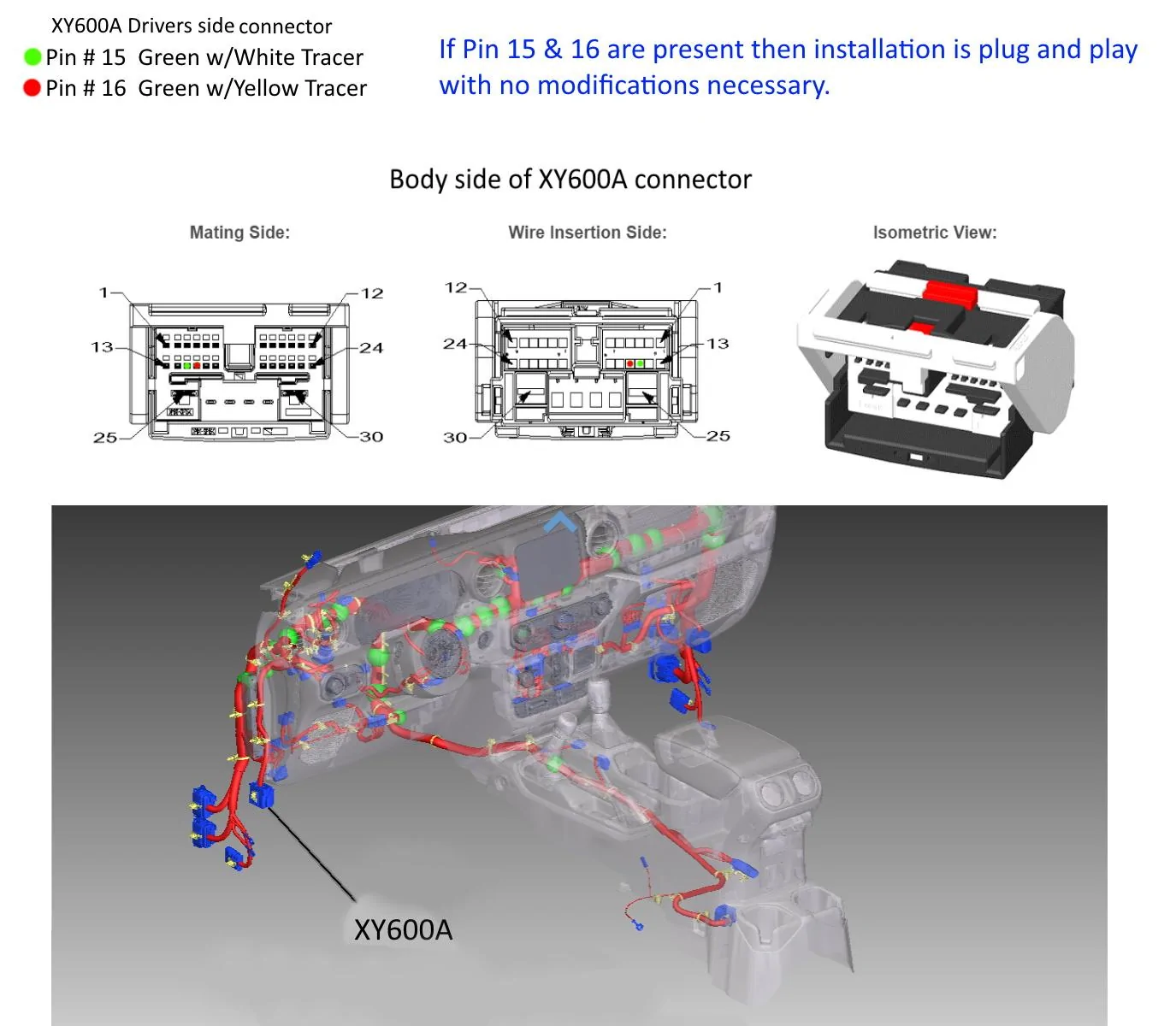

Hi Benny,
If I don't have pin 15 and 16 present, I can't add the proximity kit to my Gladiator?
You can but custom wiring will be needed. Attached is a photo showing what needs to be done. I would search some of threads for any tips and shortcuts some other owners have been doing.
Please let me know if you have any questions.
Thanks,
-Benny

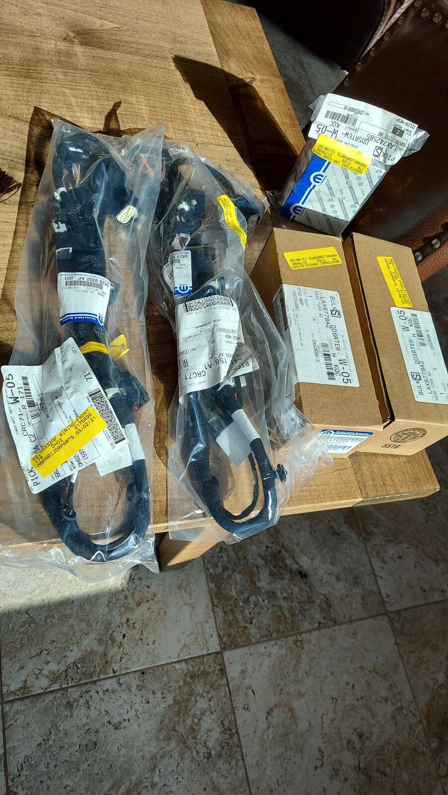

I ordered the parts to add proximity locks to my Gladiator 3 months ago. They just came in today. I have no need for them as I have traded for a new Gladiator with this option already there. For sale $300.00 plus actual shipping costs.
