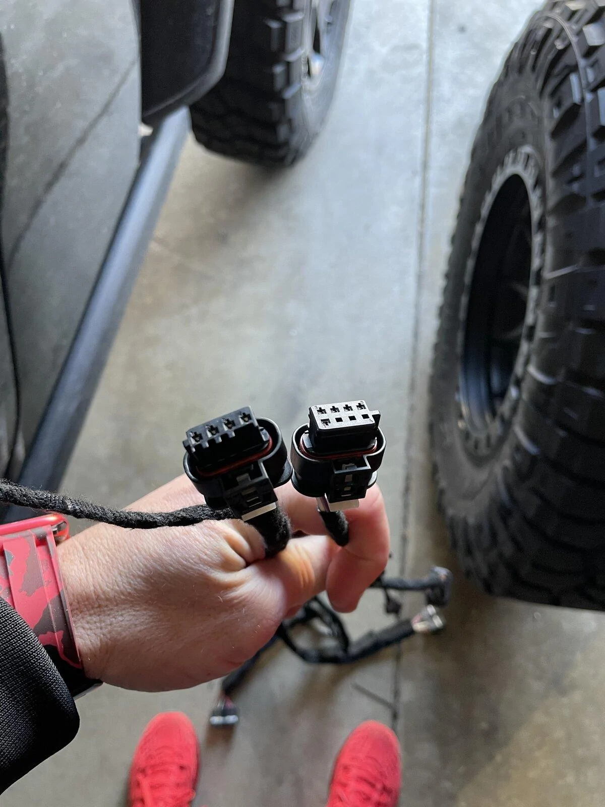

I have my kit and was going to tackle this today or tomorrow is there a quick way to check if my harness already has the plug for the proximity handle? Ie just installing the new handle.
Hi Kevin,
see the attached pinout to check
-Benny
