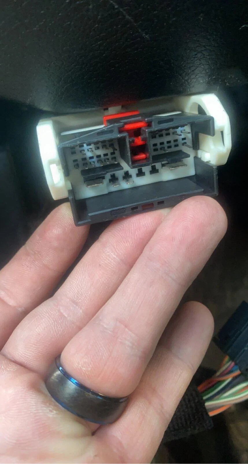

The pins look a bit bent out of shape, Are you sure they are being inserted into the terminals on the door harness securely.
-Benny
Yup, be willing to bet that the proximity lock isn't the only thing not working.
He just hasn't figured it out yet.

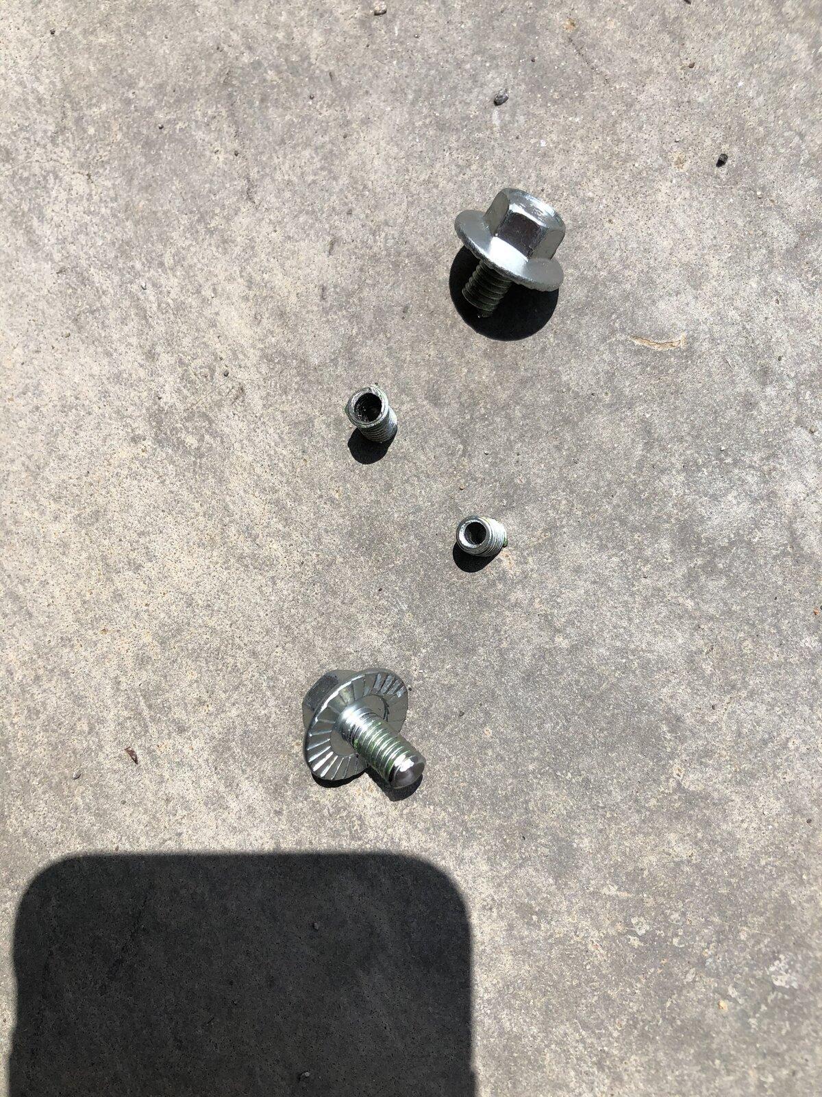

Heat up the green loktite!! I snapped off both window bolts yesterday when trying to tighten them. Was able to drill a hole into each while on the door so I could insert a screw removal tool—but they would not budge until I heated them with a soldering iron for about 3 minutes. Learn from my mistake.
