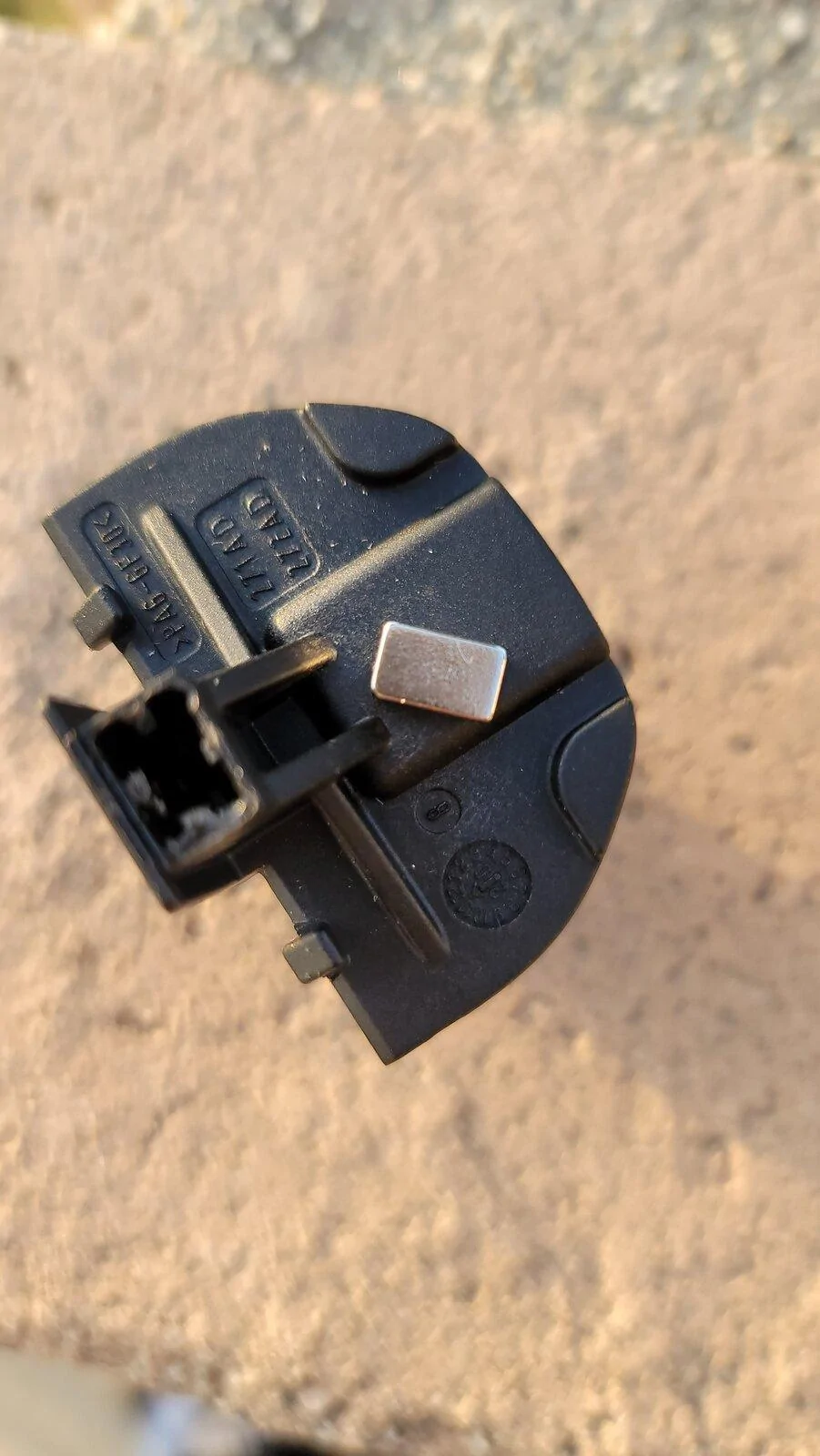

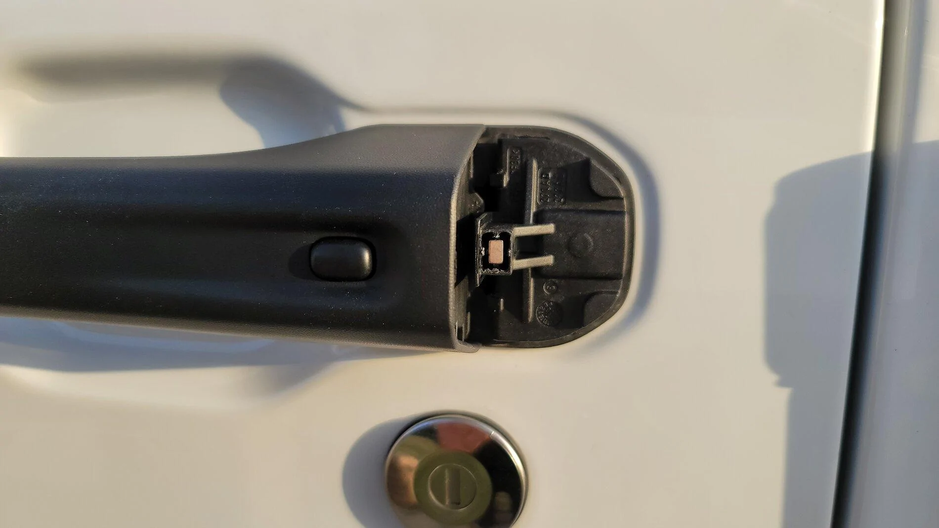

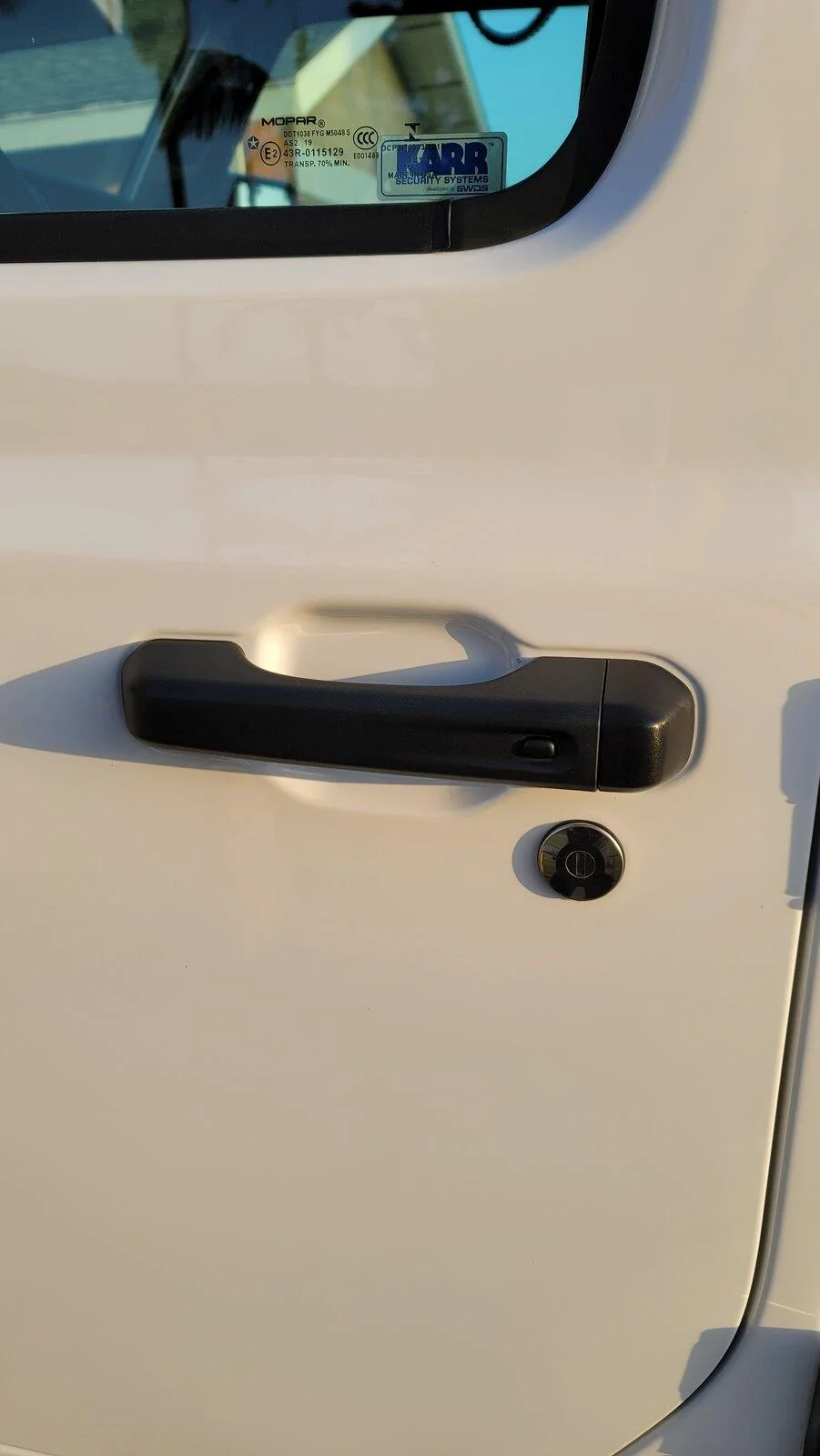

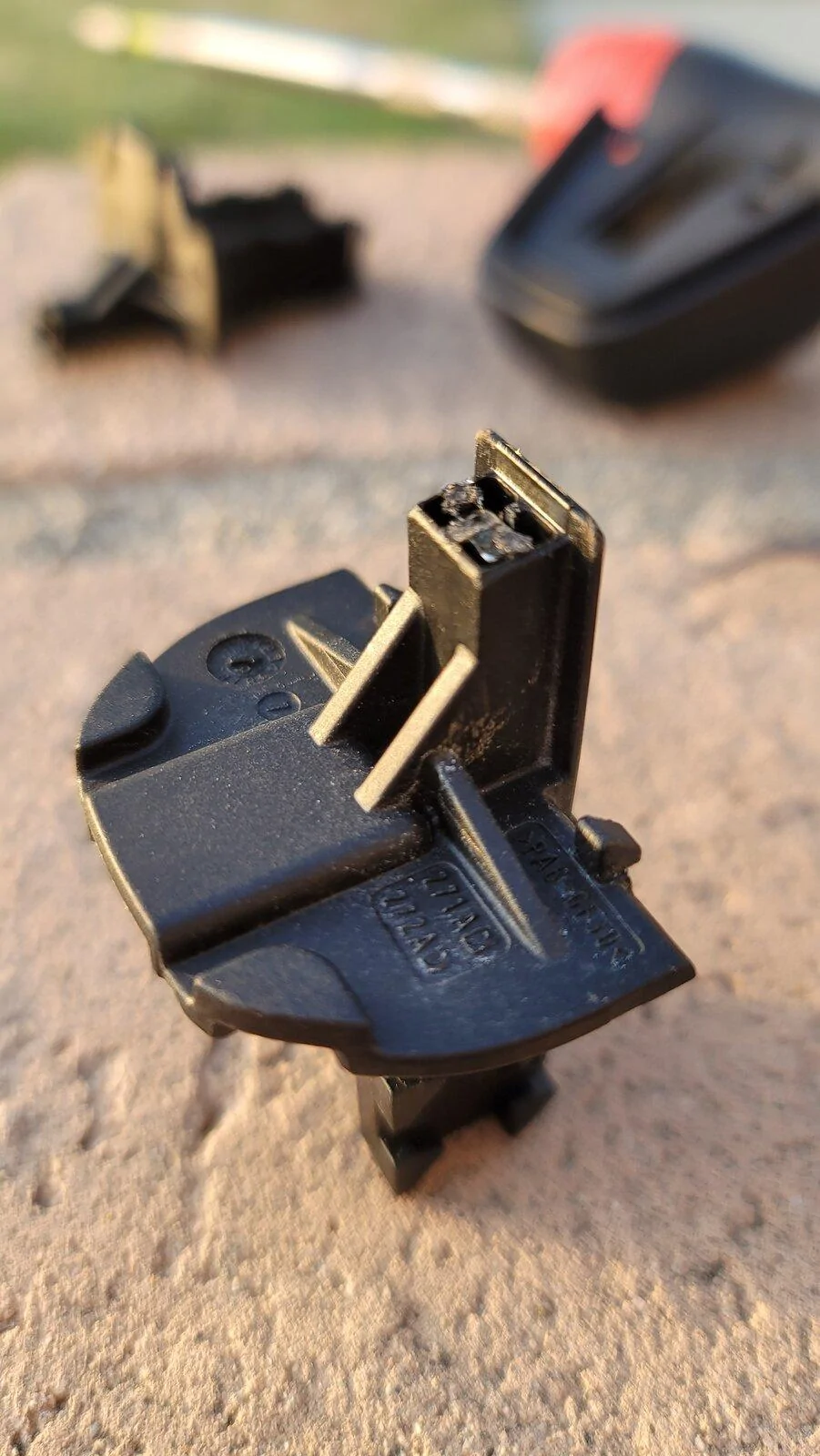

Long time lurker but wanted to thank you guys, my Overland now has proximity entry.
Unfortunately I was one of the unlucky ones that received both bad caps. Instead of waiting for the return and exchange, I opened the caps and reversed the magnets polarity.
Jeep Gladiator Proximity door locks retrofit on Wrangler/Gladiator, someone figured it out (DIY writeup) 20210508_190519
Jeep Gladiator Proximity door locks retrofit on Wrangler/Gladiator, someone figured it out (DIY writeup) 20210508_190530
Snipped of the tabs to take out the magnet.

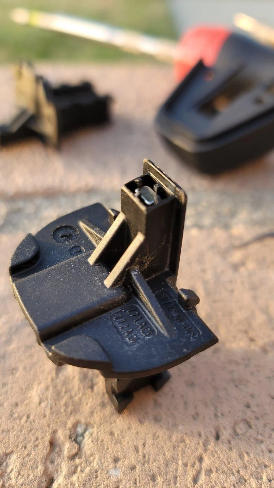

Jeep Gladiator Proximity door locks retrofit on Wrangler/Gladiator, someone figured it out (DIY writeup) 20210508_190732
Made sure the polarity was correct.
Jeep Gladiator Proximity door locks retrofit on Wrangler/Gladiator, someone figured it out (DIY writeup) 20210508_185243
Opened my old Caps and used those to melt the tabs with my solder iron.

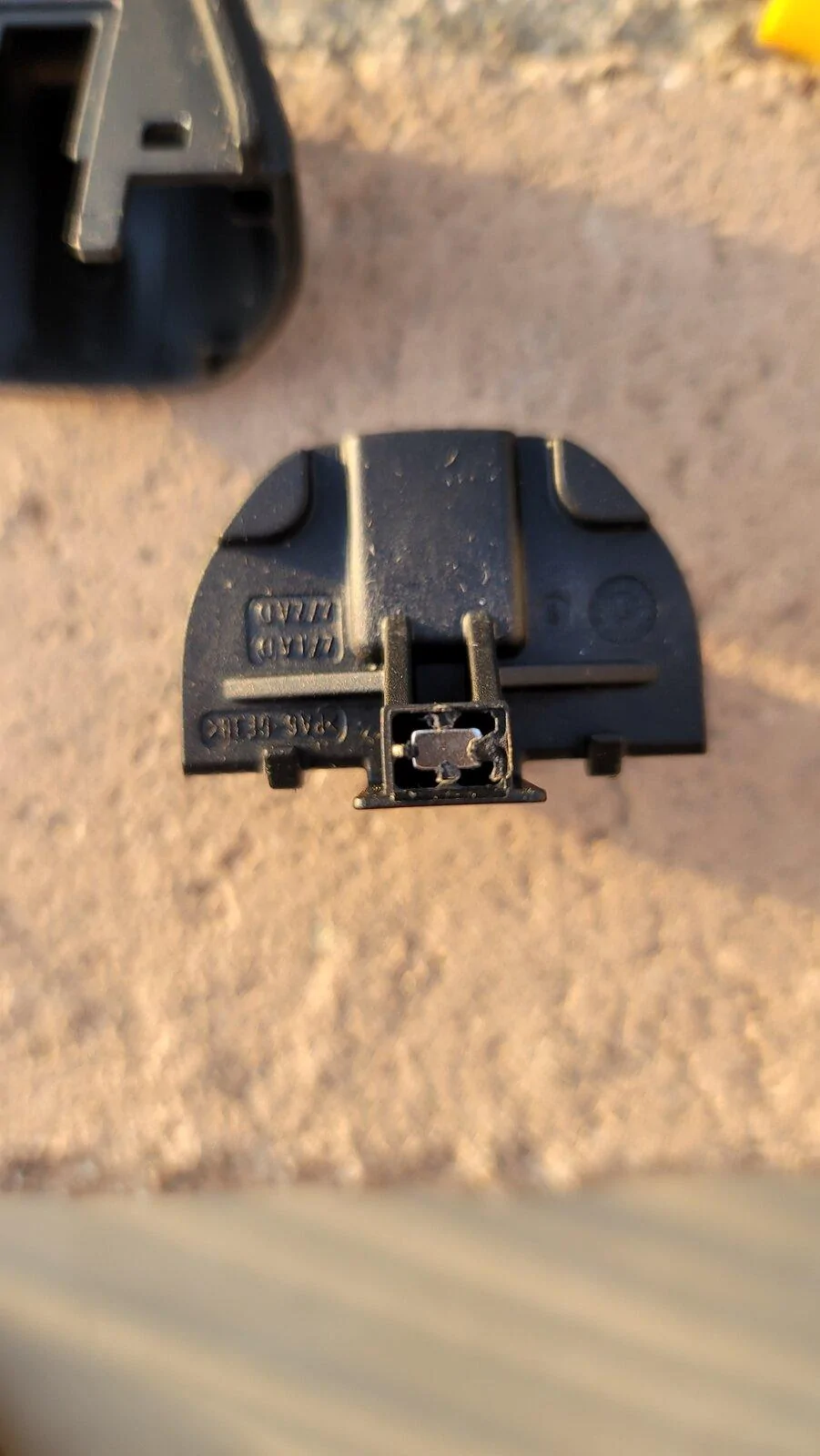

Jeep Gladiator Proximity door locks retrofit on Wrangler/Gladiator, someone figured it out (DIY writeup) 20210508_190928
Jeep Gladiator Proximity door locks retrofit on Wrangler/Gladiator, someone figured it out (DIY writeup) 20210508_191002
Replace and enjoy!

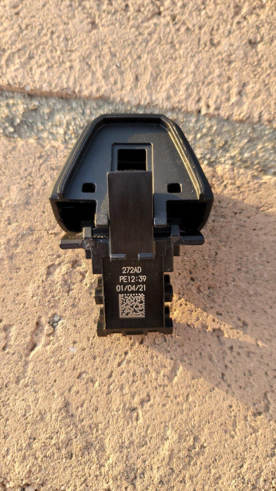

Jeep Gladiator Proximity door locks retrofit on Wrangler/Gladiator, someone figured it out (DIY writeup) 20210508_190252
Hope this helps!
