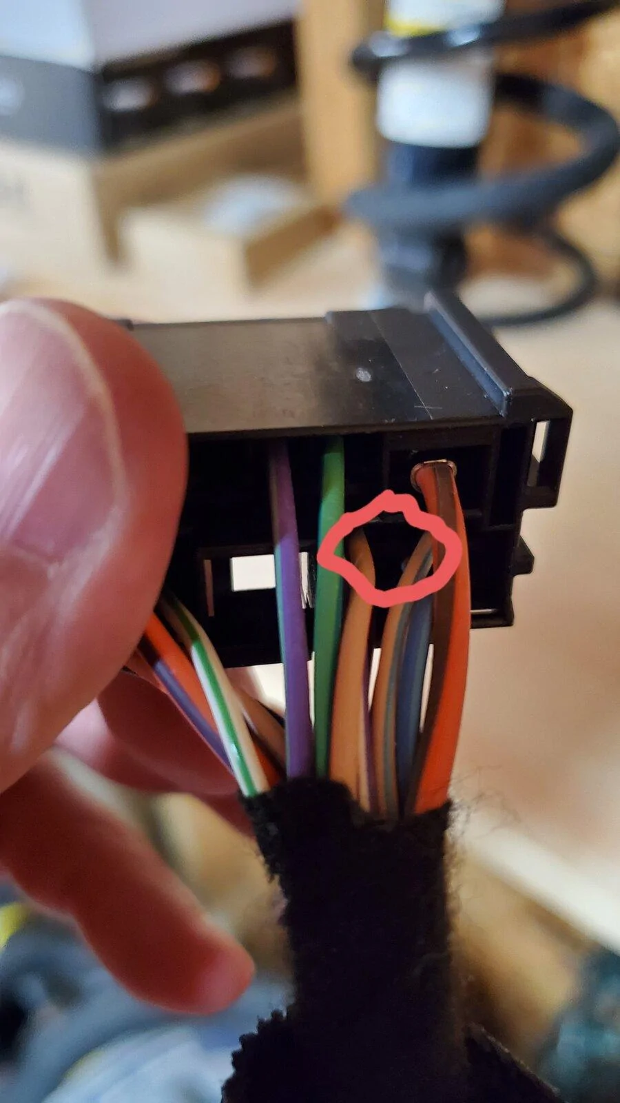

Actually easier then pulling the door card come to think of it. Just look at the door side of the body harness, do you have the wires coming out of it that correspond with pins 15\16 on the body side? If they're in the door, that's where they'd start.
Good point, gonna look this weekend.

Here's the door harness that I took out of my wife's jl last weekend. The wires would go in the gap I circled, as you can see, hers were not there, but thankfully the pins were present on the dash/body side.

Likely referring to the dash harness. There was talk that some Jeeps didn't have the dash harness, some did. That's why there's posts in this thread about which pins to look for on the body harness going through the dash.
I've never seen talk of the door harness having that small connector for the handle and the extra wires leading to it.
Would like to see links where it's said that the Gladiator doors came with the extra wires.
Not in this thread and I don't think it was a gladiator but I definitely read one post where the connector was already in the door. It was folded back and zip tied to the harness.
Either way I'm realizing this is a rare occurrence.
That's one of the most clear VERY close-up pic I've seen. Wow, good job.

I saw that in the JL forum too, it was one or two random Rubicons. Easy enough to check with what I've given you here. Hey, never know!

Can anyone confirm if you have to replace the harness if you have a Rubicom or just replace the door handles? I thought the video mentioned Rubicons already came with the correct harness but somebody posted that Rubicon also needs harness replaced on here as well so I am a bit confused.

Rubicons have the pins in the body side harness. We've seen one or two rubis have the correct harness in the door but it seems to be a fluke, not normal/expected. Check the door side plug like I showed above, or pull the door card and look, but I would plan on replacing the door harness.
