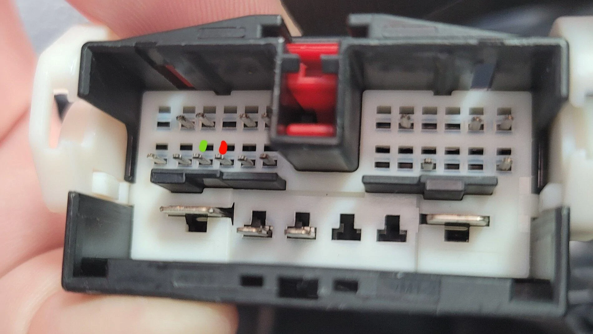

Just checking before I order a kit. I have a 2021 sport s. This is the driver body side plug. The needed pins are the ones I put dots by, correct?
Side note... pulling on this too hard won't pop the plug from the body... it breaks the clip on the back of the plug. Time for some velcro. Two days old and I already broke something ???
So...if your harness looks like this you just need to order the door handle and cap? or do you still need the wiring harness?
Like the other guy said
You still need the harness in the door but you don't have to do anything else on the body side.
