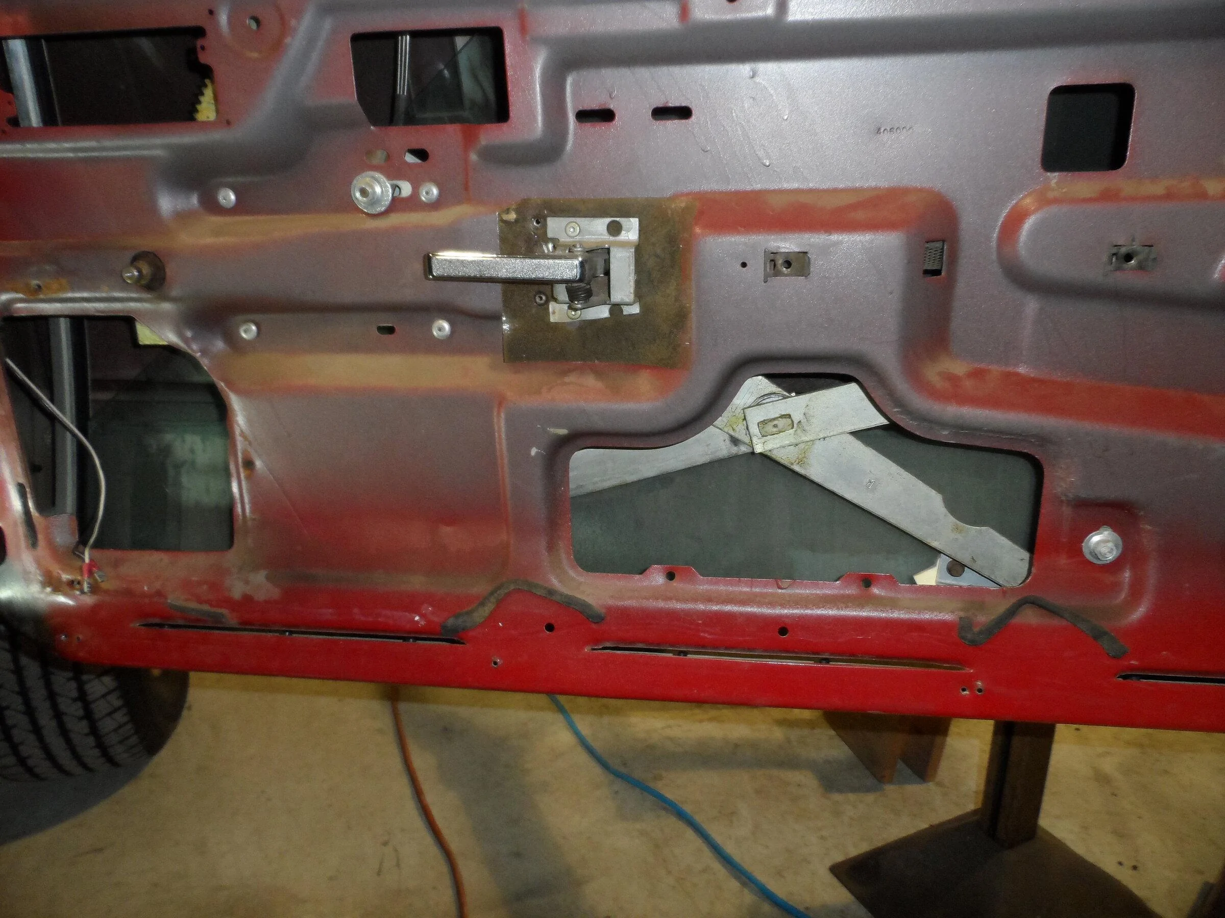

I would give it a # 2 out of 10 difficulty level .
Compared to other doors I've worked on and in - a 1 out of 10.
I've converted 2 cars with doors like this to power windows and power locks and added speakers. It involves the 3cable remote mirror system (3 mechanical cables from the control to the mirror in each door), replacing door latches, installing lock motors, replacing window regulators installing switches and massive wire harnesses from each door across the back side of the dash and more.
The glass must be completely removed, the door gutted.
Naw, the Jeep was a 1 out of 10.
