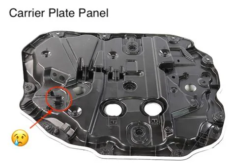

Well, it sure seemed like it was going to be easy-peasy after all the prep I'd done. But I should know better by now. Any time I undertake a vehicle project it seldom goes as I envisioned. :)
I did take my time and pause on occasion then dealing with a part that wasn't going "to plan." However, I guess I should have paused longer at some points. Ha!
Upon reflection, I feel I could have made a good portion of this process go easier had I taken the time to really examine all the parts in the door via exploded diagrams and descriptions to fully understand what all I was dealing with and how it all interoperated and connected. Doing that this morning helped me better appreciate some of the steps and overall system operation.
The step that caused the most consternation, and resulted in a broken tab/clip, was where the Carrier Plate Panel connects to the Latch Presenter. This set of tabs/clips would not release for anything and without it released, there was little room to get an arm into the door panel itself. Once that was free (in my case by releasing the lower one and sadly breaking the upper trying to get it to release) the Carrier Plate Panel was free to move about and access to the door interior was no problem.
Update: In continuing my post mortem from my experience yesterday, I realized I was so focused on the video walk-throughs folks had done, I completely forgot the PDFs contained in the link to the JL Wrangler forum post in the very first post of this thread. Two are techConnect exports and extremely helpful and address my trouble spot.
  • Door-Trim-Panel-Removal.pdf
  • Inner-Door-Plate-Removal.pdf
Jeep Gladiator Proximity door locks retrofit on Wrangler/Gladiator, someone figured it out (DIY writeup) fbf62fd4f5f5c902ad2ed3e7e4d02ac3.JPG
In any case, it is done, I learned a fair bit, and am hoping programming today is smooth sailing. ;)
And, of course, thanks to all on the forum who have gone before and posted all the great info as without them, I wouldn't have even had this option! :beer:
