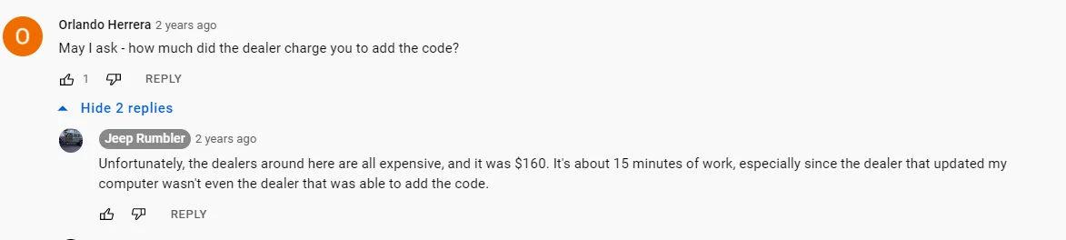

The comment from his video (below) is interesting - adding the settings takes only minutes, but adding the sales code to the VIN does take longer and involves an actual flash if they do it that way.
Two ways - manually make the selections in the system,
or,
have the sales code added to the VIN and then flash it - that makes the same changes that you make manually, but ensures that future flashes won't remove the settings.
(or do both - you make the changes using jscan, alfaobd, whatever, and then have a dealer add the sales code to your VIN)
or,
