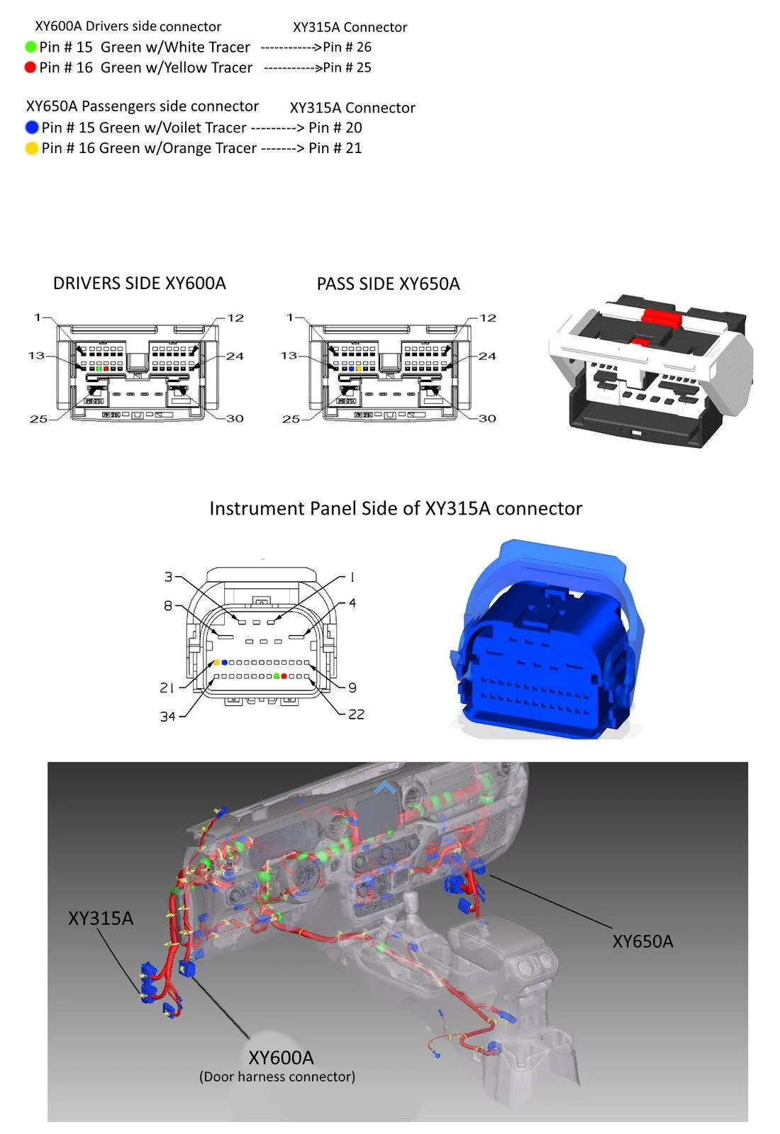

You can but custom wiring will be needed. Attached is a photo showing what needs to be done. I would search some of threads for any tips and shortcuts some other owners have been doing.
Please let me know if you have any questions.
Thanks,
-Benny
Do you know the male and female pin sizes for the XY600A & XY315A?
thanks

Sorry Jay we do not as mopar does not sell just the terminals. I know there have been guys who have been able to find these online, I believe through Molex? Might want to ask on the Wrangler forums as well.
- Benny
