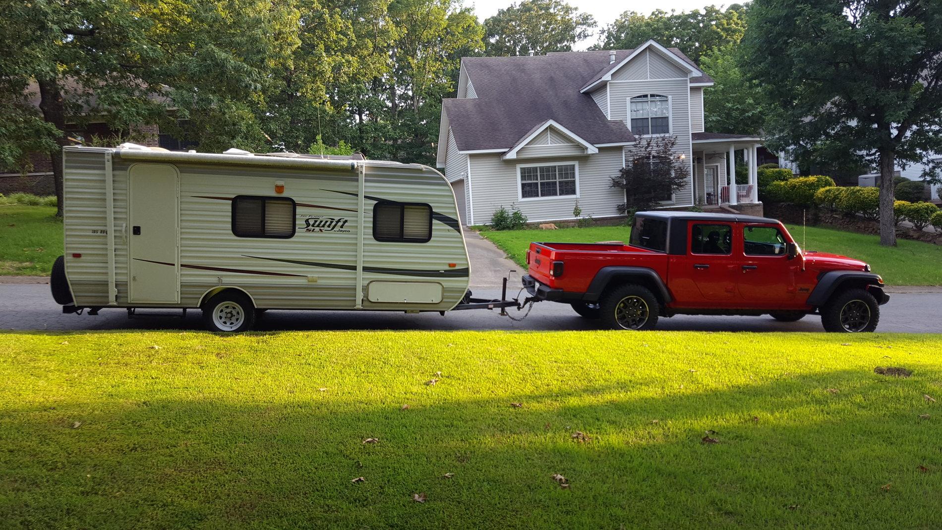

Let me first state that I've pulled this trailer with a Silverado 1500, Grand Cherokee Overland, and a GMC Canyon. My initial impressions:
1) I can't tell if the engine is struggling or if it just sounds like it is when accelerating and climbing. Seems to red line through the first 4 gears, but calms down once I hit 40mph.
2) Suspension is surprisingly better than I expected. Its feels more like my Silverado than the others. There's the typical bounce if I hit a bump, but it settles back in quickly. Way better than the suspension in my Hemi v8 GC Overland, but still a little squishy.
3) It brakes well, especially for not having a controller. Controller is definitely needed though.
4) The camera is hands-down the best in the world and I like that I can use it while moving if I need to check the hitch connection. Plus, the bed is so low that I don't even see it in my rearview.
Overall, it does what it's supposed to do. It may take some time getting used to the secret automatic tow/haul mode and the freakishly loud rpms at times, but I'm satisfied. Like others have said, I feel that it performs correctly, but there's still just a strange sense that something's not exactly right. I need more time, but I figure I'll eventually track down any deficiencies.

Can I ask the towed weight of the camper?
Thanks
originaldarin
Darin
May 20, 2019
59
Arkansas
2020 Jeep JT Sport S
Thanks
Hard to say exactly, since I load it up with a ton of stuff for different occasions. It's 2800lbs dry and usually another 1000 with stuff.

Do you have the max tow package? Or just the standard tow package? Looks like the drop on your ball mount looks to be more than necessary.
originaldarin
Darin
May 20, 2019
59
Arkansas
No max tow since I don't own anything heavier than 4k. Yes, the 6" drop is a bit low... of course I have a 0",2",and 8" hitch, but not the 4" that I need. Also, I've never needed a distribution hitch on my other trucks, but it may make a huge difference on the JT if I had one. I'll take a little weight off the tongue when I get the right hitch setup. If I feel any difference, I'll re-post.
