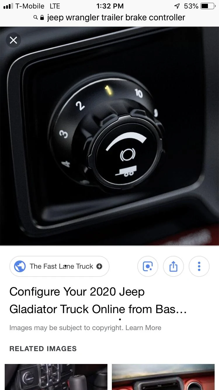

This is what was promised:
Jeep Gladiator Pulling a Camper upload_2019-5-24_22-14-31
That promise was broken and, no, I’m not drilling holes in my new Gladiator because “it’s super easy”.
I’ll continue pulling with my little Colorado with almost 50% more power AND a BRAKE CONTROLLER! ( so glad I didn’t sell it) until Jeep makes this right.

Looks the controller is back on the Jeep.com homepage, at least the picture of it.

Yes. The picture is back again. I keep hoping this is a good sign.
I’ve asked several Mopar parts counters and one summed it up rather concisely after showing them this picture:
“ I need a part number. If it doesn’t have a part number, it doesn’t exist”.

I just contacted Jeep and they knew nothing about it. I gave them the link and they verified that the picture was there but confirmed that no trailer brake controller was available. (?!).
Too weird. By the way. The tube doors seem to have disappeared from the Mopar website as well. I would have liked those.
