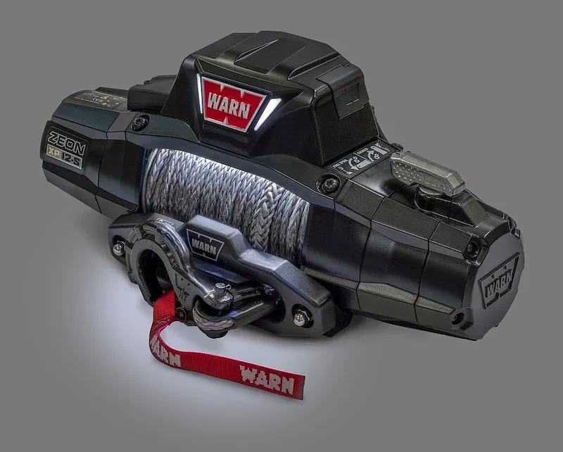

Also, wench:
Jeep Gladiator Questioning my life choices ....  (not really I'm a doer not a thinker) 1779932846027-cu
winch:
Jeep Gladiator Questioning my life choices ....  (not really I'm a doer not a thinker) 1779932923316-i
