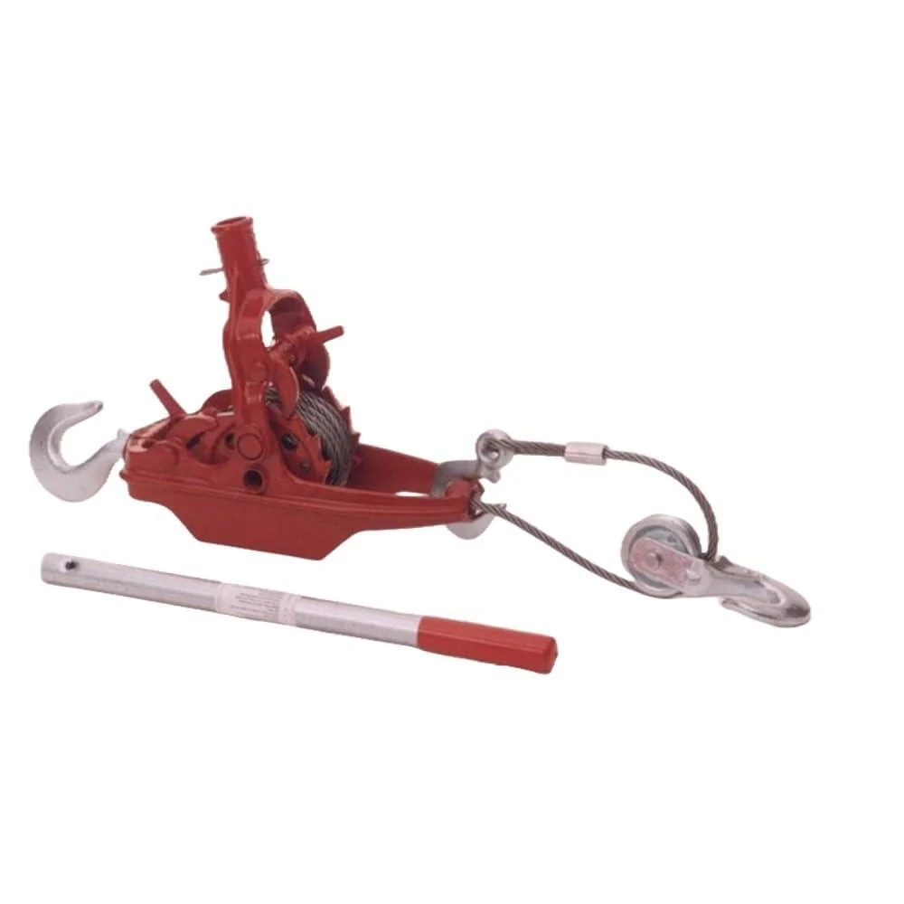

For the longest time, I only had a hand winch in my trail vehicle. Granted it is a Wythe-Scott "mausoleum lifter" so not some cheesy "cum along". But still....slow AF!!! But I was amazed at the times it saved my (or somebody else's) ass. Still got it and use it occasionally around the shop.
For all it's drawbacks it has several key advantages in that it's portable to help the guy 6 rigs in front of you and can be used to winch sideways, backways, upways, anyways. (and "yes" - have used it to do all those things over the years)
What you need and what you want are not always the same thing. Something as simple as this can absolutely get you home. If you are creative and patient.
(NB just looked online to find the below pic - holy Hannah these things have gone up in price. Think I only paid $125 for mine approx 20 years ago. Such is inflation, I reckon.)
Have one, saved me once. Also used it a few times around the home.
One scary thing about them is to get full power out of it you have to straddle the thing and pull hard for each click. If, in theory, the cable breaks, you could end up being sliced lengthwise. But the handle is supposed to bend before the cable breaks.
Anyhow, paired with a land anchor, tree saver, extra strap, etc., they're very useful.
All true. ( 'cept I never found myself straddling mine - YIKES!)
But anytime you're worried about a cable snap (either hand winch or electric for that matter) a good safety tip is to drape a floor mat over the cable. If it snaps, the weight will steer the force downward toward the ground rather than flying through the air.
Straddling a winch (any kind) with metal cable .... my first safety consideration would be a kevlar jock strap.

Well the front had sunk to the axle in Utah clay at the side of a river. (Actually, 20 feet or more from the river, but that's how far the soil was saturated!) By the time it was out the land anchor had burrowed entirely underground before it got enough traction to move the truck a slight amount per click. Each click was a hard pull on the handle. When done I had to dig out the land anchor.
If I were to do it again I'd try to dig out from behind the tires before starting.

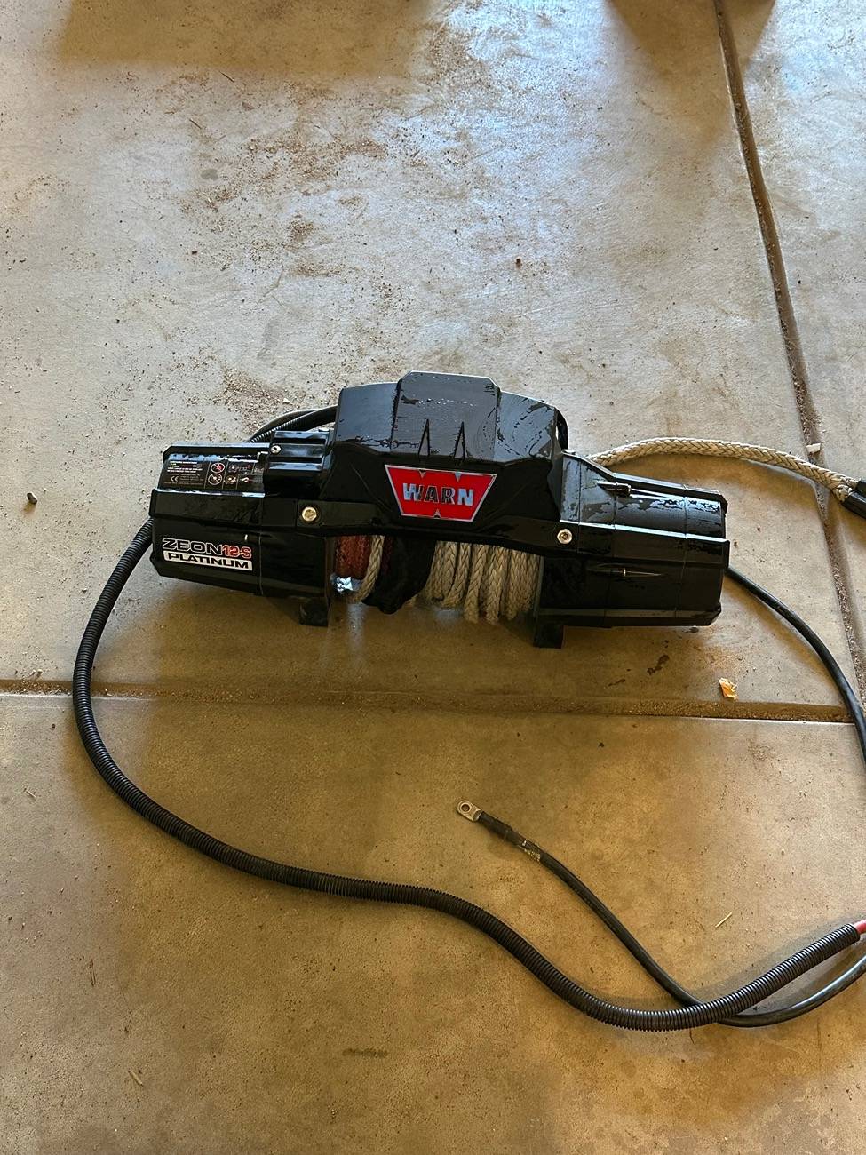

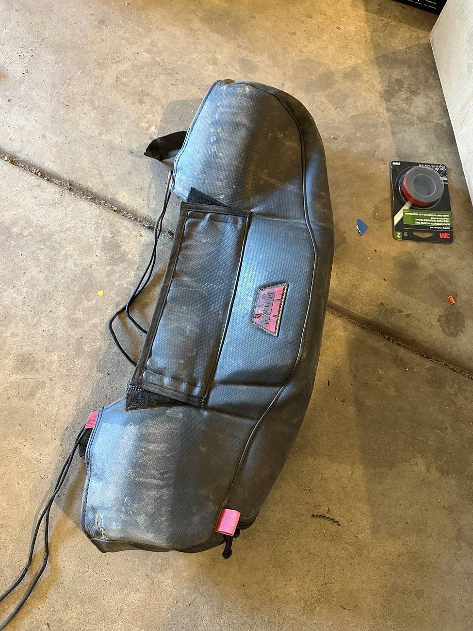

I’ve always covered my winch. I personally love it. After three years mostly parked outdoors, this is how my winch looked when the old cover came off. Cover looked terrible, but winch looks brand new. So new cover when it went on the new bumper. And it keeps the sun completely off of the synthetic line.
[/QUOTE]
I love my Rubicon knock off bumper, But this one is B.E.A.utiful!!!!
Oh and the Badland Apex is waterproof, so no use frettin over one. carry on....

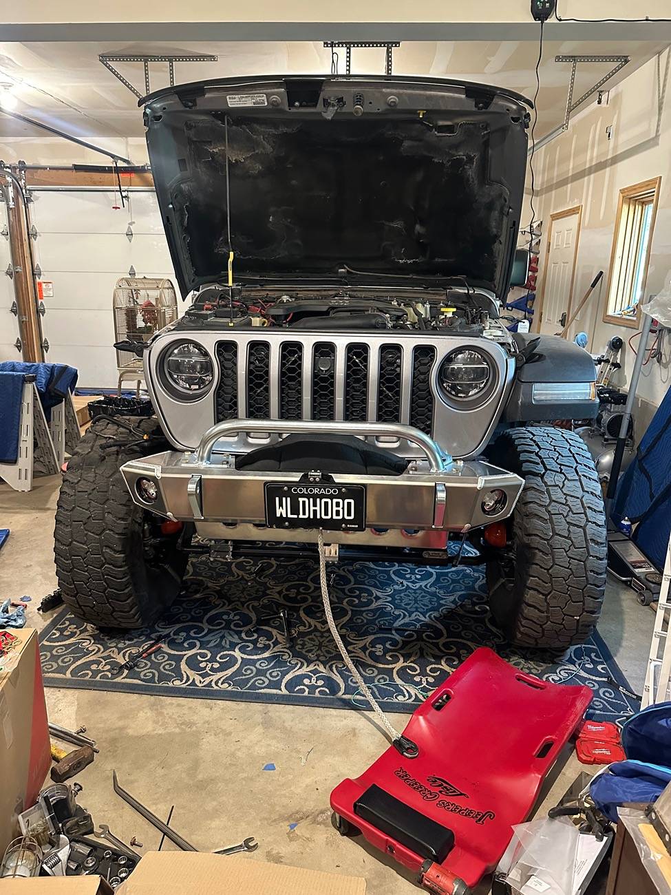

[/QUOTE]
Don’t get this bumper with the badlands. It’s allegedly too deep to fit. It was tight as hell with my Warn. Also waterproof, but I like the sun off the line.
