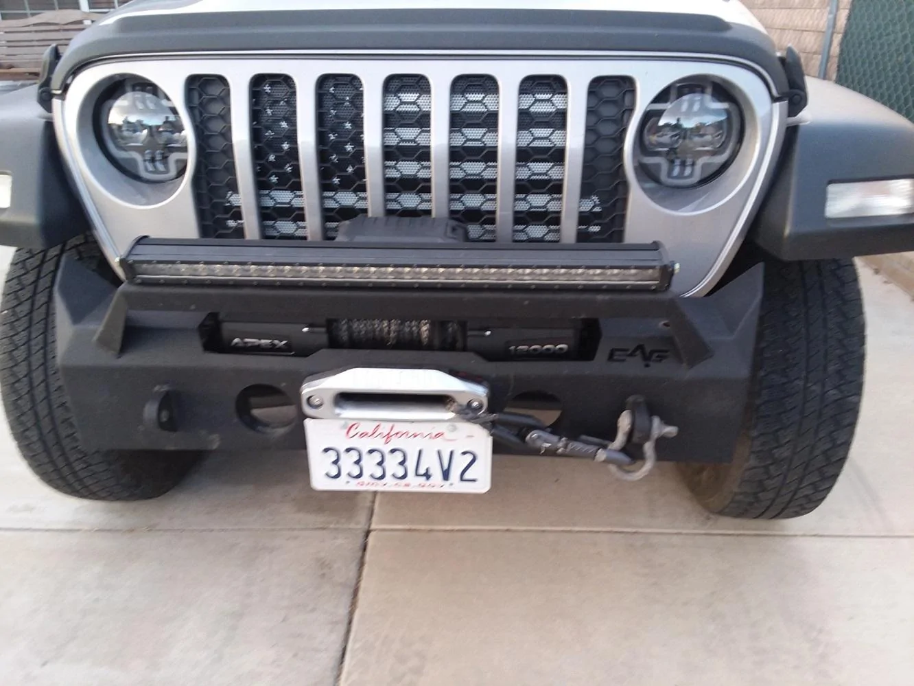

EAG bumper and Badland Apex 12K. The bumper was free so that made the decision easy. I waited until the Apex was on sale. I like that it is all-in-one, with wired / wireless controller and battery cutoff. It is a big winch. I had to trim some of the bull bar to fit the control box (did not want to relocate it). And I need to put some spacers under the light bar to get it pointing back level. The winch also sits right up against the top of the bumper's fog light cutouts, so I have to figure out how to install them, or get a smaller replacement.

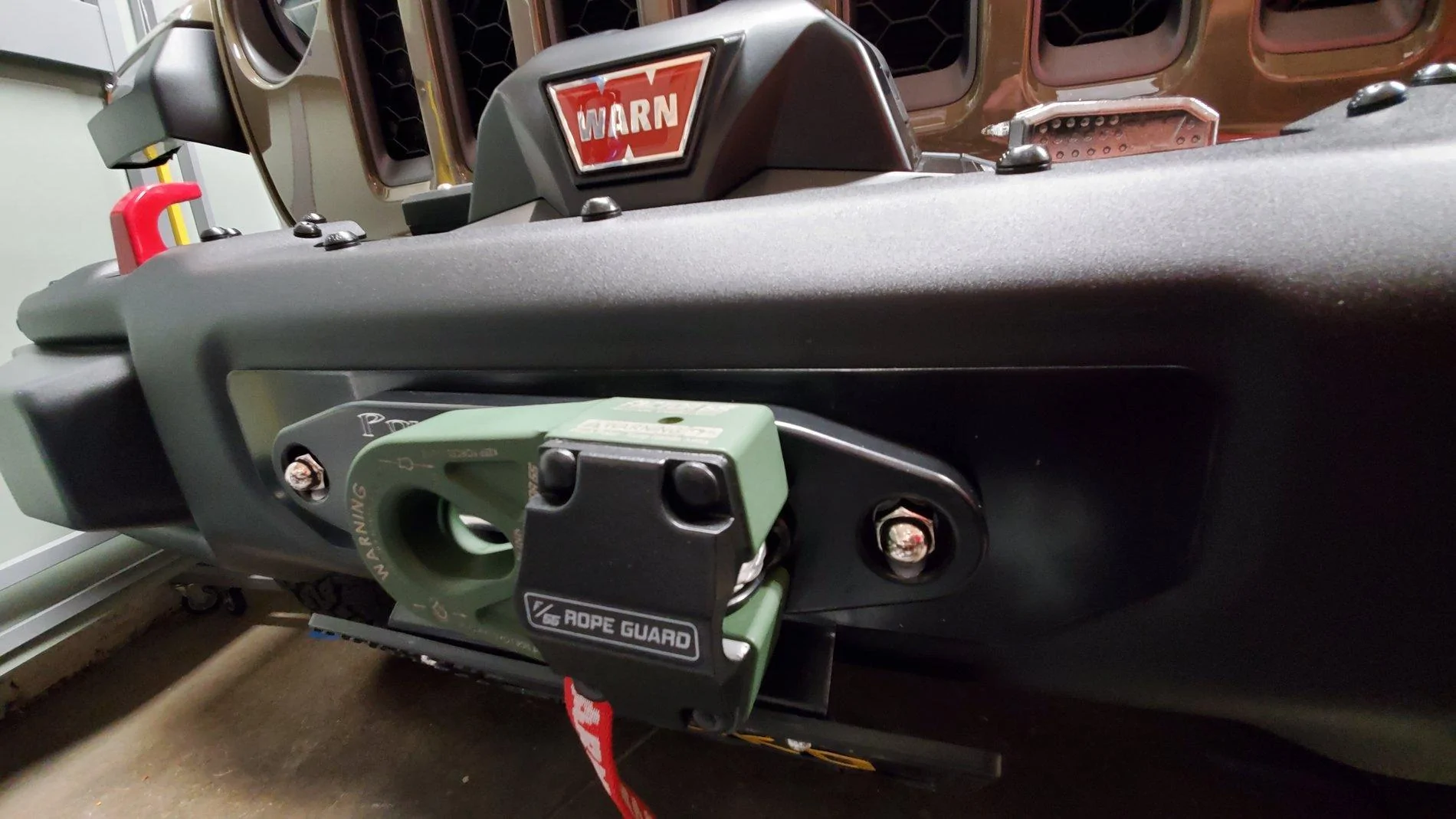

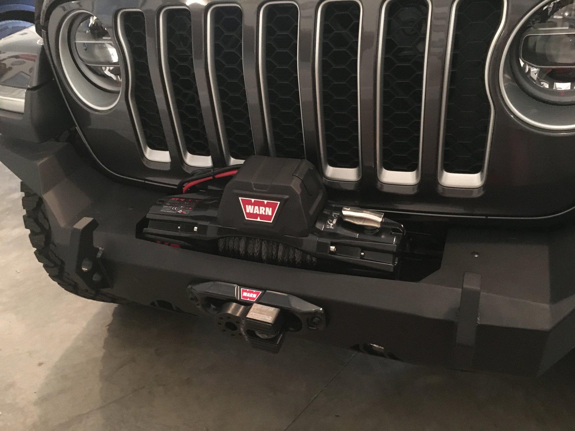

Warn VR EVO 10s sitting on an Artec winch plate inside factory steel rubicon bumper. Synthetic line finished with a Warn hawse fairlead a factor 55 ultrahook.
i went with Warn because Warn has gotten me home before. I picked Artec because the tray was thick and boxed and I like how it mounted. Factor 55 got the nod because it can do it all on one hook and can assure a closed loop system or allow an open hook but with a safety pin when needed.

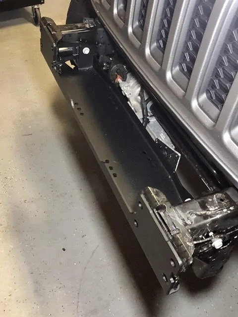

The Artec site says that their plate doesn’t work with the VR series. Did you have any issues with getting yours to fit? I got a VR Evo 12-S from Santa and can’t seem to find a plate that is both tough doesn’t require some shaving of bits.
Silvertruck
May 25, 2020
452
907
Birmingham Alabama
2020 JT Rubicon
its a tight fit but i had no issues. Recommend bench mounting the winch to the plate and having a friend help hang it on the frame.
*edit - i went to the website and saw the exclusion. It may be that artec changed the design since i installed mine during first half of 2020. I would call them first. I have had no issues but I dont want to steer you wrong. I dont think this exclusion was present when i installed mine.

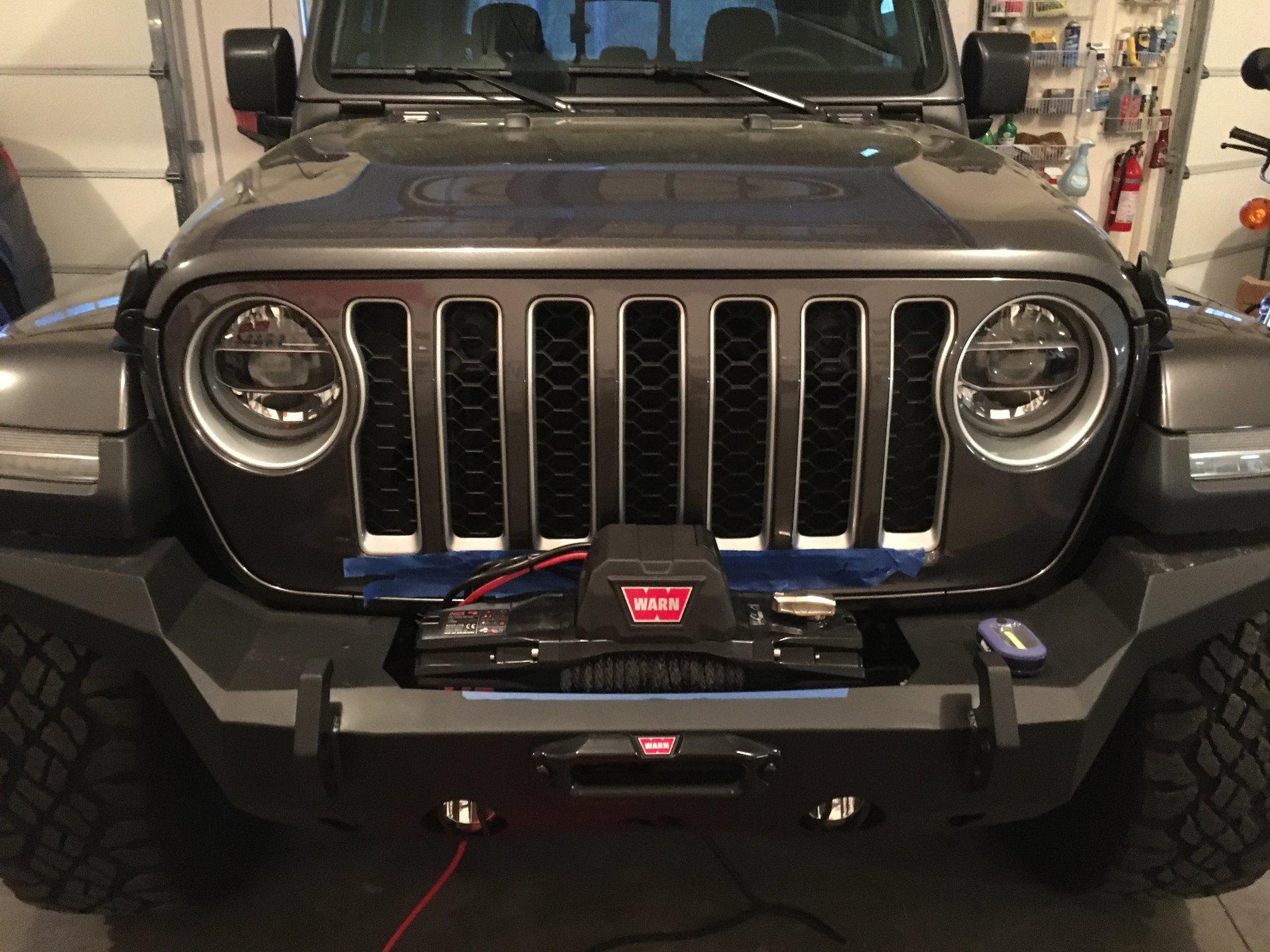

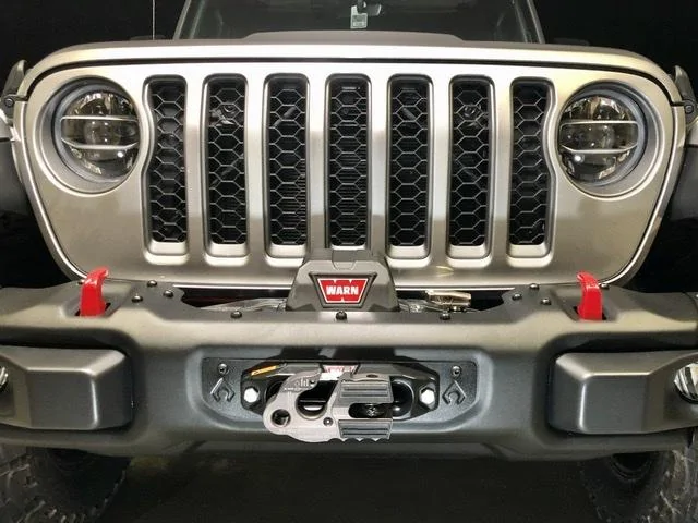

Warn VR 10S. Vary tight fit on the RR HD.
I have the same setup. It is very tight. You can’t remove the grill without unbolting the winch, and sliding it forward in the bumper.

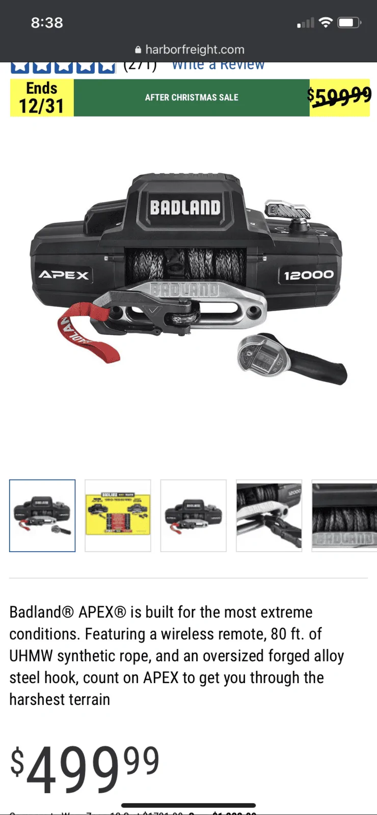

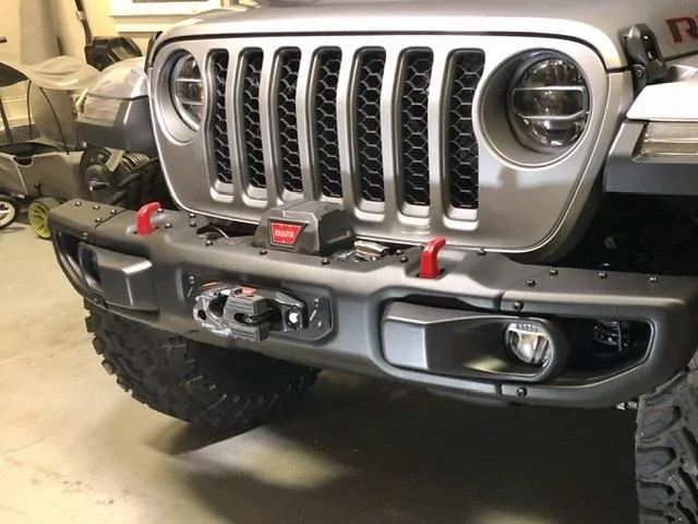

Warn VR Evo 12s, Warn winch plate, stock steel. I’d probably not get the warn again, I broke the remote cable (it’s wireless but has a cable to also operate wired). And they want like $80 to replace the whole cable and remote combo. I just need the wire and they can’t seem to figure out how to just sell that. Also they said their battery in the remote isn’t rechargeable but it’s totally a LiON rechargeable and the cord provides a current to charge. Feels like they don’t know their own product.
For as much as I use it I’d probably get the new badlands apex since you can get a new cord at almost any harbor freight!

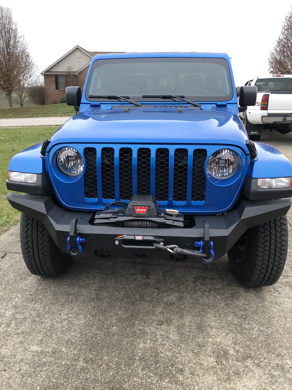

I'm using the Warn winch plate.
Thanks. Parts are so freaking hard to come by these days and I stumbled across a 12S. I wanted the 10S But I can’t get a hold of one. Everything fit fine in the sock bumper?
I had a Zeon 10s which I pulled and put in the Zeon 12s, both are exactly the same dimensions. No issues at all with stock steel bumper.
