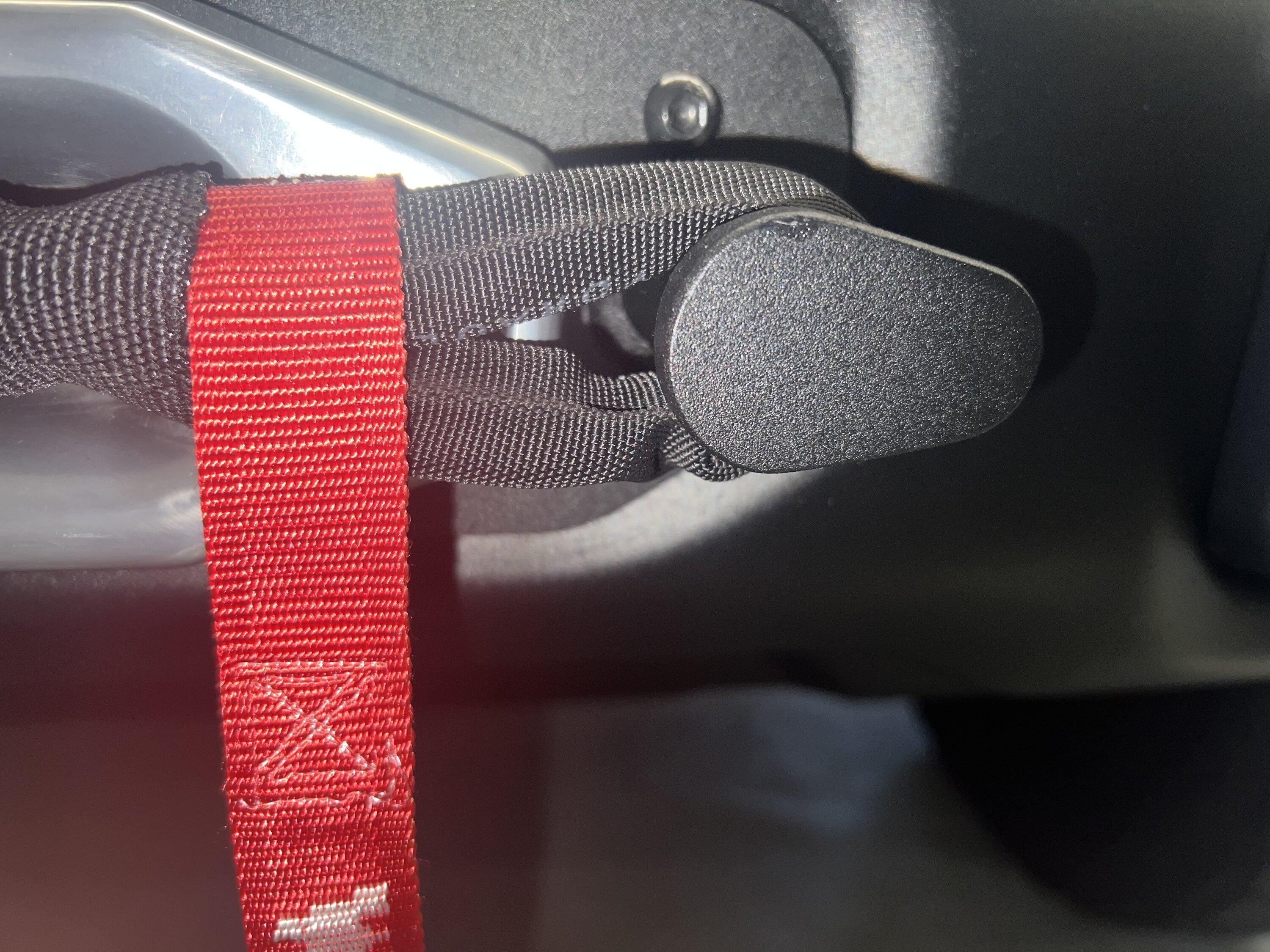

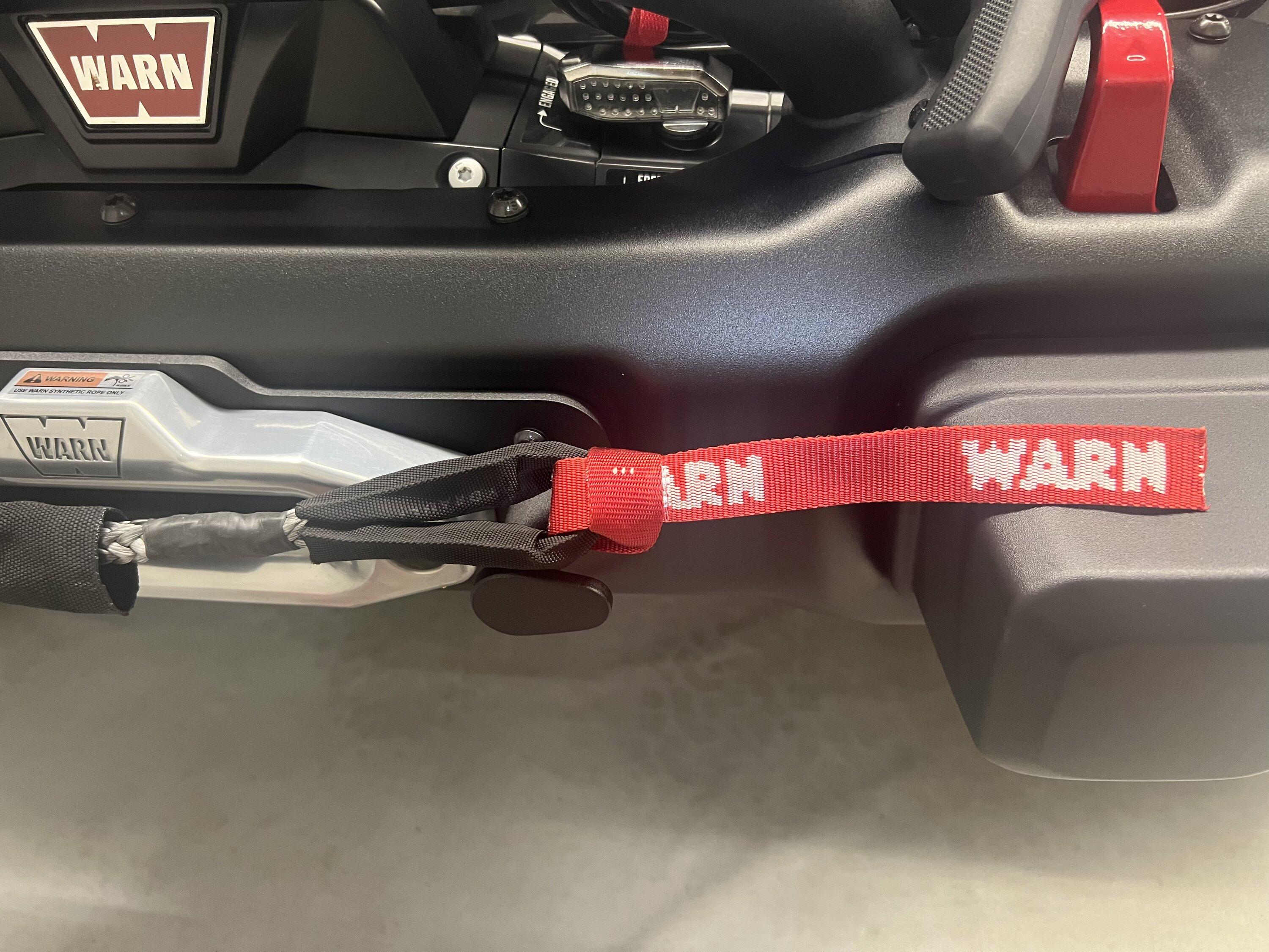

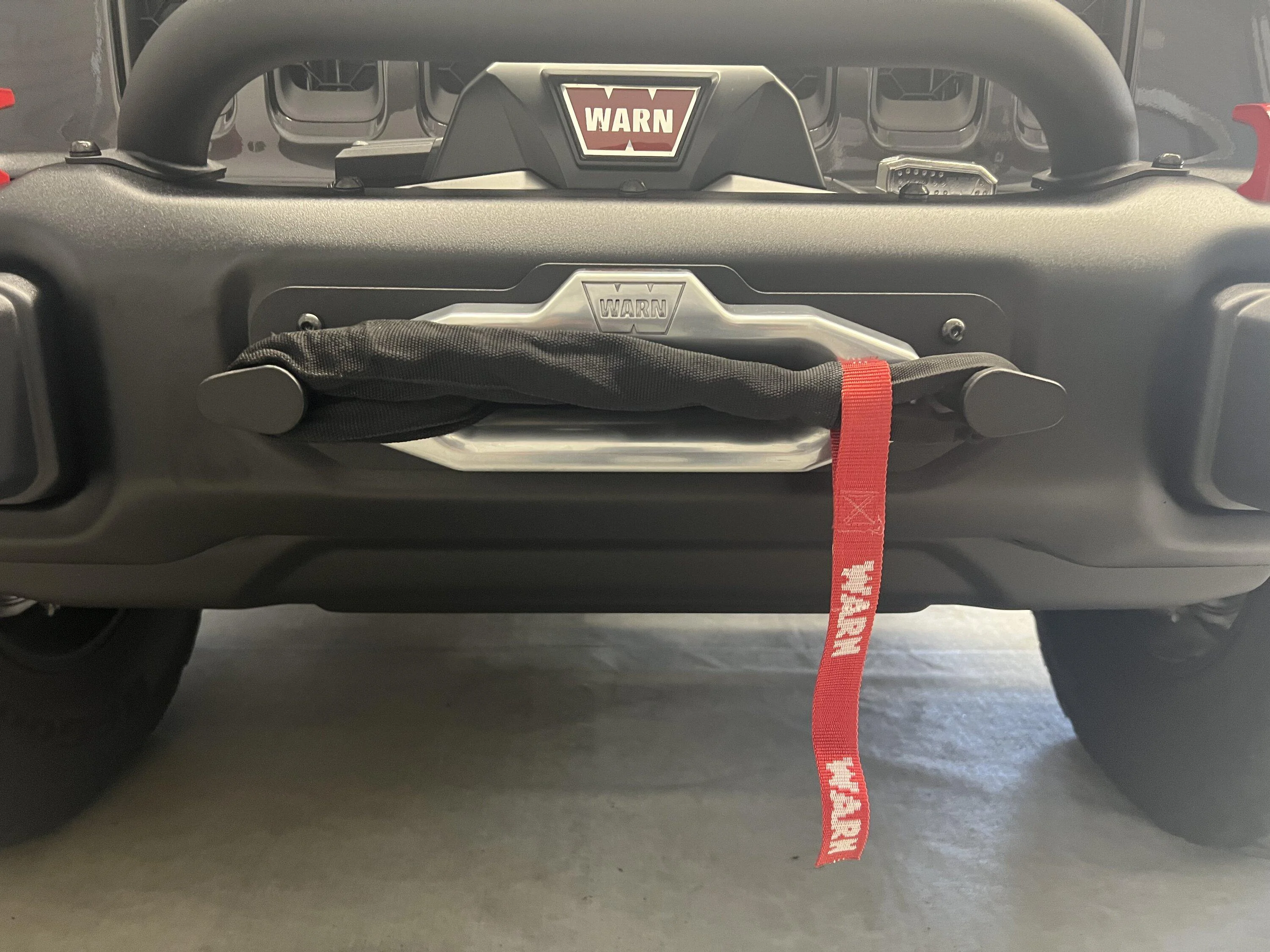

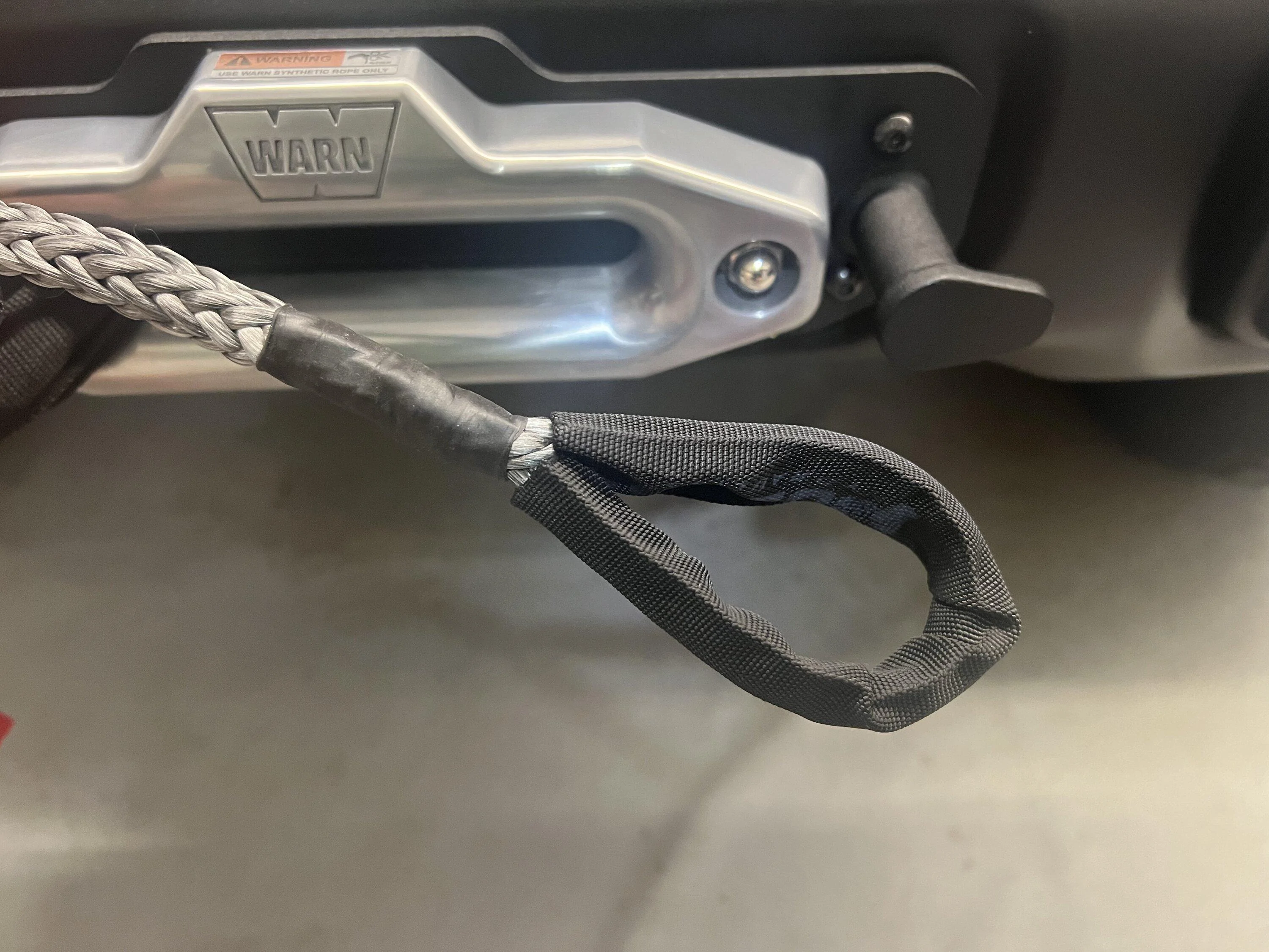

I finally did some work on my winch shackle… or shackle alternative I guess.
I removed the Warn factory hook and thimble from my ZeonS. I replaced it with a 10” length of 3/4” abrasion sleeve and spliced a closed loop. The abrasion sleeve prevented me from doing a proper fixed end locking brummel, but I did the double weave and bury the tapered tail method I see commonly used. I used a rubber sleeve wrap to keep the weave locked when slack.
I have a Maximus3 hook anchor. My system pretty much mimics the Yankum setup…. which I probably would have gone with if I had known about them earlier.
Regardless, I’m pretty happy with the look and like having the abrasion sleeve on the loop as well.
This looks great. Can you link to the sleeve you used? 3/4" tubular webbing is way to small, 1" can just barely fit, 1.5" would be comfortable but it's pretty rare, 2" is oversize and loose. Abrasion sleeve must be measured differently than rock climbing style webbing?
Any links to the weave and bury method you used? I'd like to copy this basically

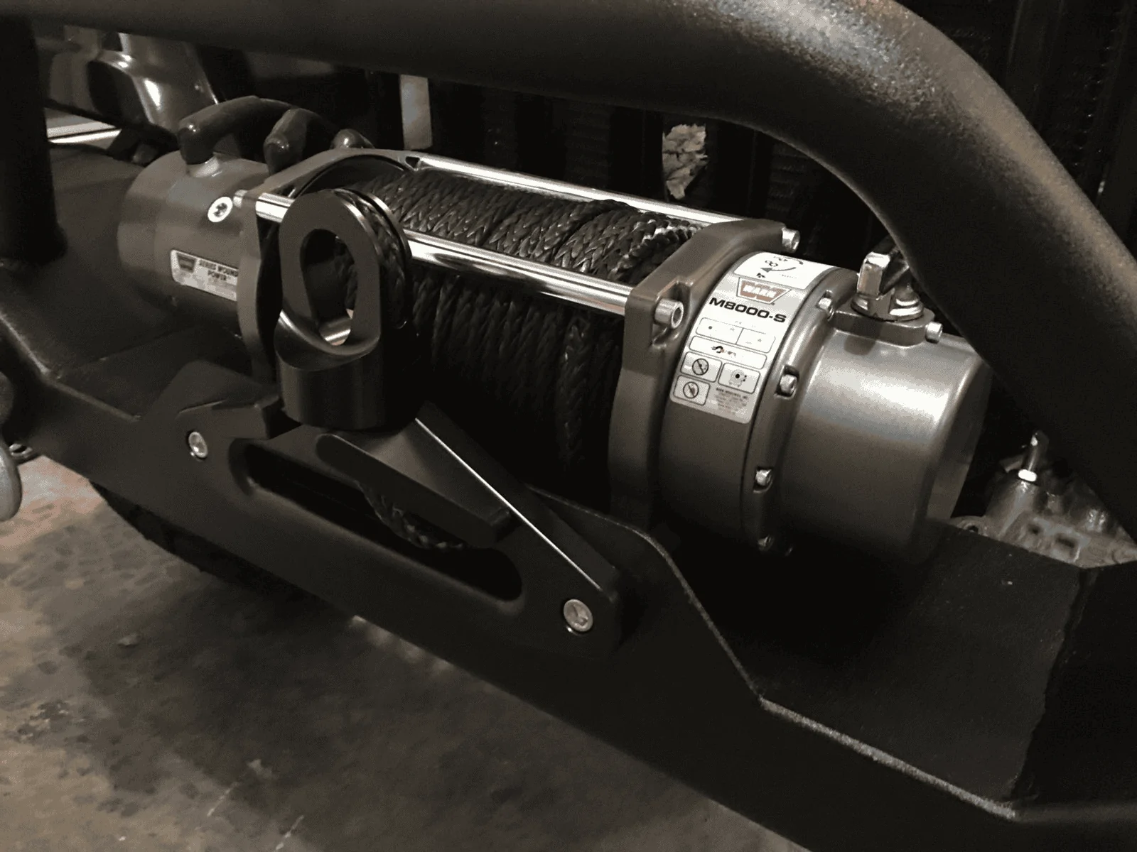

I'll be going with the TRE Safety Thimble and its matching fairlead... the safety thimble is a better system, as it eliminates the pin that Factor 55 thimble uses to attach the thimble to the line. The fairlead stowes the thimble out of the way of rocks and other obstacles.
The sleeve I used for the loop portion was sourced from Northern Strands, a local industrial hose and cable supplier. I measured it, and it is actually 1.25” flattened diameter. Pretty sure they called it 3/4”…
The larger sleeve in the first pics is the included 3’ Warn sleeve which measures ~1.75” flattened diameter.
I measured 10” for the loop, plus 24” for the tail, which included 8” of tapered tail. I wrapped the splice in rubber tape rather than heat shrink so I could redo it if necessary.
The link for the splice method is:
and also:
Note that the anchor plate I have is the Maximus3 which is very sturdy. The Warn hook anchor plate is very light duty and will bend when torqued down so don’t recommend it.
Some closer pics of what I did:
Jeep Gladiator What winch shackle are you running? 7652DD02-B381-4015-8966-2D33BE6AF599
I left the red webbing separate so I could remove it or attach as shown.
Jeep Gladiator What winch shackle are you running? AE9118EF-84B2-4DF3-AFF0-EC4BEB10EFD7
Jeep Gladiator What winch shackle are you running? 77B7484C-62CD-4297-9E42-E943868C2240
Did the same. They're pretty outstanding other than the fact they leave the line exposed to the sun. I still prefer the design because they are stupid easy to repair if needed and have the fewest points of failure.
