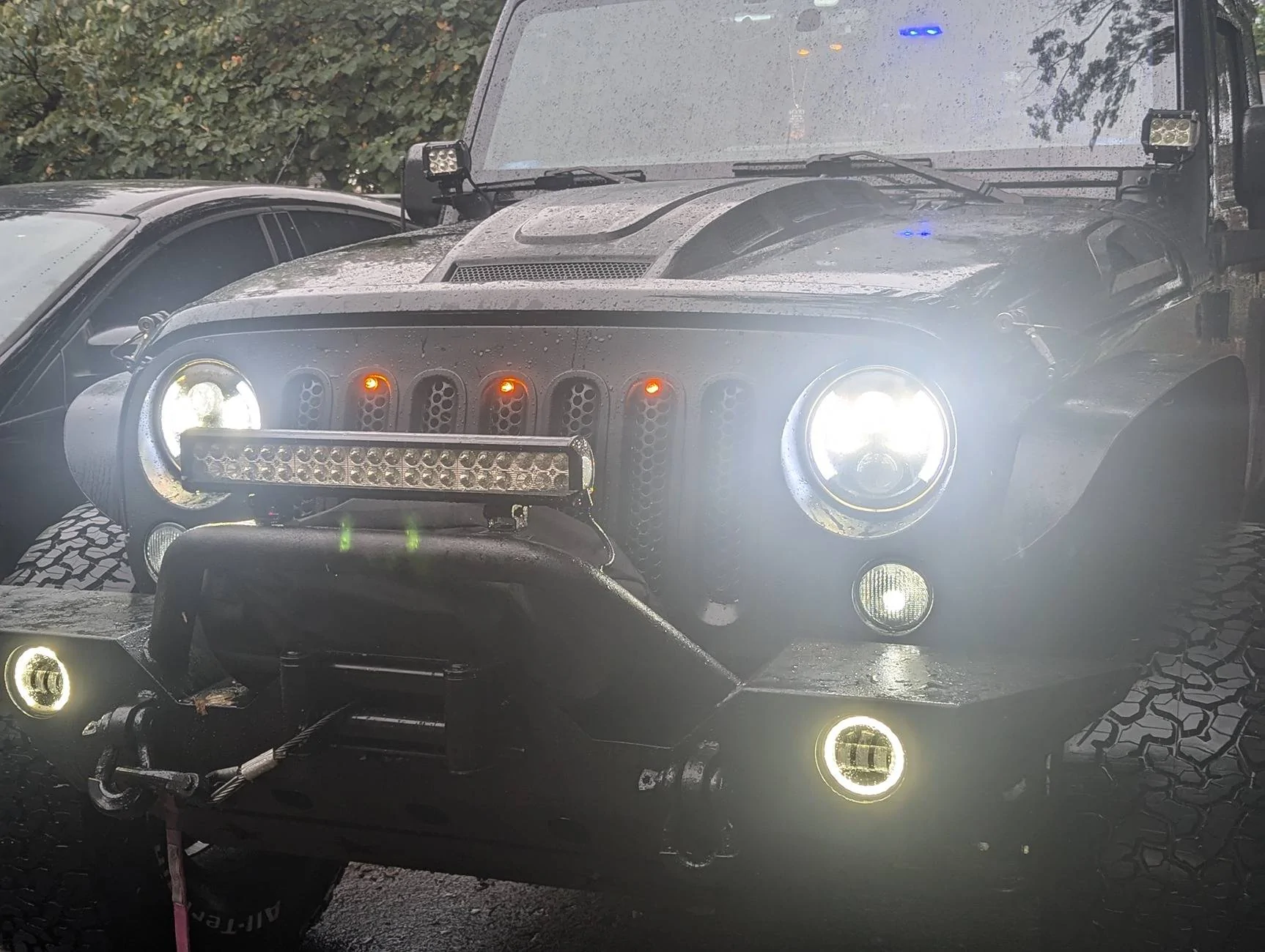

The problem with aftermarket bumpers is that the winch mounts to where it is directly in front of the Grill blocking airflow to the cooling system. Not all mind you but most do! I ran into that on my JK that I traded in for the Gladdy.
There as SO MANY aftermarket bumpers with sunken winch plates. So many. Some are designed for top mount, but certainly not close to all.

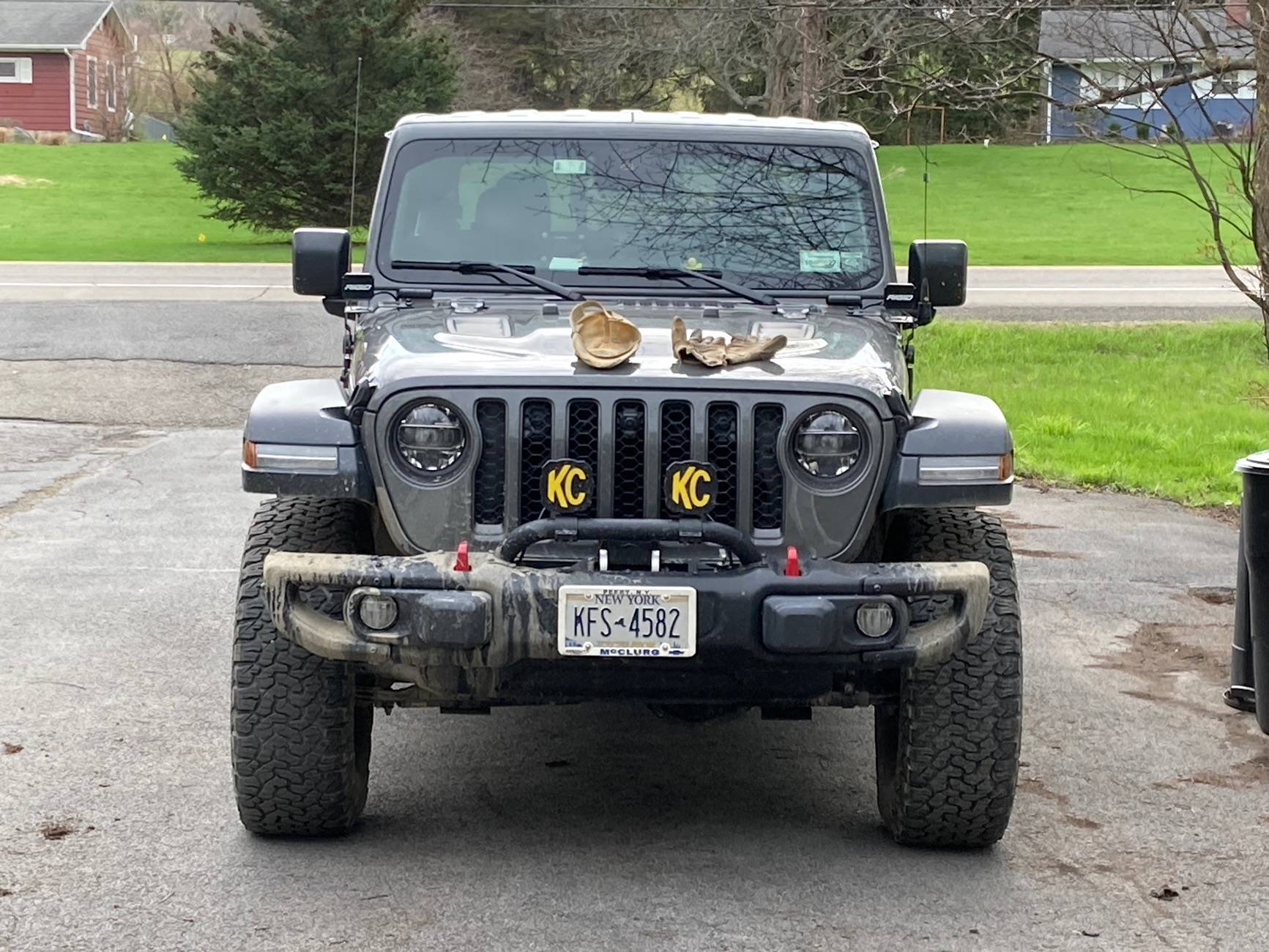

Just adding my use for some added intel …
I have a JTRD that spends half the year set up for travel camping with a rack, RTT, fridge and kitchen. I use a 10k Smittybilt with synthetic line because that’s what I had in my previous rig and I just moved it over. Mopar steel bumper. Mopar winch plate. I’ve never had a problem, but I’ve never had to pull myself out of anything. I do a lot of trail rescues for folks who get in over their heads, and pull a lot of downed trees off remote trails. So far, no issues. Snatch blocks at the ready just in case.
That said, given my weight, I’ll likely nudge up to 12k when it’s time for a new winch. Size and weight aren’t too different, and I’ll sleep better with the extra margin for error.
