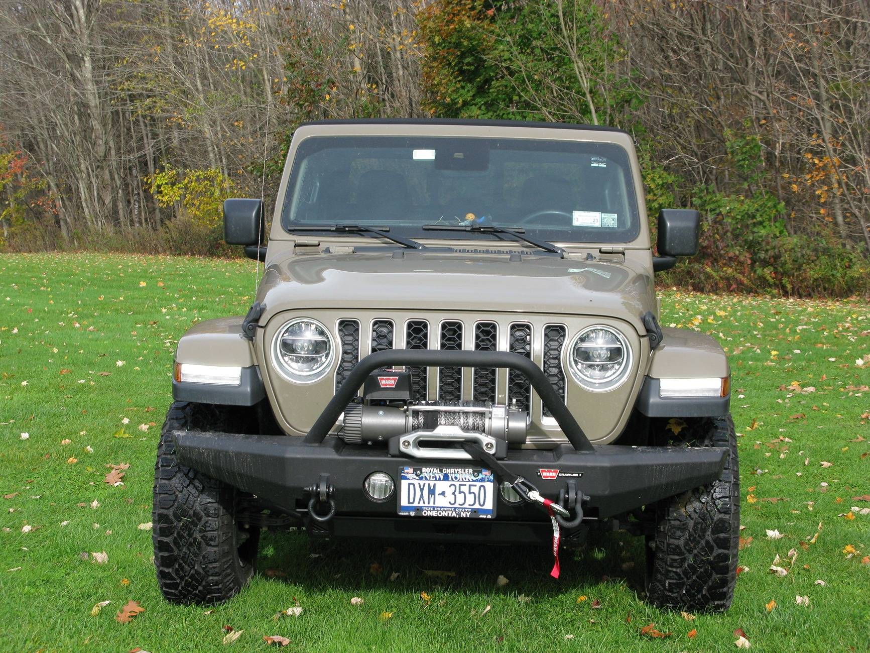

My first personal 4 x 4 but I always felt that if you had 4WD you could get stuck in more inaccessible
places, so a winch was a must. Now my intent here was self-rescue more than lending a hand to
others, which I would if the occasion arose. So after swapping on a Warn full-width Crawler bumper
I added a Warn 9.5xp with synthetic rope. To that I added blocks, tree strap, soft shackles, rings, blanket etc and a short book on rigging. Also a couple pair of traction boards (use these once each winter)
, also suggest a Hi-Lift jack. My thought is if I can't extricate myself it's time to call for help and a bigger winch wouldn't make a difference, then again I travel with light loads. Prepare for the worst, hope for the best.
