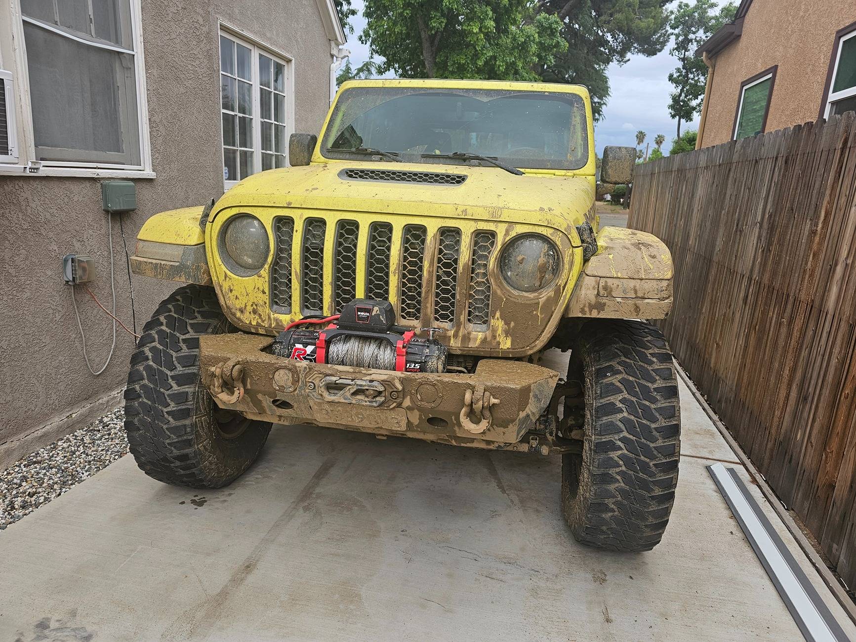

The problem with aftermarket bumpers is that the winch mounts to where it is directly in front of the Grill blocking airflow to the cooling system. Not all mind you but most do! I ran into that on my JK that I traded in for the Gladdy.
Some of them do for sure block airflow. The rock hard 4x4 mount for the stock plastic bumper is literally a winch plate that mounts on top of the bumper putting the winch way too high for me. My bumper mounts it pretty low so I'm happy with it. I think the Mopar bumper with a plate is slightly lower but not enough to matter. (I run a winch cover to keep the synthetic line out of the sun but had to winch a guy out at the end of the day which is why the winch is so clean)
That is awesome example of a low mounted winch on a aftermarket bumper!

Yes it is - and it's not any problem to air flow at all.
And it was $400 and included the led fog lights. The xbull 13.5k pound winch was another $400. $800 all in and I've pulled well over 10k with it with no issues, deflection, stalling, etc.
