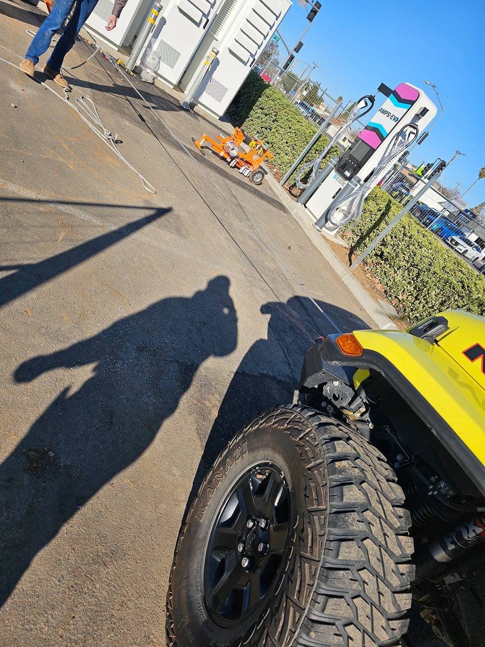

Everyone who runs a tiny winch says "just use a snatch block...or 2. That's 16-24k pounds. As far as bending the frame, maybe if you bolted the middle of the frame to something and started winching upwards at an angle? In the real world most of that force is on the axles, tires, etc that are what's stock in the mud anyway. Sure in a straight line pull a winch with more power could do more damage, add a single snatch block to an 8k and it's pulling harder. Rarely do you need a 12k+ pound pull, but often you'll find an 8k stalling out in my experience. Again I'd rather just hook up a straight pull to the nearest solid anchor and be on my way. I'm pretty sure the bumper on my rig said up to a 14k pound winch. The power wagons come with a 16.5k pound winch if I remember right. Better to have and not need and also a straight pull is safer than a multi- line pull. Clearly I have actually thought it thru and have decades of real world use that has me running a large winch on purpose. We were snapping the 10k pound rope in the pic below, dragging all 4 wheels on dry pavement, and 0 deflection in the bumper or frame. No a 13.5k won't rip your bumper off.
Jeep Gladiator How big of a winch do I really need? 20250211_091056
