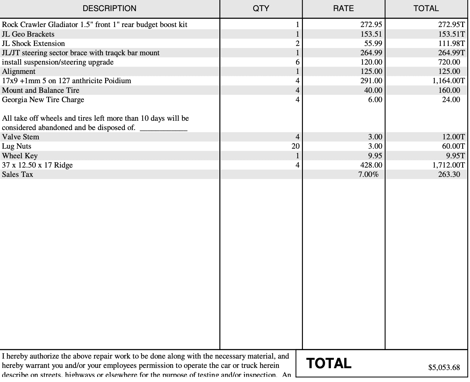

I have a 2020 Gator Green Gladiator Rubicon that's stock at the moment. Got a quote from a local shop for a 2" lift and 37" tires and wanted to get your thoughts on it. I asked if the steering stabilizer needed beefed up at all with the 37s and they added the Steersmart. Not sure that's actually a stabilizer, but just started reading about that and if it's necessary. Drives straight as an arrow now without much play on the stock 33s. Also, another local shop said 37s would rub with the 2" lift, but from everything I'm reading on here, I don't think that's the case. Would appreciate any thoughts / input on this quote and adding / removing stuff. Thanks in advance for any help.

Thank you all for the feedback. I talked to another local shop this morning and they sent this over. Said the Mopar lift was overkill for what I was looking to do. The word "budget" scares me when it comes to mods on my Jeep. I've heard a lot of good about the ride improvement with the Mopar lift though which I wouldn't mind.
Yeah, this had me worried as well. I was expecting the fox stabilizer or something like that.
I would avoid this shop. The package they are putting together doesn’t make sense to me. Geometry brackets with less than 2ā€ of lift? Shock extensions with 1.5/1 spacers? Why a track bar brace at this point?

Budget lift is fine if you are only going for appearance and do not plan on going off road. You are looking at doing mild off roading, get the lift kit and be done. I would do the sector shaft, drag link support if that is what they are referring to as the support. With larger tires and going off road you are applying a lot of torque to that area of the steering gear box and frame side track bar mount when turning. Also get the adjustable track bar to guarantee the front axle is centered. I am concerned with the wheels. You say they have 5" of backspace? In my experiences you need no less than 3.75" of backspace to keep them from rubbing on control arms when fully locked in a turn and tire, wheel stuffed. Now if you are planning on using wheel spacers then that can be corrected.

Seems reasonable. the only caution I would have is on the wheels. I was pricing some rims and the good ones seemed to be all over $500 each.

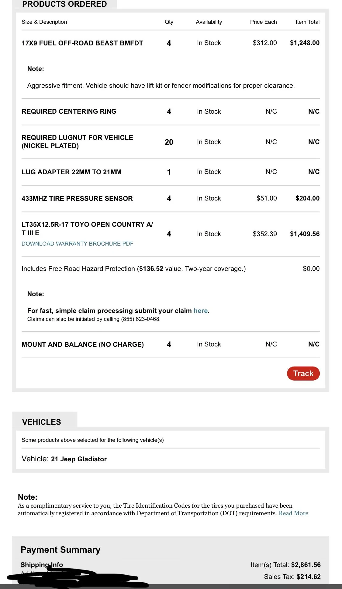

I had the same lift delivered to my house by JustForJeeps for about $70 less than your lift quote. I installed it myself with help from my wife and or son on a couple of steps. The lift is amazing and rides like a dream. I also installed a Synergy track bar and sector shaft brace. I'm guessing that is similar to what they are quoting you. I installed a JKS front track bar to re-enter the axle. It was needed. Again, easy install. I also have similar wheels as you were quoted except I have the 4.50 inch backspacing. I have a little more poke than you will, but ample room for tires. I'm running 35s. I hope this helps some
