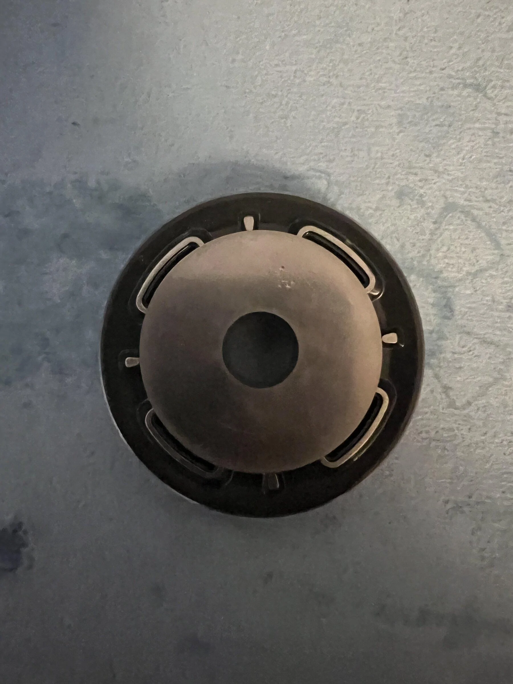

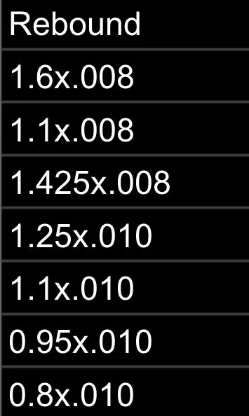

Jeep Gladiator Reaching out to those doing their own shock tuning? F7823D3D-B965-4676-8D06-42E913EAED9C
here’s my rebound stack. They went with the second lightest Fox lists (#35) and made it softer by adding one flutter shim to the already light shim. I ordered #70 and #85 kits, two each.
I am a bit confused about that compression bleed shim. It looks like it could be set in place in any orientation, and thus altering the result. What keeps it from turning?

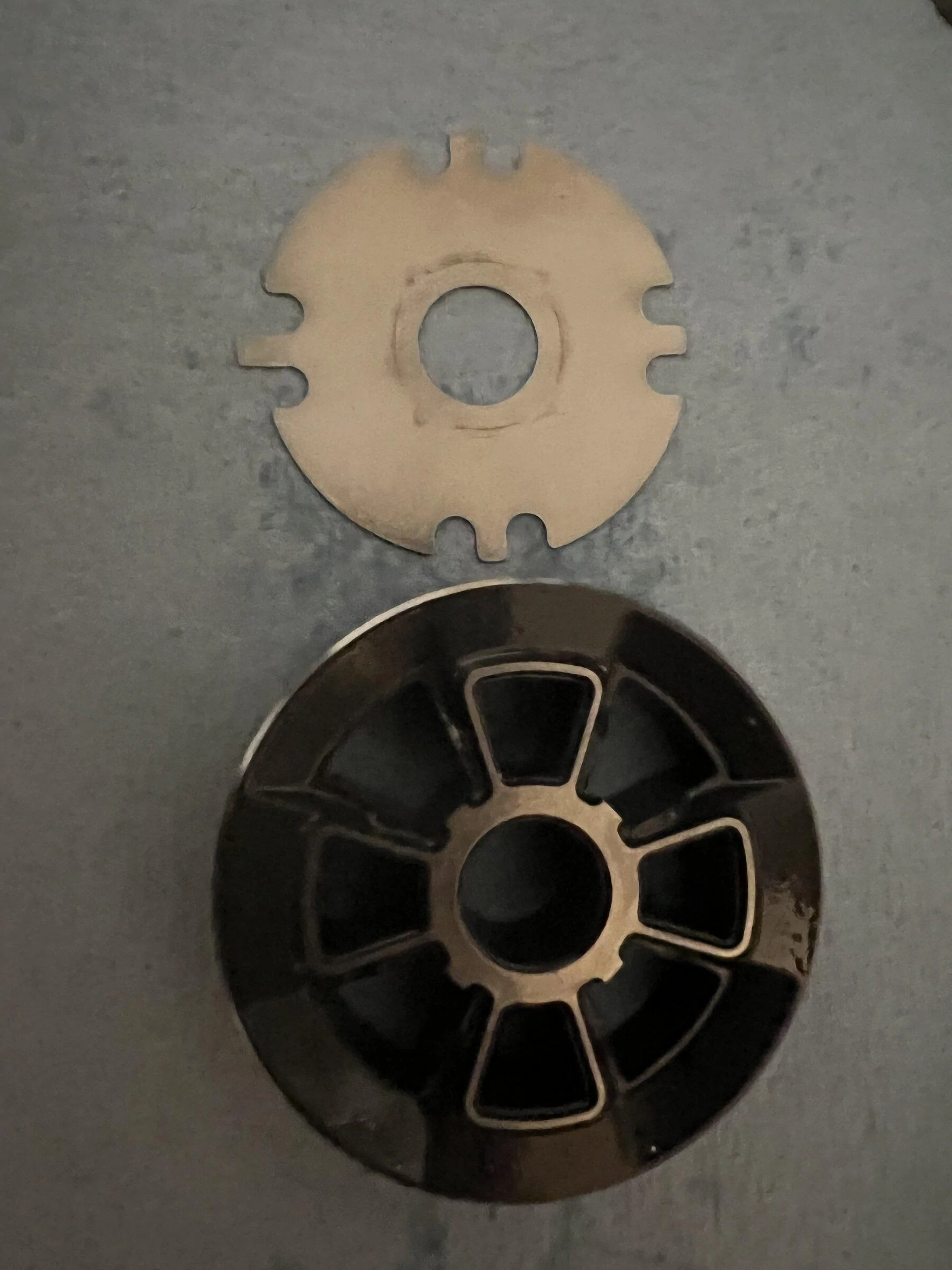

Jeep Gladiator Reaching out to those doing their own shock tuning? 80715769-1743-4614-9E70-D196C77C69F1
the pistons were in upside down. It’s obvious by the marks on this shim that it was on this side of the piston. But this Is the small diameter side. So with the large diameter side facing the smaller rebound shim, I had no rebound damping. 100% open.
Jeep Gladiator Reaching out to those doing their own shock tuning? DAB02362-FE90-4580-983C-DE964EB50348
This is the first rebound shim sitting on the compression side of the piston. So no rebound.
Wow! Thats way lighter than the stack that Fox ships with combined with the flutter........
The bleed goes on the comp side....

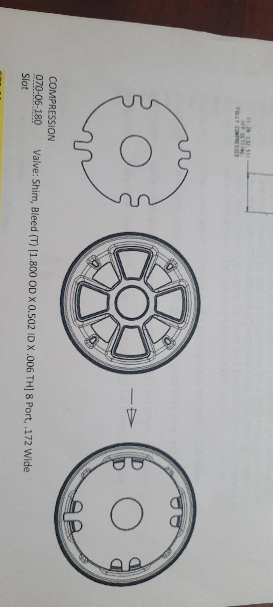

Thanks. They had it installed on the compression stack as they should, they just had the rebound side of the piston facing the compressor stack. Can you share that document? Perhaps in an IM?

Thanks. Can you share that document?
According to Fox, there are no documents, exploded views, or repair manuals...........Nothing they will share with us! This was just a pic the rep send me with some part numbers.
Wtf.......that's one hell of a bleed right there.
