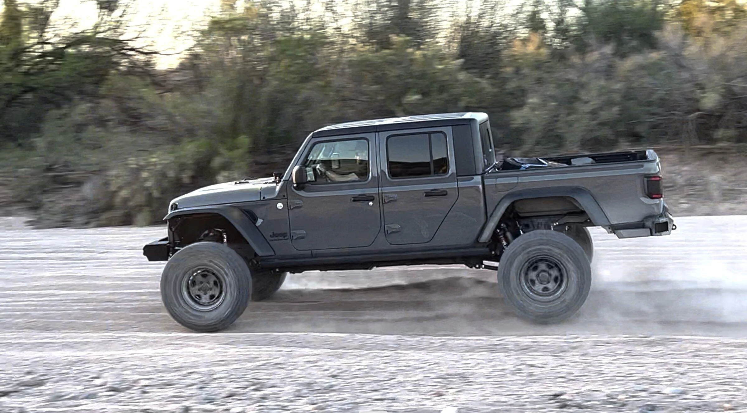

Here is a still shot of the maximum "buck"
Jeep Gladiator Reaching out to those doing their own shock tuning? F287FECD-B50A-450B-BA4F-9467873268CF

Thats moving pretty good! Did you almost swap out from the rear hopping up? Looks like it needs more rebound damping?

I swapped out to the front diesel springs last week. I also added rebound/took out low speed comp in the front shocks knowing I would want those changes at the same time with springs being 10% firmer.
Tried another compression shim stack I've never seen done that I envision will improve that slow speed damping when traveling idle to maybe 15mph aired down while still allowing a compliant ride.
Now thinking I can swap out to the lighter front sway bar link springs to reduce the increased firmness when one tire rises from a bump caused by the firmer springs and get a nicer compliant ride on the dirt/desert terrain.
Tore apart the front air bump that was leaking, but it looks like I need another tool to properly bleed the air from under the IFP. Had a look at the valving while I was in there and have a plan for that too.
Harshness while towing is gone! Drove 100 miles round trip fully loaded with my Husky 701 in the bed while towing the 19' GeoPro over combined pavement and 24 miles of gravel forest road at 34psi. Pretty happy with the rear now.
Tired of working on it, but the drive just keeps getting better!
