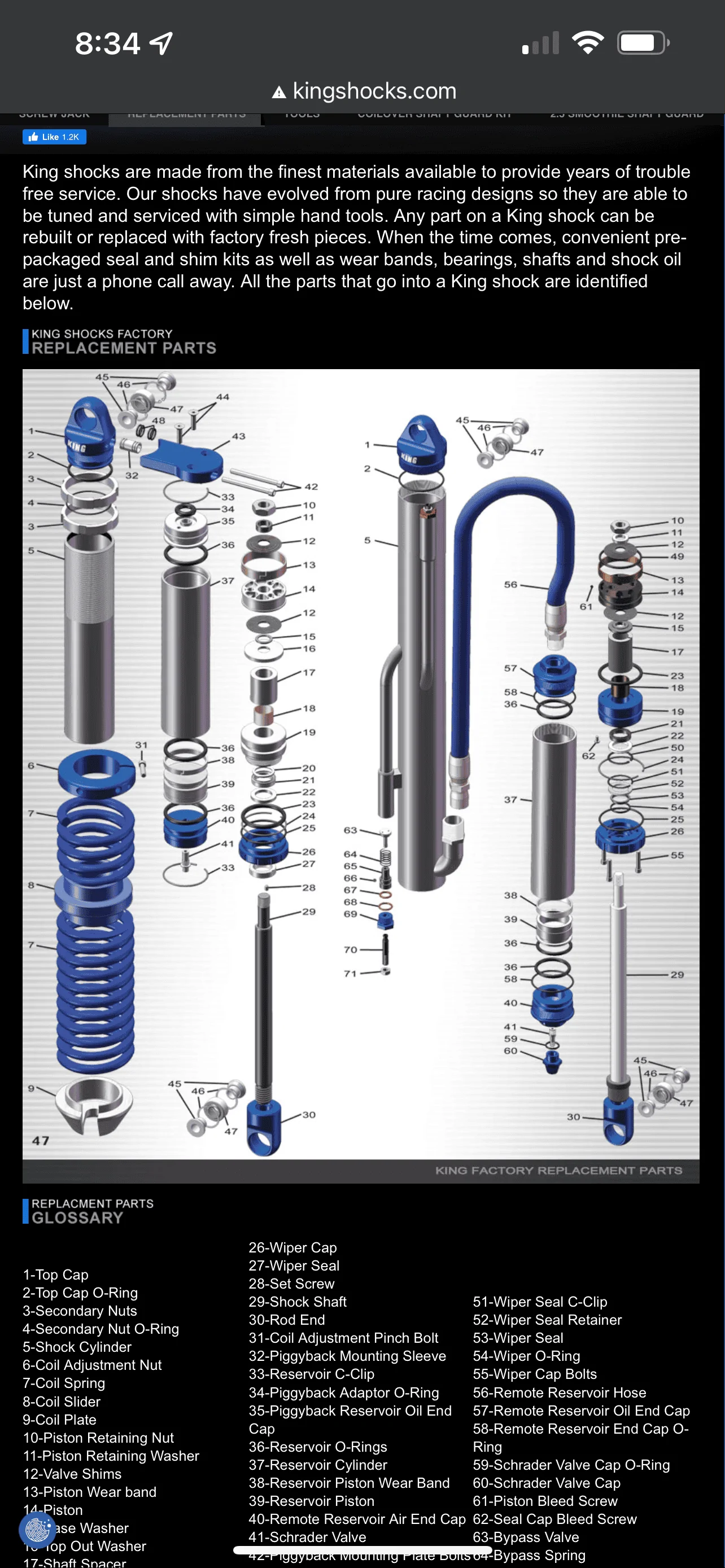

Jeep Gladiator Reaching out to those doing their own shock tuning? 48BB60EC-D97A-4E3F-82F2-00DD4570FD6B
I’m thinking of going this route and selling the Fox. I won’t get the OEM kit though. They cheap out on some of the internals and the shaft ends, and have packaged shim stacks.

I’m starting a new campaign,
“My Shocks, My Choice”

Thst tool looks pretty cool! Hope that does the job for you. Have you tried heat? Maybe a heat gun?
I understand the frustration, but do you think King will be much better? Their stuff was a year out too last time I looked into it?
Lead time is less than ideal with many of the brands. But it’s their unwillingness to help that is getting to me. I’ll reach out to King for a talk. Perhaps I’ll see they are similar. I could look at the Bilstein 8100 external bypass.Externally adjustable rebound would be awesome, as well as the internal bump benefit. As the other person mentioned, there are a few lesser marketed brands making great stuff.
