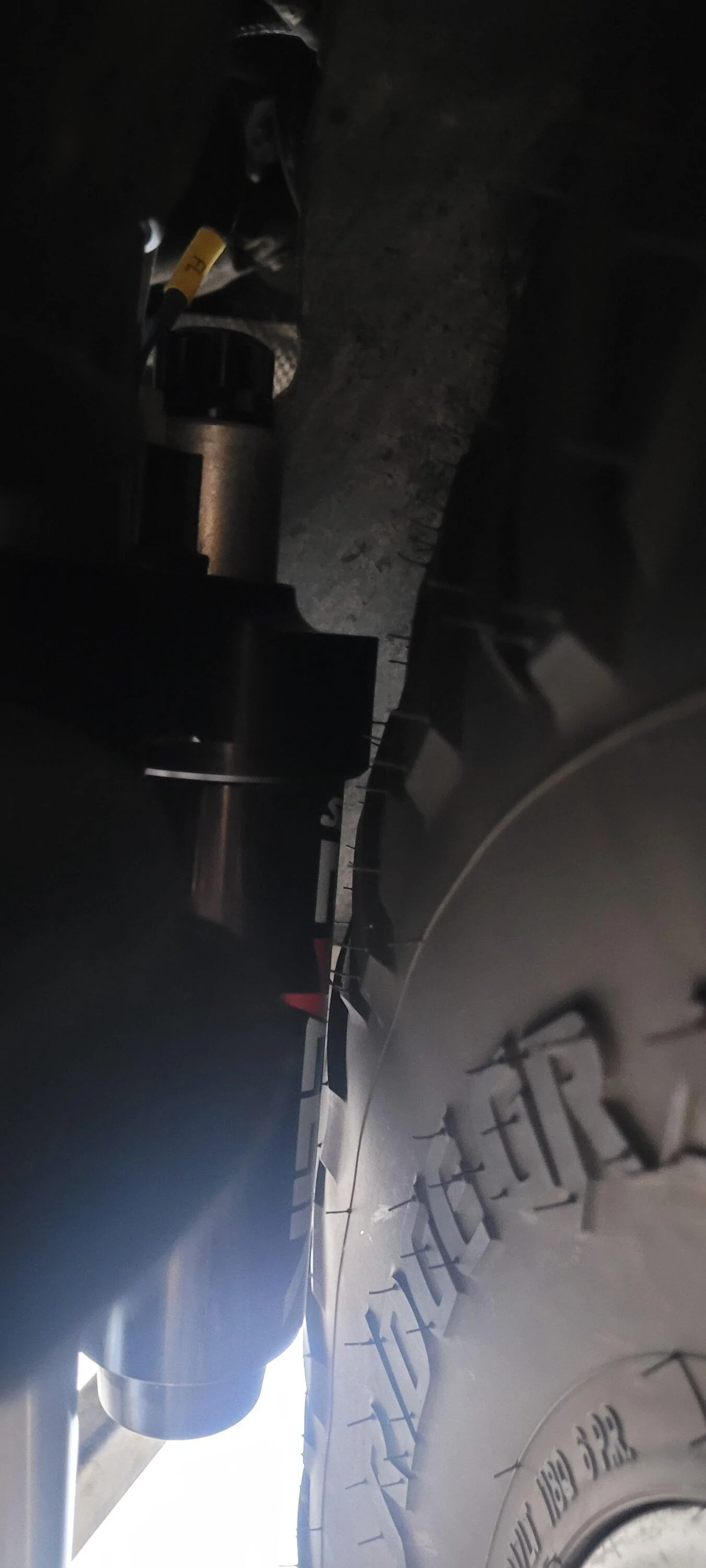

@ajkaz (Didn't want to clog up your thread about the trans leak) and anyone else looking to install the SDI E-Clik shocks........Clearance is at a premium with the piggyback resi's!
This pic is with 17x8.5 Method 313's 4.75BS and 38x12.50 Nitto Ridge Grapplers. SDI recommends 3.25" BS for JT/JL's in the specs, but spec is likely for a narrow axle "Non Rubi, Mojave, or Max Tow". She is tight and I might have to adjust steering stops and give up a couple of degrees of turning radius. The left coil just kisses the frame rail, so I may also shorten the track bar 1/8-3/16" and will allow that much more clearance.
I'll be installing another set of E-Cliks for a client with Method 703's with 5.75BS on 35x12.50 Ridge Grapplers. Not sure if the shorter tire will allow more clearance moving the bulge closer to the centerline or if I will have to back out his steering stops as well.

This is good info thanks! I am currently running Kenda Klever 35 x 10.5's on the factory 17's. I get rubbing on the reservoir on both sides at full lock. Added 1/4" to the steering stops on both sides and it barely kisses now, just enough to ruin the stickers.
I am going to run a 1.75" wheel spacer up front and likely add the metal cloak outboard lower shock mounts. Hoping to find a sweet spot between getting that turning radius back and moving the shock body out a little without hitting. Its great running the narrow tires, the clearance is awesome and the on road ride is fantastic.
What is the stock wheel width and BS? 17x8 5.75?

17x7.5, 6.25" BS on Rubicon wheels, if my notes are correct. Don't know if there are variations between different trim wheel BS though...
Ya, that's going to be a clearance issue with the SDI's. That 10.50 wide tire @ajkaz has helping though.
It’s not much, but Mojave wheels would give 1/4” more clearance than Rubicon wheels.

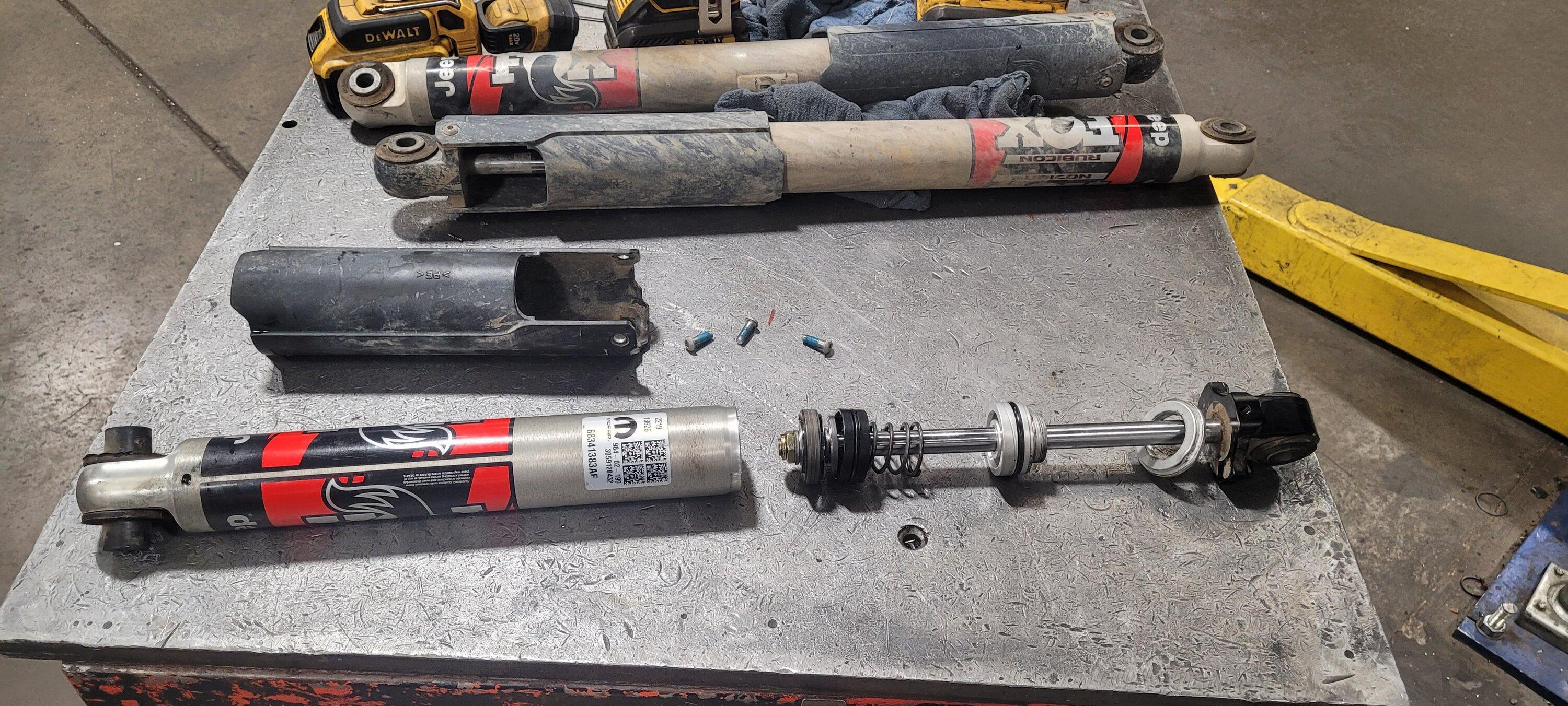

I'm just going to leave this pic here and let some ponder on the possibilities for those who don't want a lift kit........Hmmmmm

You are one step ahead, i was thinking about pulling mine apart since they have little value on the resale side and see what makes them tick.
That looks like a blank canvas full of possibilities.
Is that black dot up at the head above the silver strip the nitrogen fill hole? That was the biggest worry i had was how to get nitrogen back into them.
Did you measure the amount of oil that came out?
