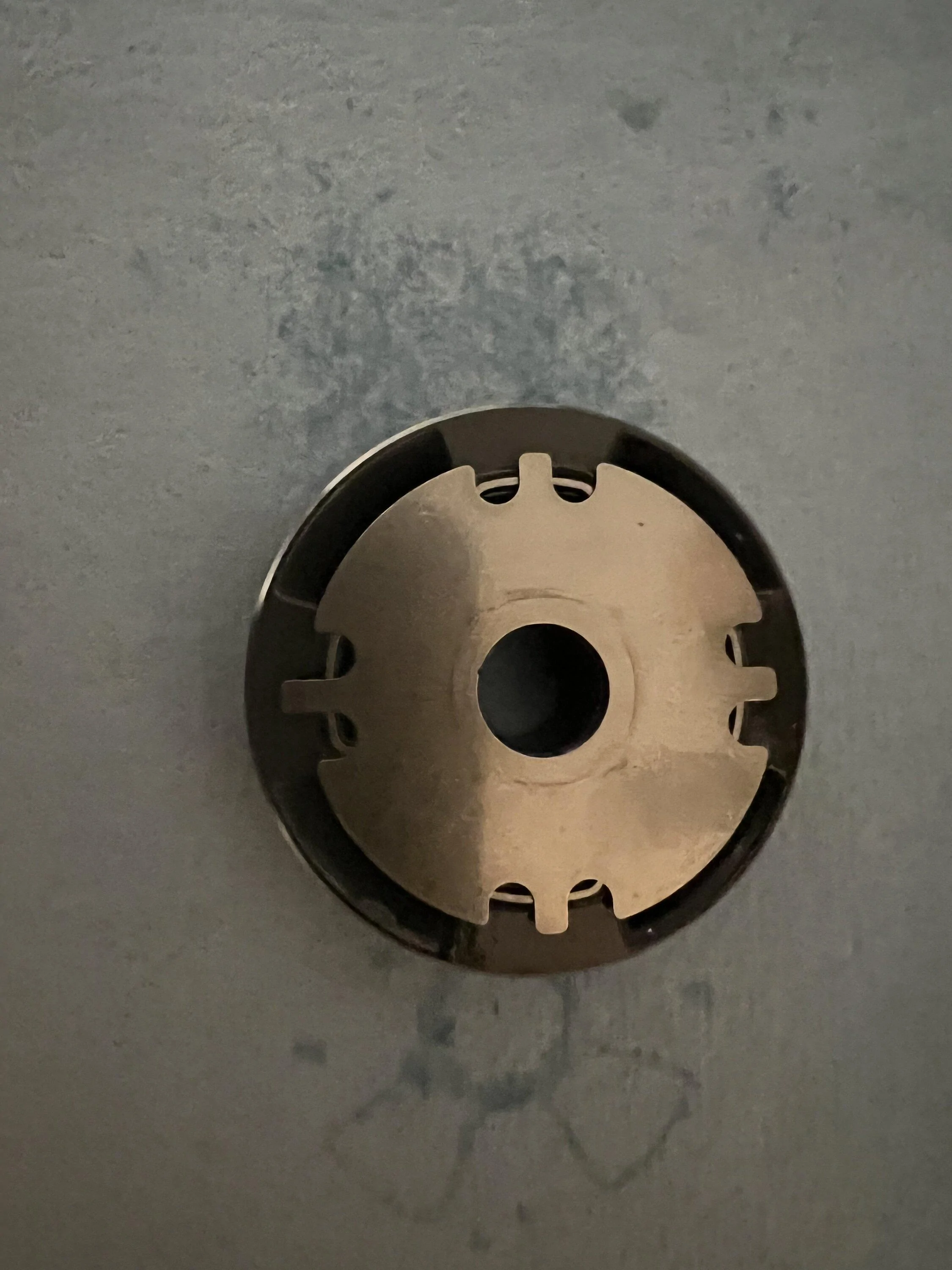

Good news I have bleed shims. But with the 1.6” diameter ports facing the 1.8” diameter bleed shim, it wasn’t doing anything.
That's an 8 port bleed shim though....probably the OEM one. I went with a 4 port to tighten up things on the road manner end of it.
Yes, how that was installed, you had an effectively small rebound bleed, and a massive compression bleed with the 1.6" shim over the 1.8" ports.

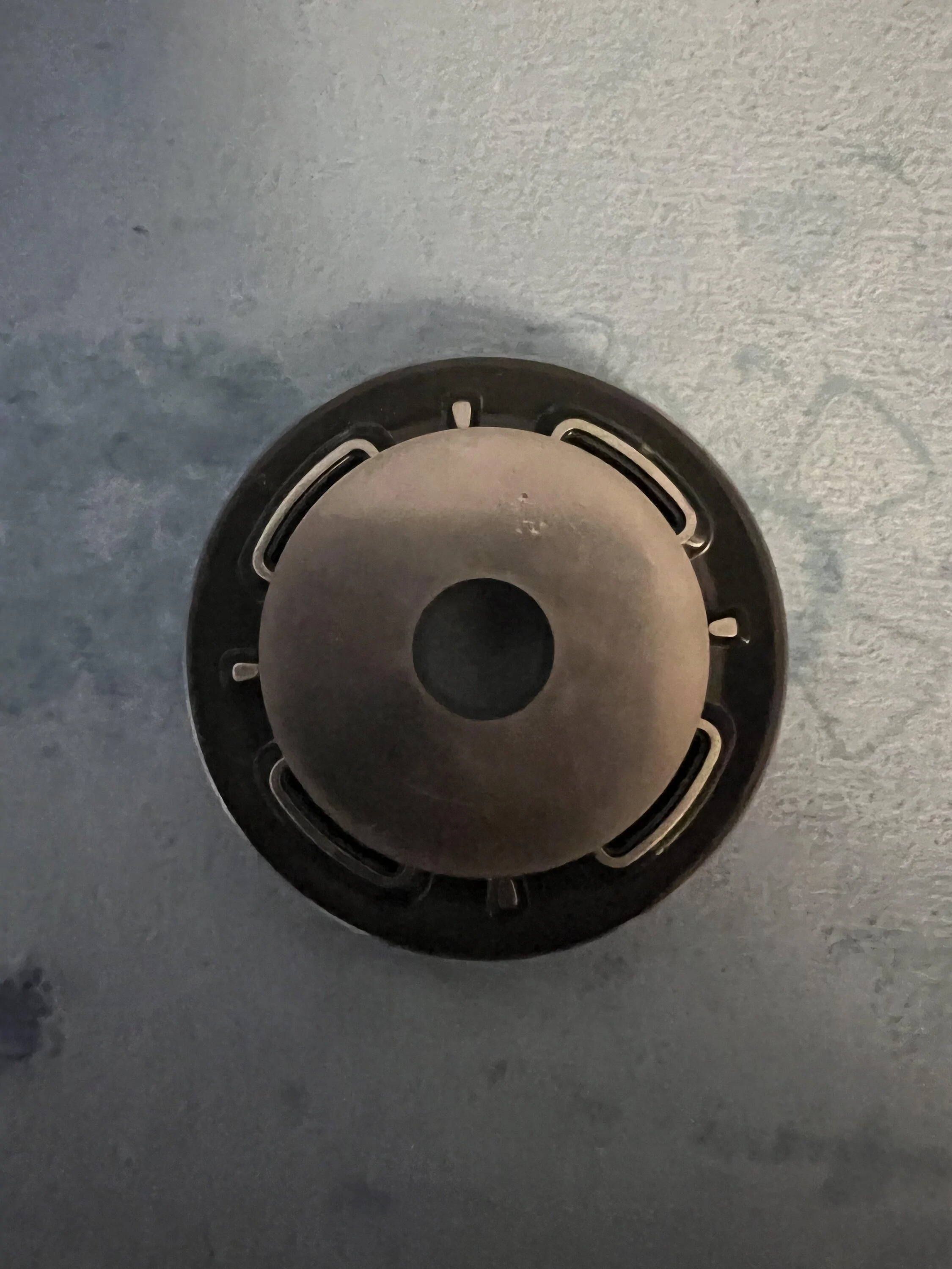

I actually had zero rebound damping at all. This is the 1.6” rebound shim on the 1.8” port facing the rebound stack. So it was open flood gates on rebound.
Ya, not much restriction going on there!
Easy mistake to make, but you wouldn't think someone with experience would make it? Could have been sick or otherwise distracted that day.Was this on both shocks or just one? Seems like that would create all kinds of weird chassis movements.
