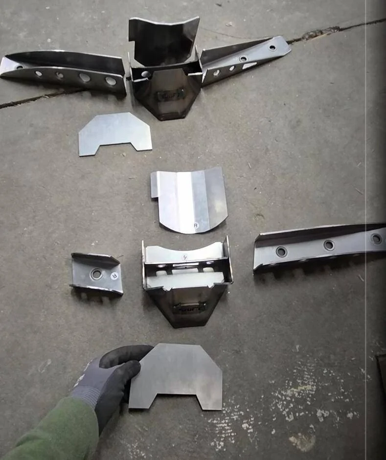

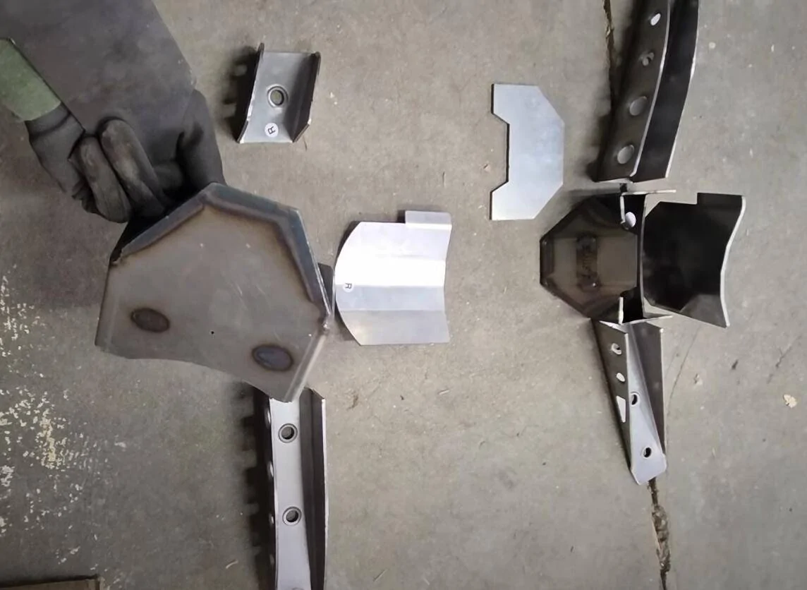

Got my Shift Autowerx frame truss in hand. Comes in pieces to weld in place. It also comes with bump stops as an FYI. The holes are not drilled for them though in the bottom of the bump bracket. Going to take a minute until I can get them installed but I'll keep this thread updated.
