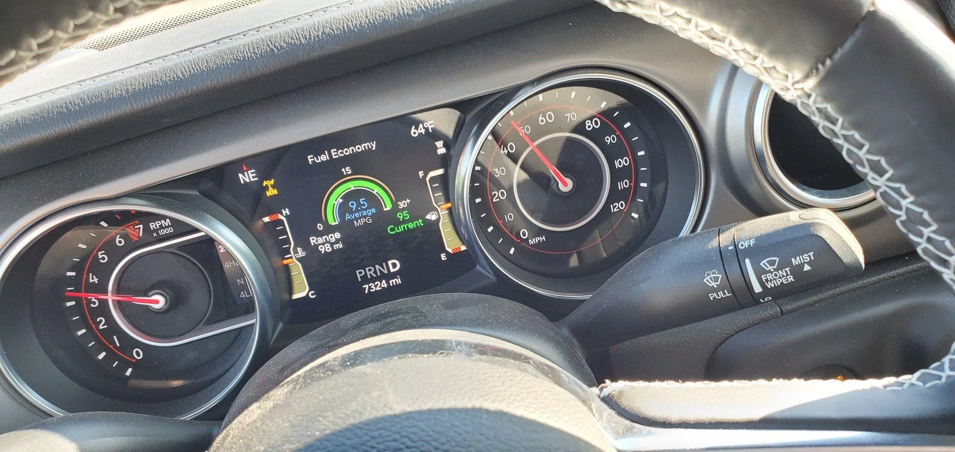

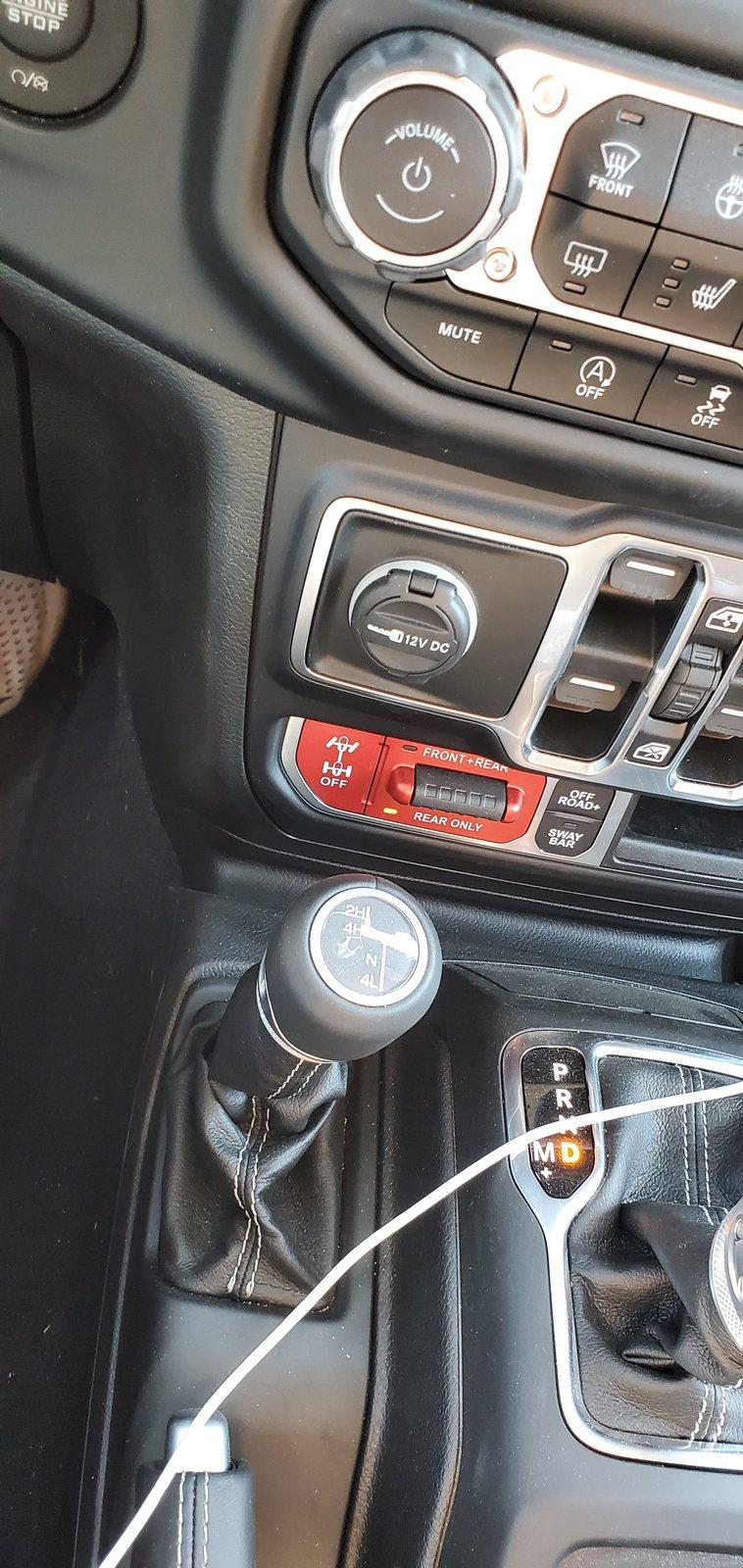

just went to the dealer in Wichita Kansas and they had not seen it happen to the JT yet. But they too said it was a whole rear axel swap because they could not get the part. I now have to live with it until mid November before they can get one delivered as hey are backorder. I am also having the steering mod done by them but they are only allowed to order one every 14 days and will not do the mod unless you say you are having a wandering or drifting issue.
