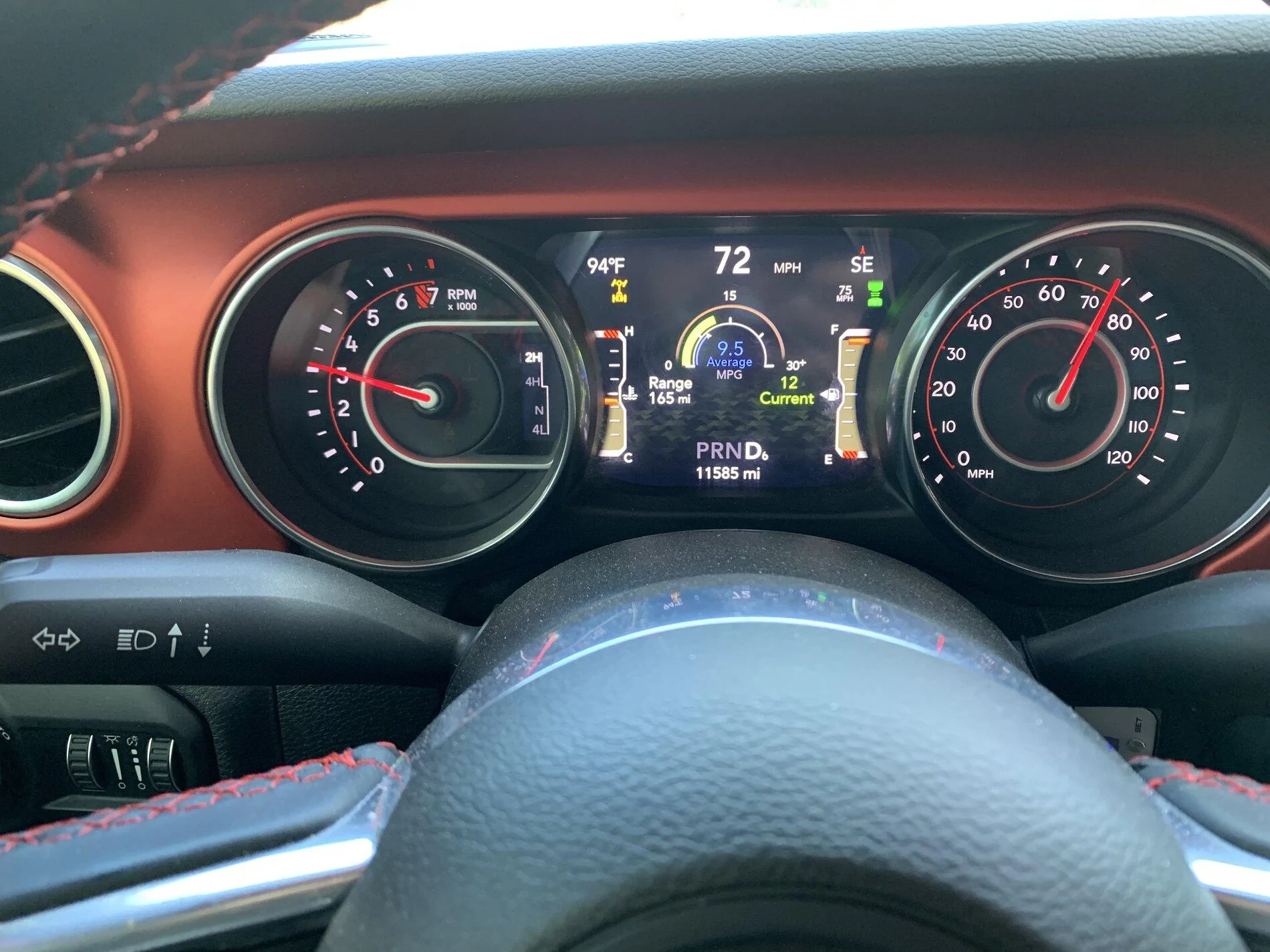

Jeep Gladiator Rear locker engaging automatically in 2H 20201128_194118
Mickey1961
Oct 16, 2020
Kansas city
2020 jeep Gladiator
Sales
Well it's been happening for two months took it into jeep dealership and the light would go off and not engage and they wouldn't fix it even I showed them videos of it happening
well this time it stayed on and they told me that it's a actuator and its back ordered and told me if they cant get the part they are going to change the rear differential

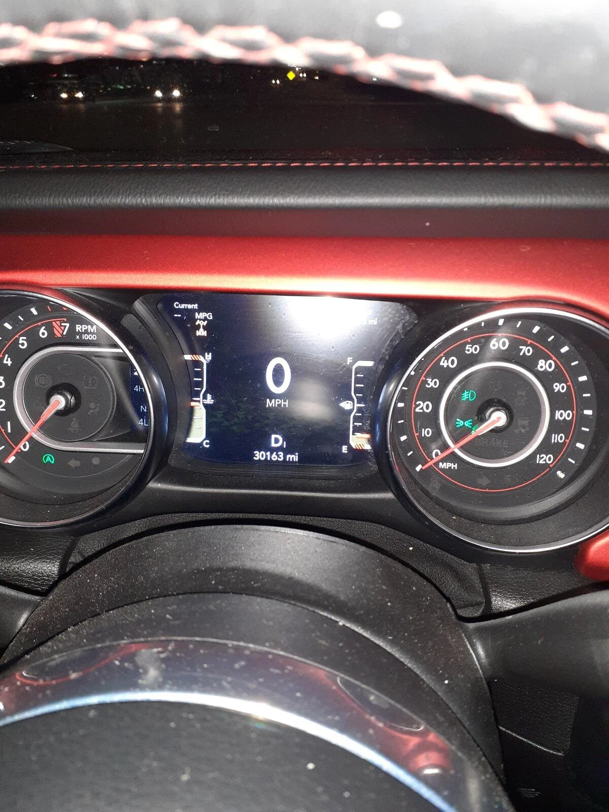

Anyone have issues with rear locker engaging in 2H?
Came on while driving, turned off and now flashing. Can’t get it to stop engaging every few times I drive, or at least it thinks it’s engaged. No tazer, no suspension or drivetrain mods.
Have appointment on Monday to get it looked at.
I haven’t ever even used 4L yet, just had first oil change and they did a software recall while in (assuming not related to causing this issue but this issue happened next day). Assuming bad sensor or actuator, anyone else have this issue yet? 3900 miles.

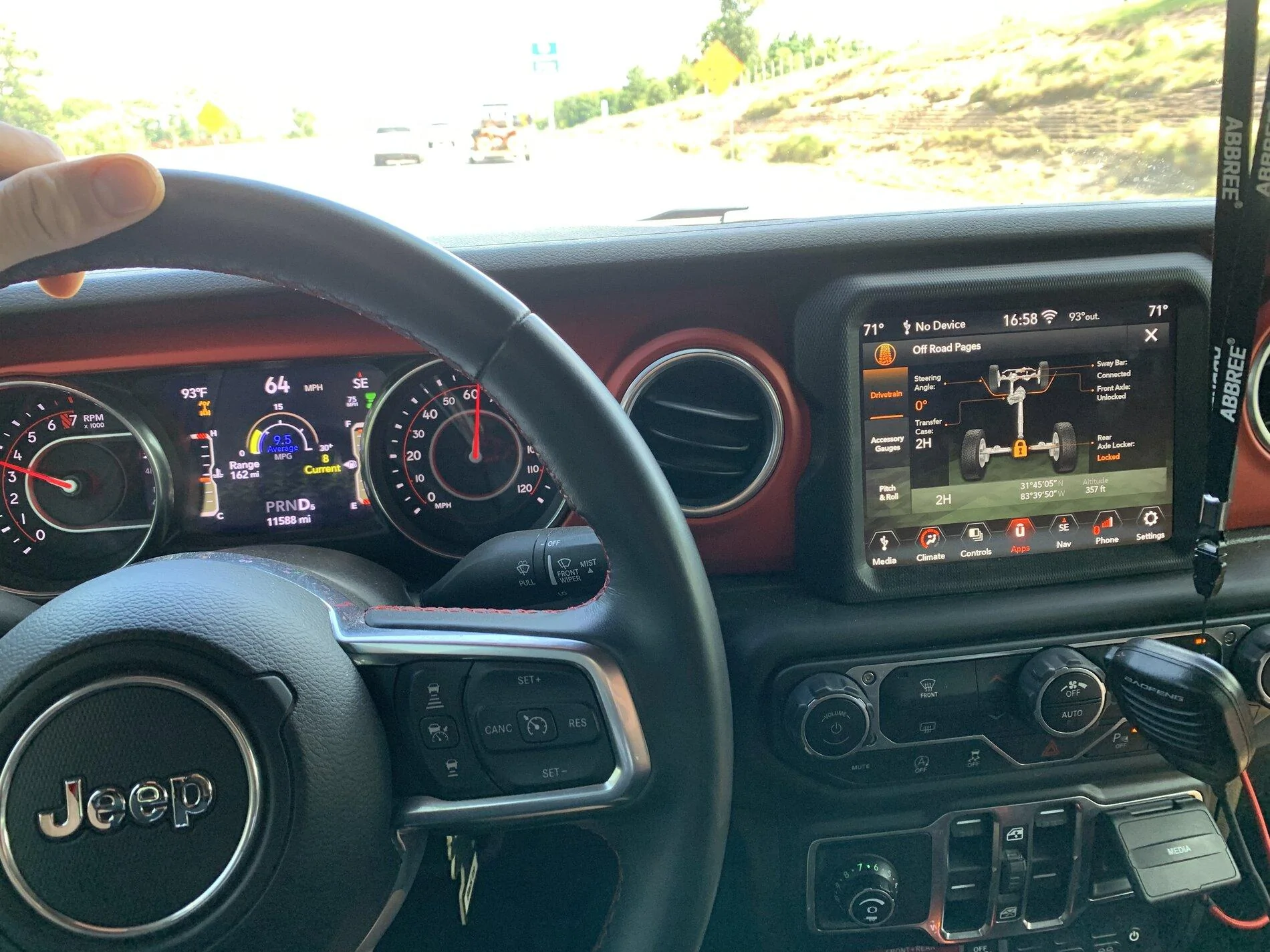

I just experienced this starting this past Friday 7/16/21 while towing a 6x12 TA trailer loaded with 4 dirt bikes from Georgia back to Florida. The instrument panel showed my rear locker being locked and I checked the Off-Road pages too and it showed it was locked. I tried to unlock the rear lockers but no change. I did the turn test and it does not appear that the rear is actually locked. I kept cruising back on I-75 at 70 mph with no issues. I took pics and video to show my dealer. I was just there for a service last week and they updated the firmware on the powertrain control module (pcm) to the latest level 18-19-06-DB 0.3 68433756ai-ak. I am thinking it has something to do with that Since I have been towing my trailer or off roading with no issues prior to the update.
