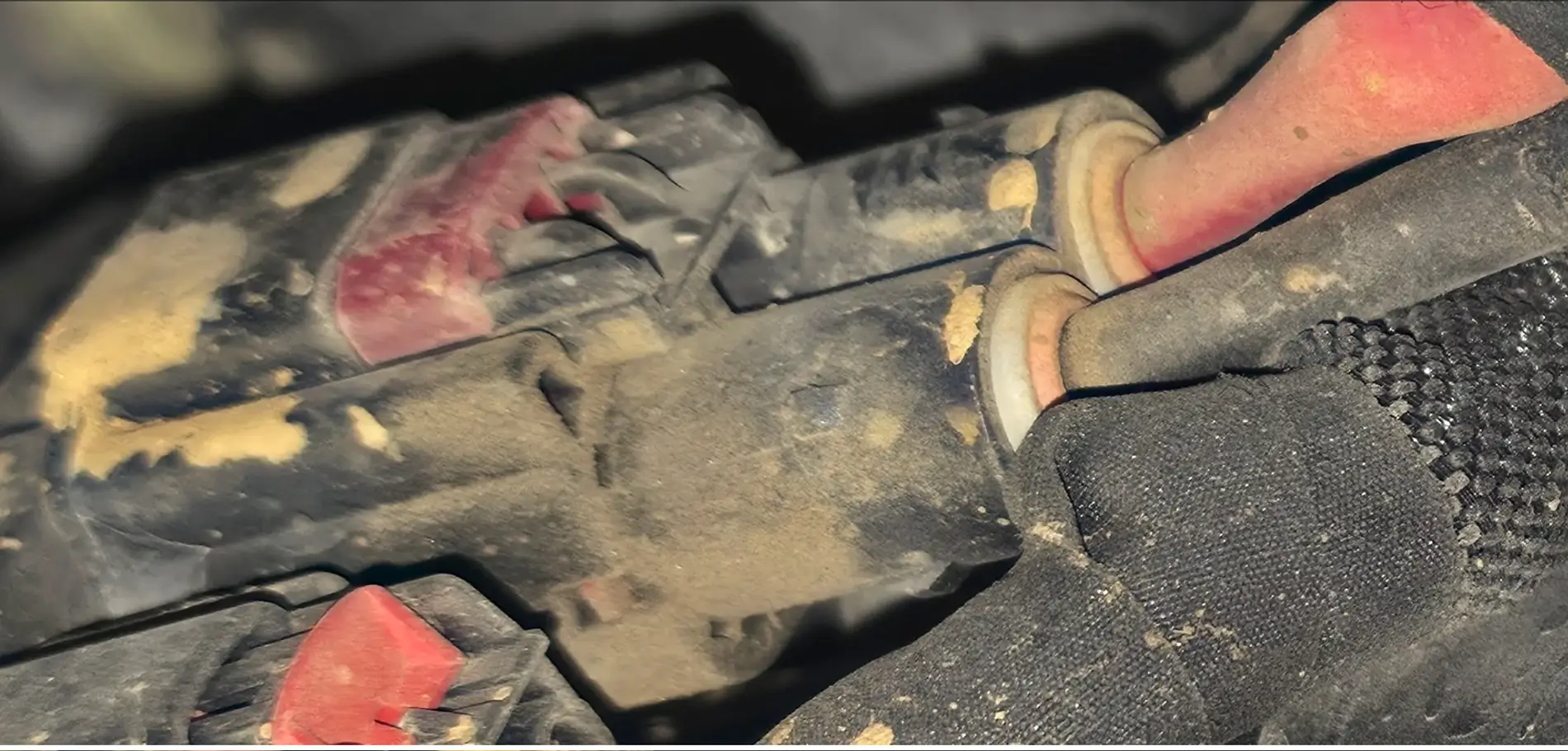

The locking tab on mine has a gap, but the wires seem fine.

It's kind of amusing because I took that pic camping. We went with family friends and their 17 year old son told me about the recall at the campfire at night.
My truck was parked under gigantic trees and I'm like oh this would be perfect timing for me to light the entire Forest on fire because of my fucking Jeep LOL
I was upset at first, but I think if it was gonna catch fire it would have by now after 5 years of constant wheeling. Who knows.
